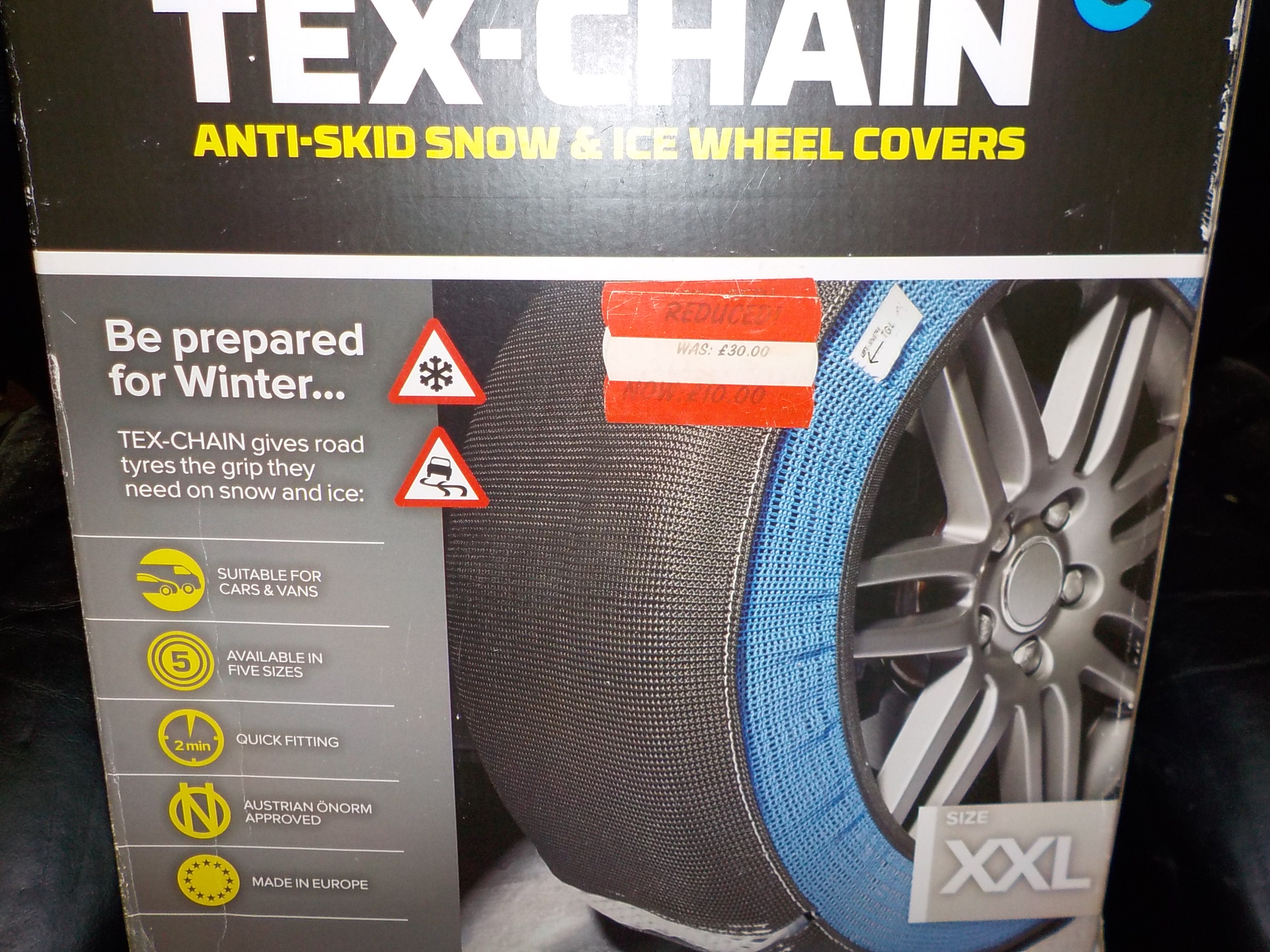

& I carry them but if helping people stuck with unsuitable tyres, i also have Snow Socks to fit on their drive wheels to get them moving onto black top if roads are treated and cleared.

I bought a few sets of these when being cleared in ASDA for a tenner.

Thanks for info, maybe I'll keep an eye out for the snow socks just for extreme conditions.
