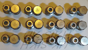

I've done the unthinkable and lost my locking wheel nut key. And yes you guessed, I wasn't aware to record the code on it.
I was wondering if anyone here knew the code for the locking  pattern on the attached image?

IME there's no identifying code on the key either. You'll need to get hold of a master set at a dealership and match it from that.
Ah just spotted a single letter on mine - just presumed that couldn't be the code. Obviously not more that 26 combinations then.  My wifes Punto alloy wheel nut key has  an eight digit number.
Edited by Headinawayoffski
Gareth, that looks a lot like "P" or item code 773
Don't order it based on my supposition though.
there is a P for sale here
http://www.ebay.co.uk/itm/GENUINE-SKODA-LOCKING-WHEEL-BOLT-NUT-KEY-P-773-5J0698139773-/331752716515?fits=Car+Make%3ASkoda&epid=1243615521&hash=item4d3e00b8e3:g:tkEAAOSw-K9ZHvno
The keys are stamped with a single letter and that relates to a three digit code which forms the end of the VAG code
in this case (p) 5J0 698 139 773
have a look through the whole internet and you should find a picture of one that matches yours exactly.
