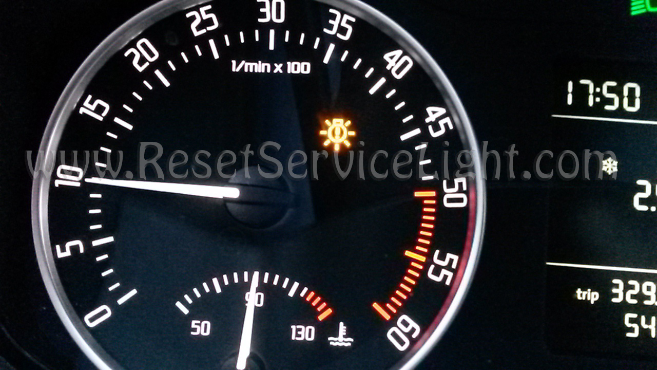

IS THAT A YELLOW DSG OVERHEATING WARNING LIGHT ON, 'Gear COGS' ?? Or just a Bulb Out warning light?

OK,
only the Bulb Warning light..
