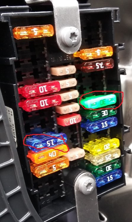

Anyone know the fuse location for the cabin 12v cigarette lighter thingy?
right hand side of dash
open the door, pop off the cover (insert key on lower edge - look and see a little slot)
then check the green circle fuse (right hand one)

          Did mine a few days ago. It is fuse number 30. But it is a 20amp fuse. Studied it a bit online as I didnt know where fuse box was as i only have Yeti for a few weeks.
