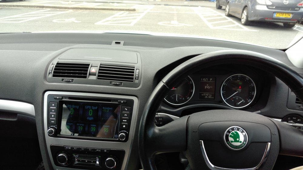

You could plug into the OBD port and see what's reported. I was playing with Torque and came up with this screen.

Was playing with the torque app and obd reader so made me curious why my readings were so different it's also my first turbo car so will be tweaking it and then maybe a remap just wanna keep an eye on everything. The car feels strong was expecting continual boost readings through all gears
The torque app has somewhere to put in atmospheric pressure (1013mbar at sea level).  If you haven't already.  Any reporting, should then show a net boost figure without atmospheric pressure included.  I have used the boost reads in Torque in my vRS TSI on a few occasions.  The boost should be consistent in all gears at a consistent RPM and throttle / engine load.  From memory peaks of 11 or 12 psi and sustained 8 or 9 psi.   Admittedly, mine is a TSI with a different engine, turbo, map but it won't be that far off what I would expect yours should show.
