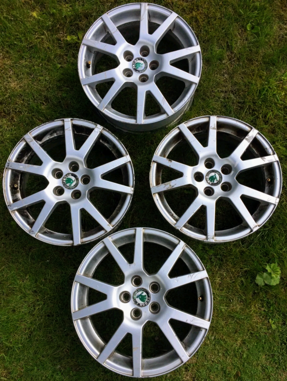

Forgot to mention wheels....
The standard alloys are well past their sell by date, none of them hold air, I've now got 6 standard Spider alloys after buying another 2 to save money on a refurb. Only 2 of them hold pressure. So I've been adding air every couple of weeks, which is such a bind. I'll be selling them all shortly!
I'd love a set of BBS split rims which in my opinion work so well on a multitude of cars... But I've been down that road twice before with my Mk2 Golfs, they look the business yeah, but they cost a bomb and they are a nightmare to maintain especially polished ones :D
So with that in mind and my rapidly dwindling budget I set out to find something from the Skoda range but still 16" so after missing out on a couple of sets on here I managed to scoop a set of Octavia Spiders on eBay for £67, they must have somehow gone under the radar. They where a bit rough around the edges, but they are currently at Ashton Powder Coatings being refurbished in Black Chrome, then they'll be fitted with a set of Goodyear Asymmetric 2 tyres which I dropped off at the same time...
How did you get a set of 16 spiders for £67!! can’t  find any :(
2 sets went up I  the same week on here recently, one of which was only a 20 minute drive away for me, I missed out on both.... the set I bought came up on ebay, I had to travel to North Wales for them so probably about £15 in fuel and an early start on a Sunday morning to beat the traffic, but worth it as they looked far worse in the picture than they actually where :o

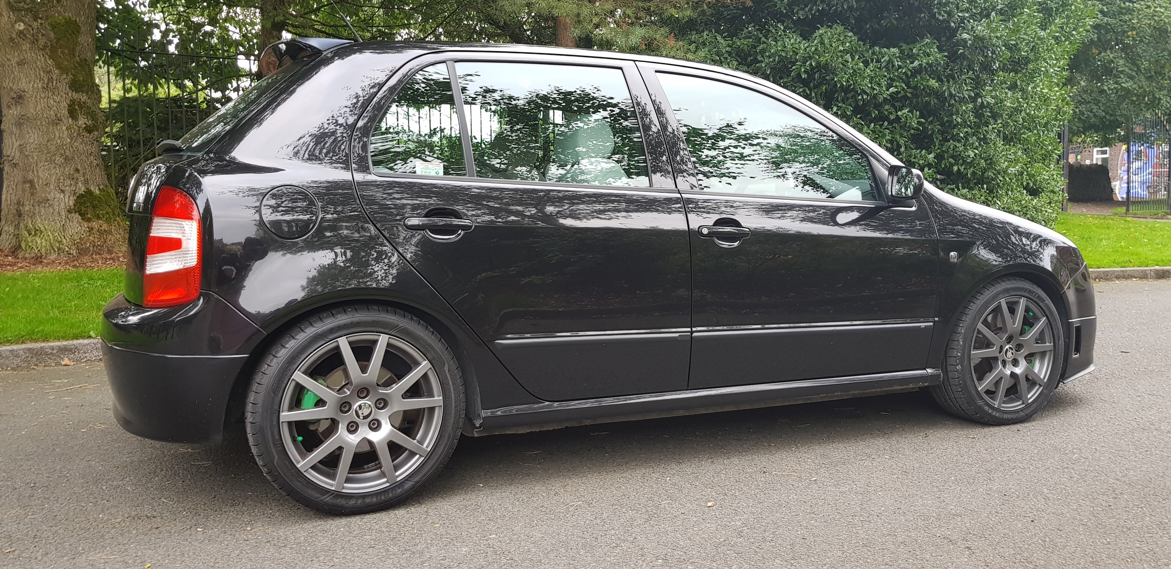

A massive career change has put paid to any big plans I'd had for the Fabia. But I've kept the car and used it daily and I'm happy to say it still hasn't missed a beat!
Fitted the Cupra splitter and ripped it off a few months later on a low kerb, then re-fitted it. It's a little grazed on the near side, so I'm contemplating ditching it.
had toyed with the idea of selling the Spiders, so didn't fit them until today :D
I gave the car a damn good clean and polish as I'd neglected that department, it came up good, so that spurred me on to fit the alloys.
I've also wound the coilovers down more, they are at their lowest at the rear now, I don't like the idea of removing the rear adjusters to go lower so that is it as far as ride height goes.
I've seen a fellow members car running wide steels and they look fantastic. So after fitting the Spiders I dropped the steelies off at my pals for the tyres and weights to be stripped off. I'm going to get them banded by a local firm originally named 'Banded Steels' I'm thinking nothing crazy as I don't like aggressive poke, so 7.5J front and 8J at the rear will look nice.

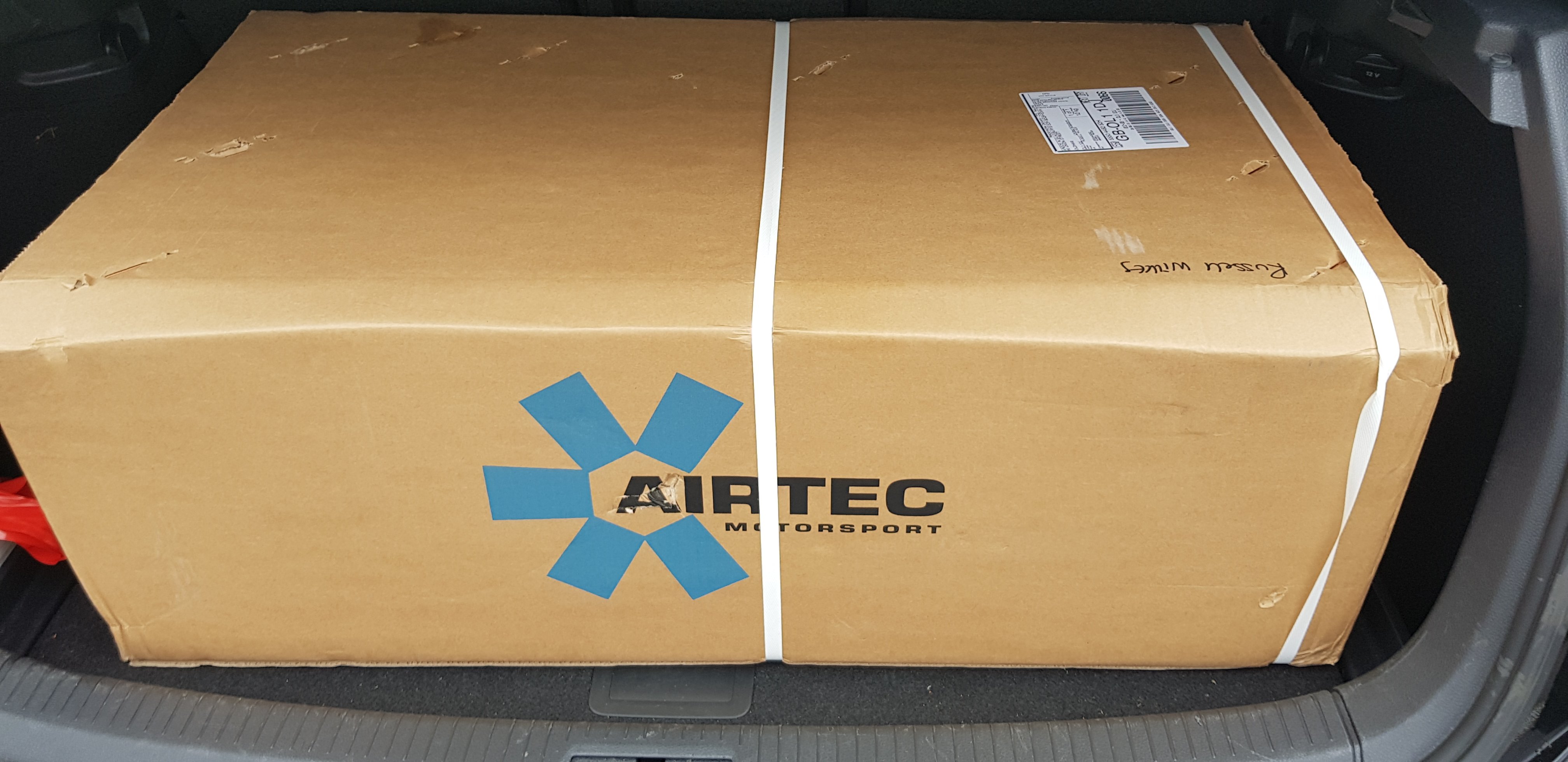

Had the car on the ramp at the garage as I noticed a leak. Turns out the intercooler is on the way out, so I've bitten the bullet and ordered a Airtec Seat Sport style FMIC and pipework as well as a egr delete kit, so they are going on as soon as they arrive. Then I will need to find somewhere to have it mapped (recommendations welcome).
That's where I'm up to as of today, I'll update again when the Airtec is going on.

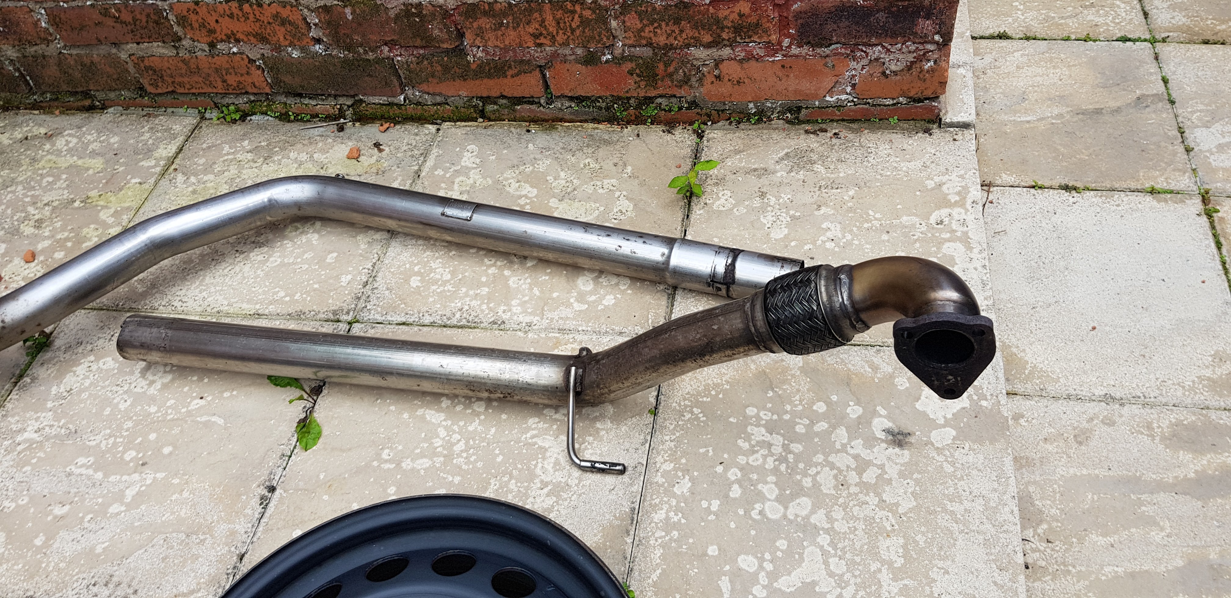

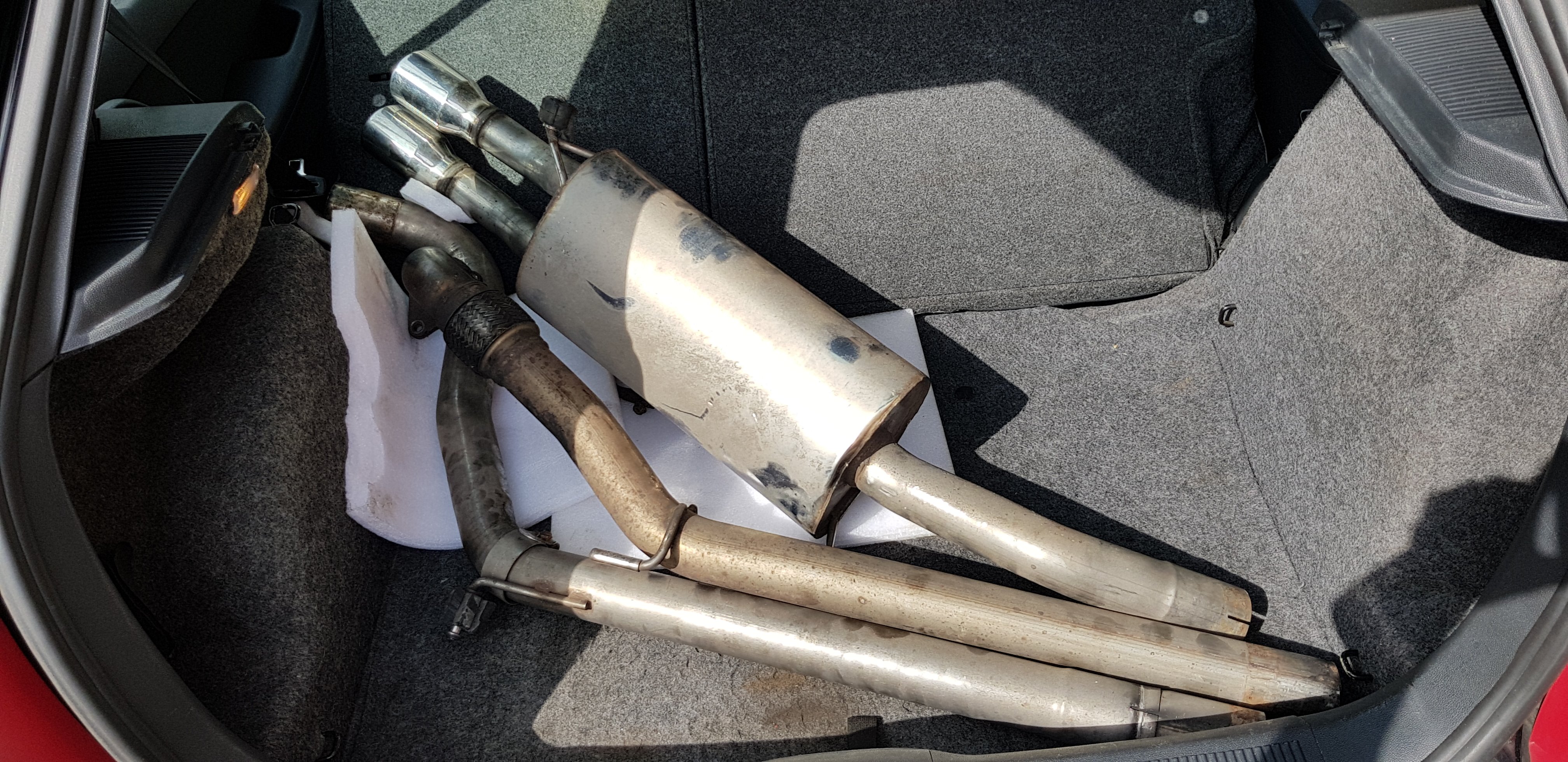

Few more bits arrived and a breakers local to me have a Fabia in which has a full Miltek exhaust system, so I'm going to collect that tomorrow, love a bargain :clap:
Miltek exhaust system collected, very happy as I was looking to pay just shy of £200 for a manifold alone, paid £250 for the lot, I love a bargain.

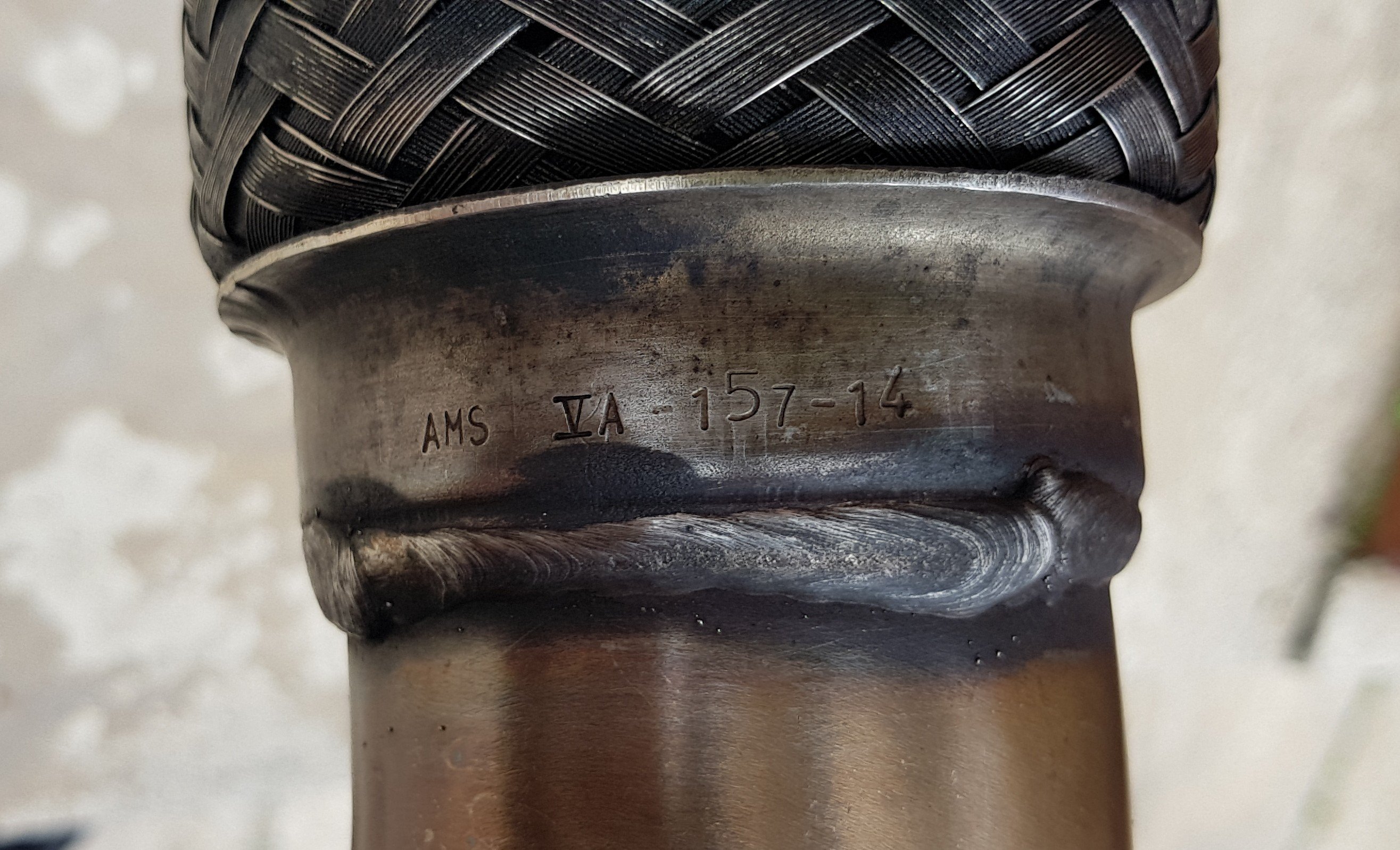

Turns out I have bought a Piper decat downpipe and a Miltek system, I was scratching my head wondering where the Miltek stamp was on the downpipe, then it was pointed out to me that it looks different to the Miltek offering.  Emailed Piper and they confirmed it, I'm happy with it none the less.
Got home from the 40 odd mile round trip to collect the exhaust to see the same firm had listed a Cupra Tdi for breaking, so I went back for the strut brace. A productive couple of days. Not bad fuel economy, I pottered on the M62 around 70mph with the odd overtaking manoeuvre :biggrin:

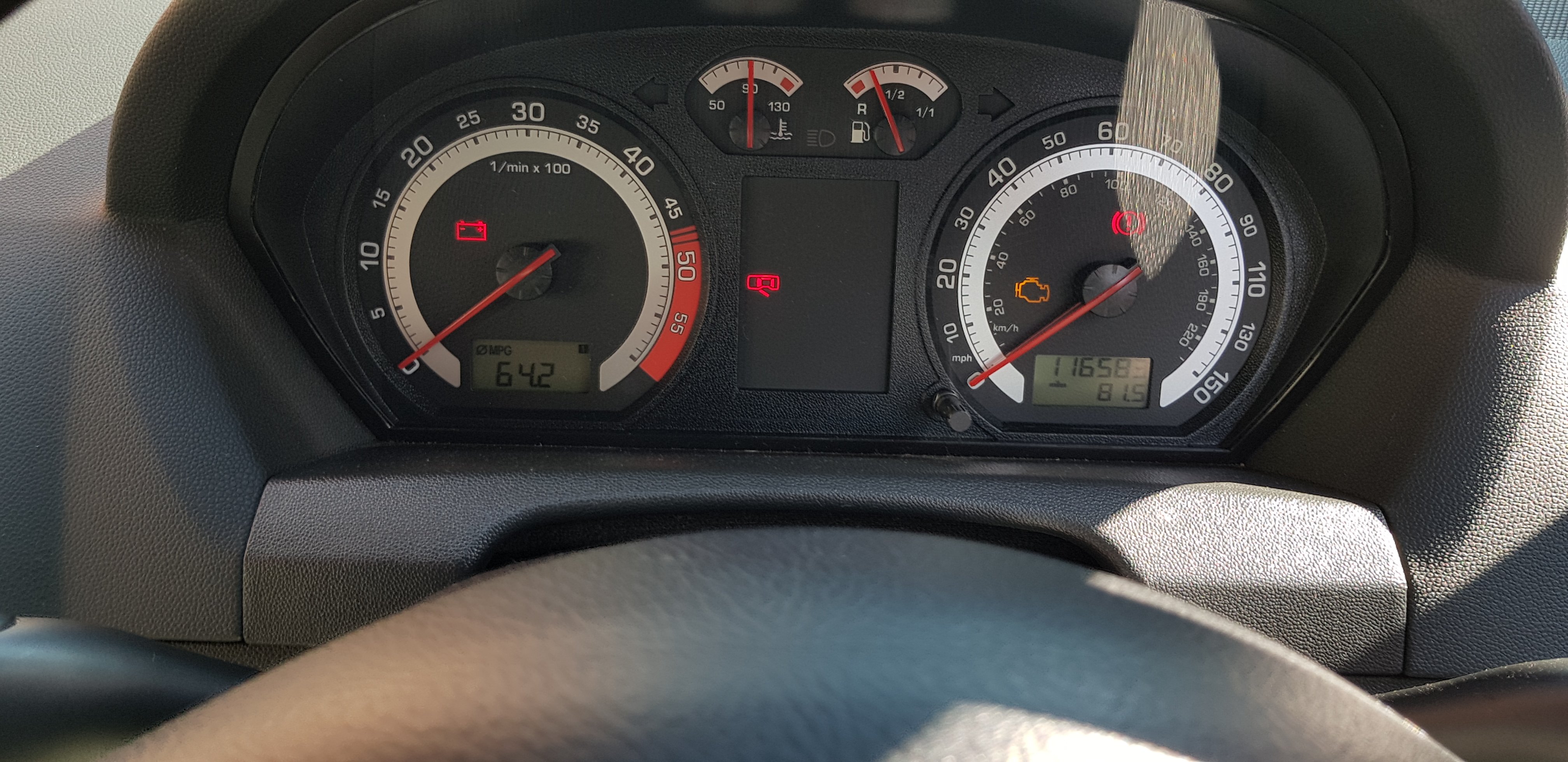

With yours being a BLT engine I’d not believe the dashboard mpg figure, both of my BLT cars massively over read on the dash. True figures on my black one are between 53 and 56mpg (calculated the right way) where the dash regularly shows 70+mpg
Good work on buying some mods though, it’ll come together nicely
What is the correct way to calculate mpg?.. it was good while it lasted :notme:
Bought a GTB2056vk, PD150 head bolts amongst other things which I hadn't planned on, but things keep coming up at good prices :o
Fill the tank, either by letting the filling station pump click a few times or use the "vent" mod to squeeze an extra 12 litres in and fill it to the brim of the neck. Reset the trip meter, drive the car till it gets low enough to refill, refill the exact same way as before, the work out how much fuel you've used exactly to cover the miles showing on the trip. That will give you the exact MPG, which will be quite different to the trip computer display.
