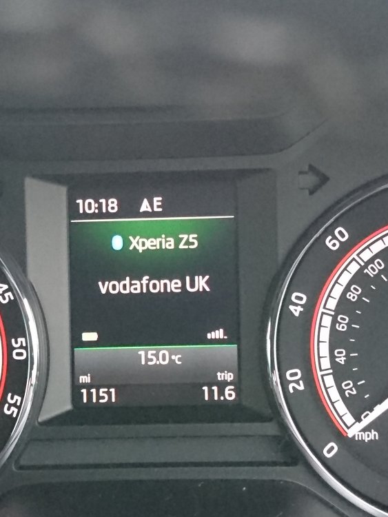

No idea what maxi dot is tbh. I presumed it was the display in the instrument cluster, but the menus there are even less detailed than using the head unit.
It is that but it sounds like you dont have it. If there is a picture of the car on the screen when you open a door, you do. Given you probably dont have it, its unlikely the module is a premium one and so its probably not the rsap issue. I am a little out of ideas, maybe the particular phone is the issue.
There is a car / open door warning graphic on it, so maybe it is. It's in colour too. Is there a definitive way of establishing it?
Sounds like you have it. There should be a phone menu in it at the top level alongside audio and MFD etc?

Not sure I do, there are no sub menus, just scrolling through numbers.
I'm not familiar with the mk3 maxidot but if its like my wifes audi A3 I think you might need to 'go back' a step using the steering control?
That does nothing more than take me back to the top menu, there are no phone choice features from what I can see. Must be the phone, I guess I'll have to live with it, risking being prosecuted for touching my phone screen in its cradle, whereas pressing the satnav screen is fine....
