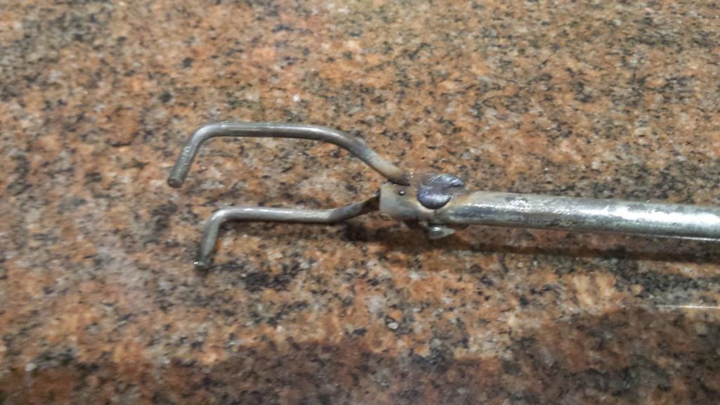

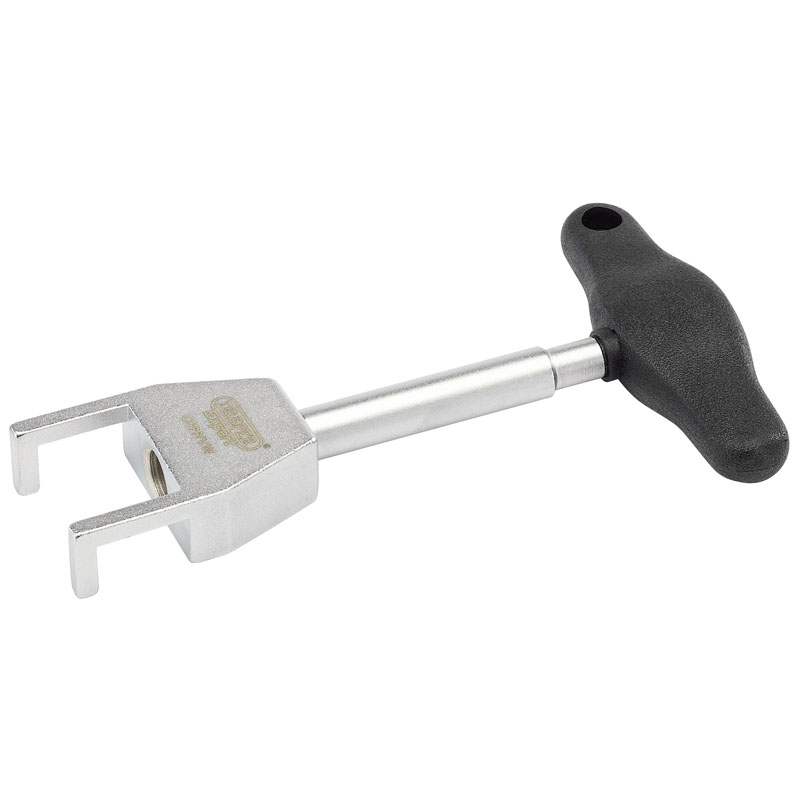

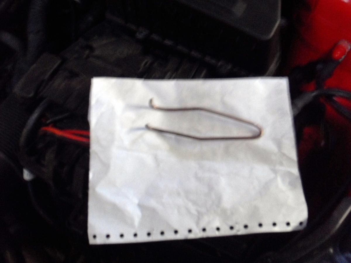

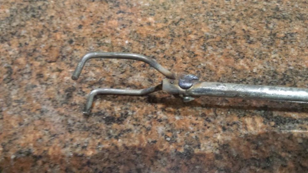

you need to remove the ignition coils with a coil removing tool, or a home made one, so they need unplugged. BE CAREFUL.
(Some use Zip Ties, or lever with a long driver and block of wood.)

Thank you so much that just what i wanted, i bought a coil removal tool off eBay for £10,  i'm going to have a crack on Friday its been a while as i've been running diesels for the past 7 years.
