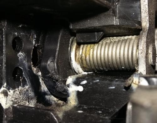

Interestingly the microswitch is working fine. There is wear on the plastic cam connected to the latch mechanism and a little on the microswitch plunger. Result, it no longer gets pushed enough to break the circuit. A new lock was the only solution. A new microswitch would have been a very temporary solution.
The worn bit is at about 9 o'clock. The two round holes at 8 and 10 are the holes for the locating dowels on the microswitch.

Yes the plastic on the cam can be shot. It's just plastic covering metal. I removed the plastic on mine as it was shredded. However, I wasn't using a standard microswitch as a replacement. Might not have worked with a standard one due to the extra gap caused by removing the plastic. I lubricate it regulalry which I think is why it's worked so long so far. If I was doing it again I'd just buy a new lock mechanism.
