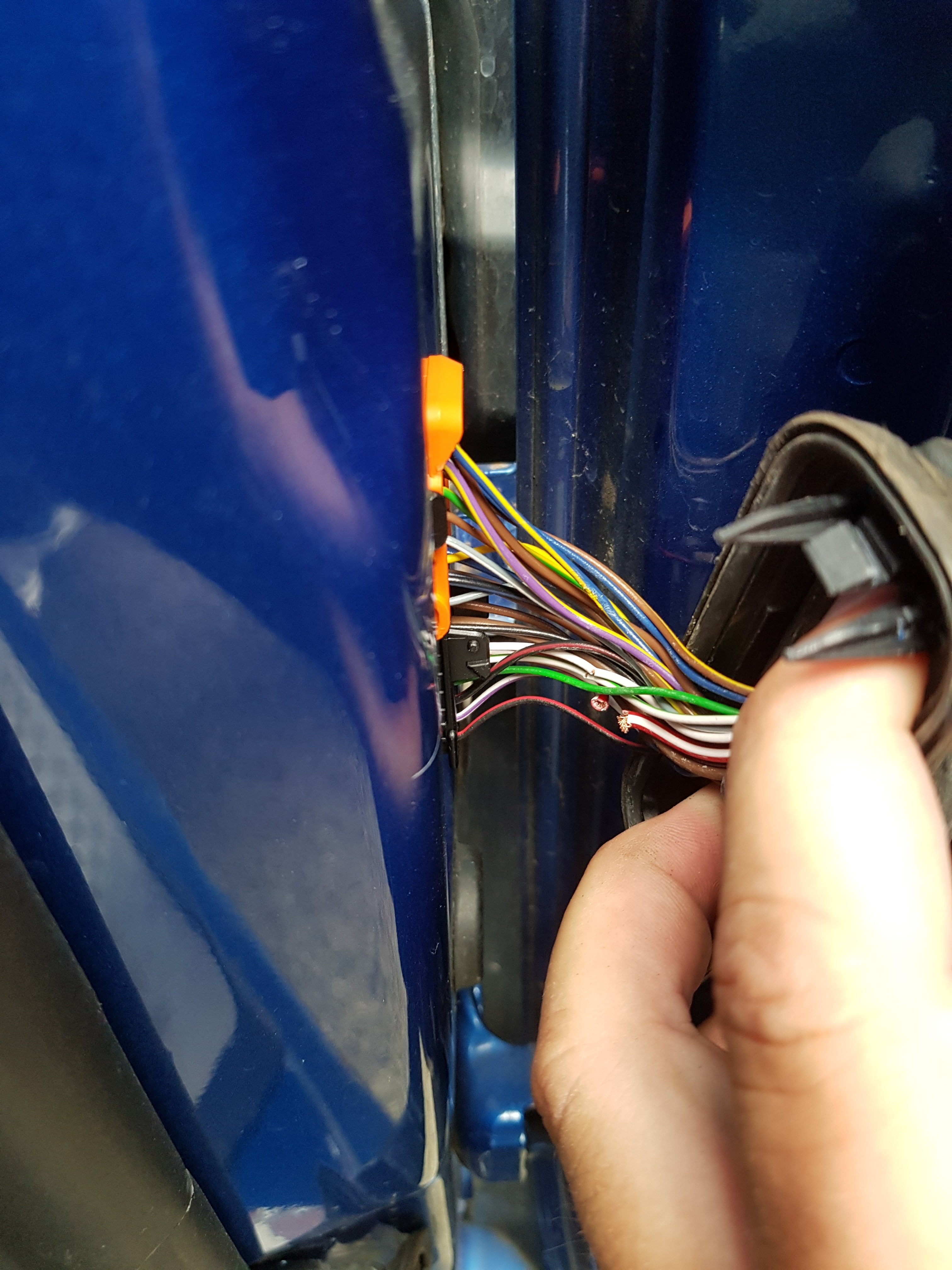

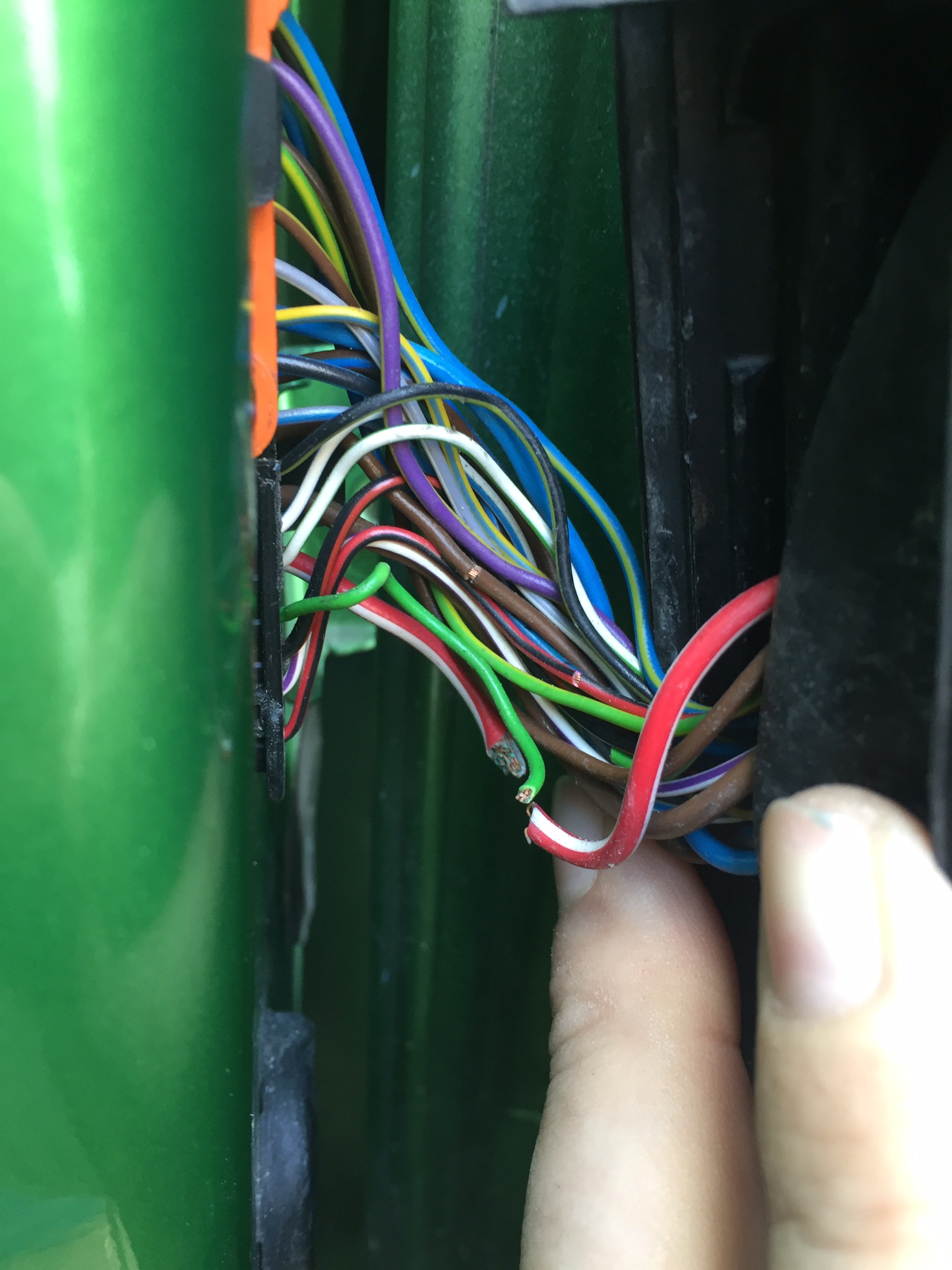

Found it.. wire broke completely when I pulled the seal back. Bodged for min :)
Thought so :tongueout:
I had this. Bit of heat shrink and soldering and back to been like new.
Great... The wires sometimes make the mirror switch fail, too!
