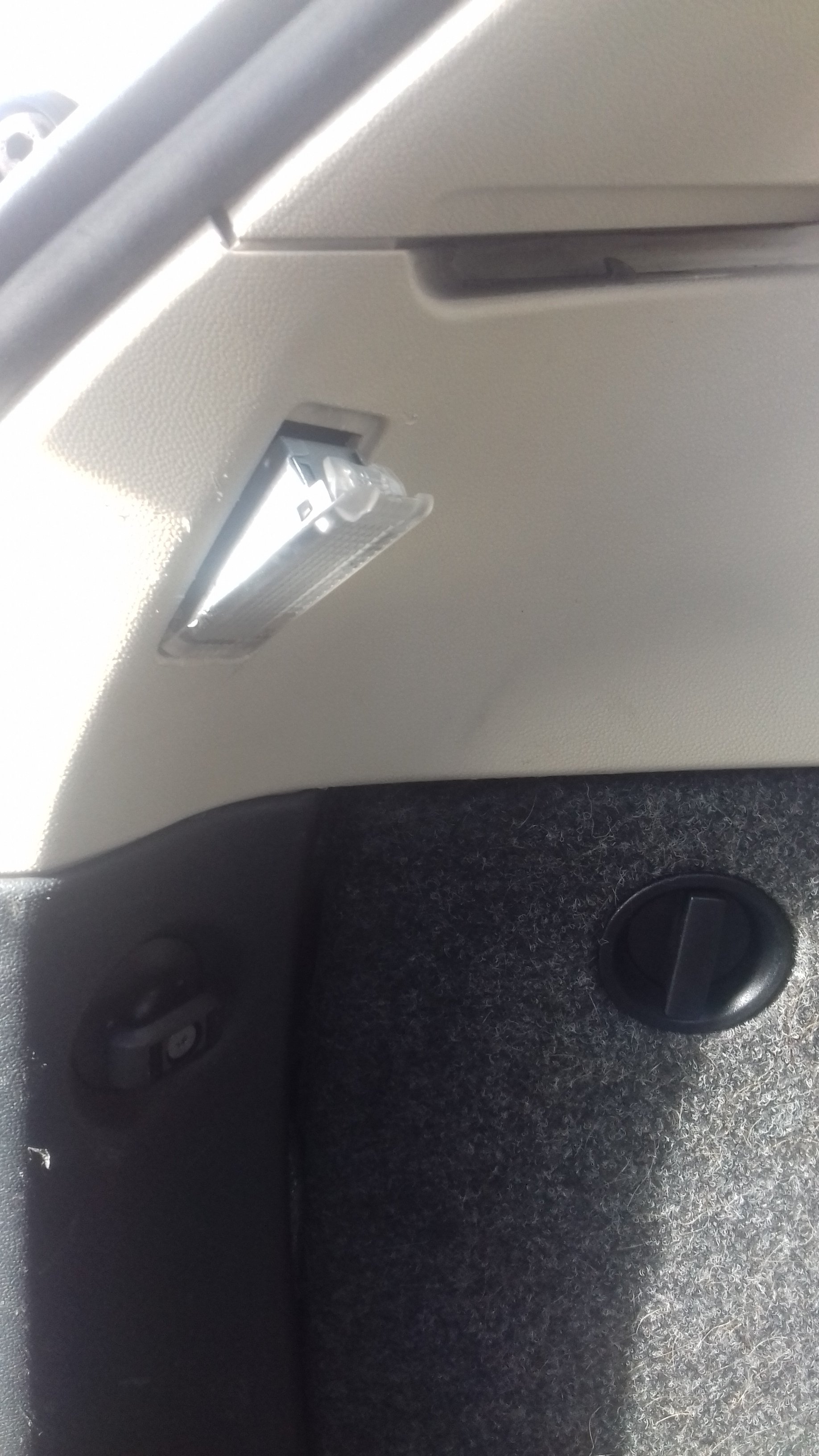

Hi can someone please help me lights aren't working in the boot how do you remove them can get top unclipped but can I he'll pull the light out is there an art to it or just brute force
I may be mistaken, but I'm almost positive the bottom edge has two sort of moulded clear hooks which at the angle of your photo are facing down. So once the top is out as you have them, then pull the up and away. Can't be that far off as I've taken them out myself years ago by fiddling and I didn't snap anything.
