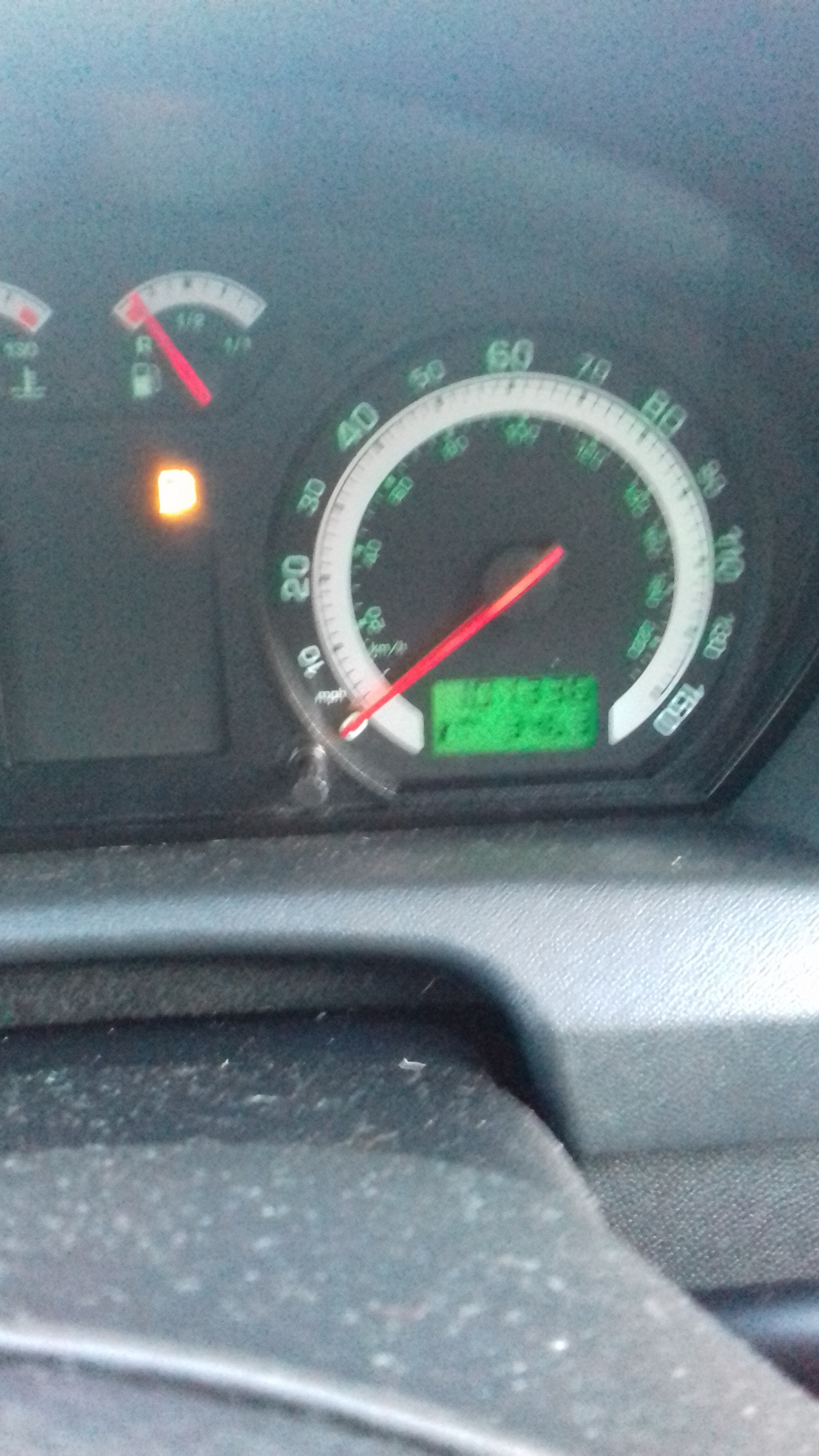

20171006_075447.thumb.jpg.67fee53a0eb271b928e8469605e9331e.jpgMy fabia vrs 2007 is driving me mad , its started to make a beeping sound and flashing the handbrake warning light .now its just doing it constantly
Low brake fluid probably

Checked and topped it up last week , so i'll check for leaks now , cheers

I suspect either the sensor for the low brake fluid is signaling low fluid or the sensor for the handbrake is telling the car it's on. As neither of these are true then I would check each sensor and associated wiring.
handbrake lever or rear calipers fully returned? Could this be the brake pedal switch?
How the fault came on tells you that it's either a connection issue (wiring/plug) or a failing switch (brake pedal/handbrake).
Well, my bad it turned out to b very low brake floid level .checked every day after filling up and its not gone down again  ...result
