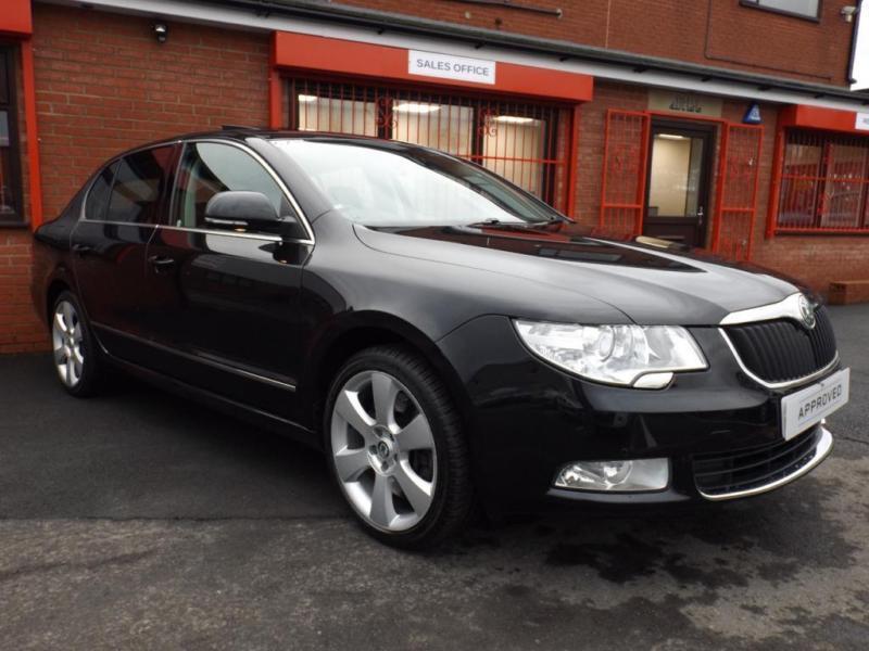

2.) Unfortunately, one of my alloy wheels has been damaged by a pothole beyond repair, (unknown which one of the thousands near me that did this). I have tried the usual destinations (Ebay, Scrap yards, Parts Finder, Gumtree and various other sources) and I cannot find the exact same wheel. Any suggestions? Picture of design attached.

You have cleared a lot of my worries up. I shall pop an ad on for the wheels. Cheers for letting us know what the name of the wheels were; it's been a nightmare!
