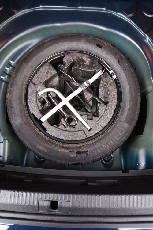

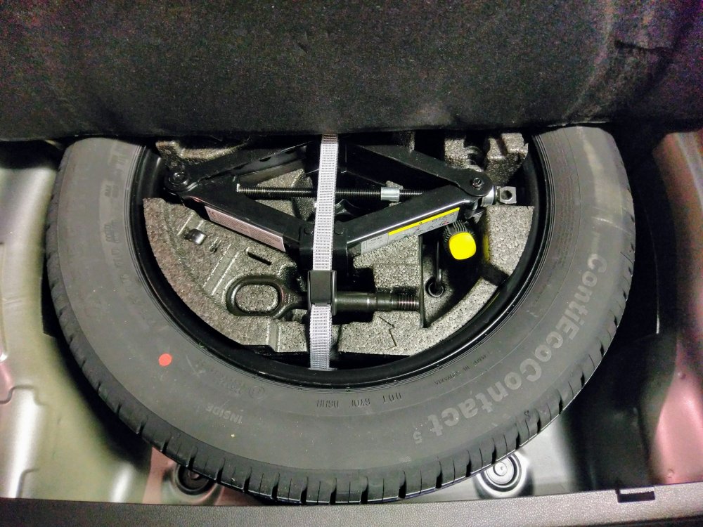

Spare Wheel what size will fit in boot space on a superb 3 hatchback.
Anyone know if a full size wheel will fit in boot well?
Options in brochure seem to suggest just a space saver?
I have just (last week) got a 205/55 R16 in mine with no issues. This is the OE fitment for a spare.

Same as widu13, full size wheel (205/55 R16) fitted a treat, no issues at all
I got a "full size" spare too....
The boot floor is designed for a 205 (wide) tyre, anything wider (like the OE 235) will mean the boot carpet will no longer sit flush.

I am looking into replacing my Mk1 with Mk3, so if someone could clarify that a 215/60/R16 wheel could fit in the spare wheel well, possibly with marginally raised boot floor by 5-10mm, I would be quite grateful.
Edited by dieselV6
The boot carpet actually sits on the tyre sidewall (205/55/16) so a 215 will rase the carpet 10mm... easy enough to do with a few strips of 10mm wood stuck to the boot floor.
From memory there is a fair bit of room around the tread in the spare wheel well.
I'd say there is at least 25mm of space all the way around the tyre in the wheel well so diameter should be OK.  As Gizmo says you would need to raise the boot floor by 10mm.

I bought a used a used 17” Stratos (same as OEM) and put a 215/55 R17 runner on it… didn’t want a space saver. I packed the rear and sides with 20mm of acoustic underlay using double sided tape and the standard floor now sits flat.
It fits the wheel well fine, but sits against the plastic lip just below the warning triangle housing. No damage at all, but it means removing the wheel at the far side first.
