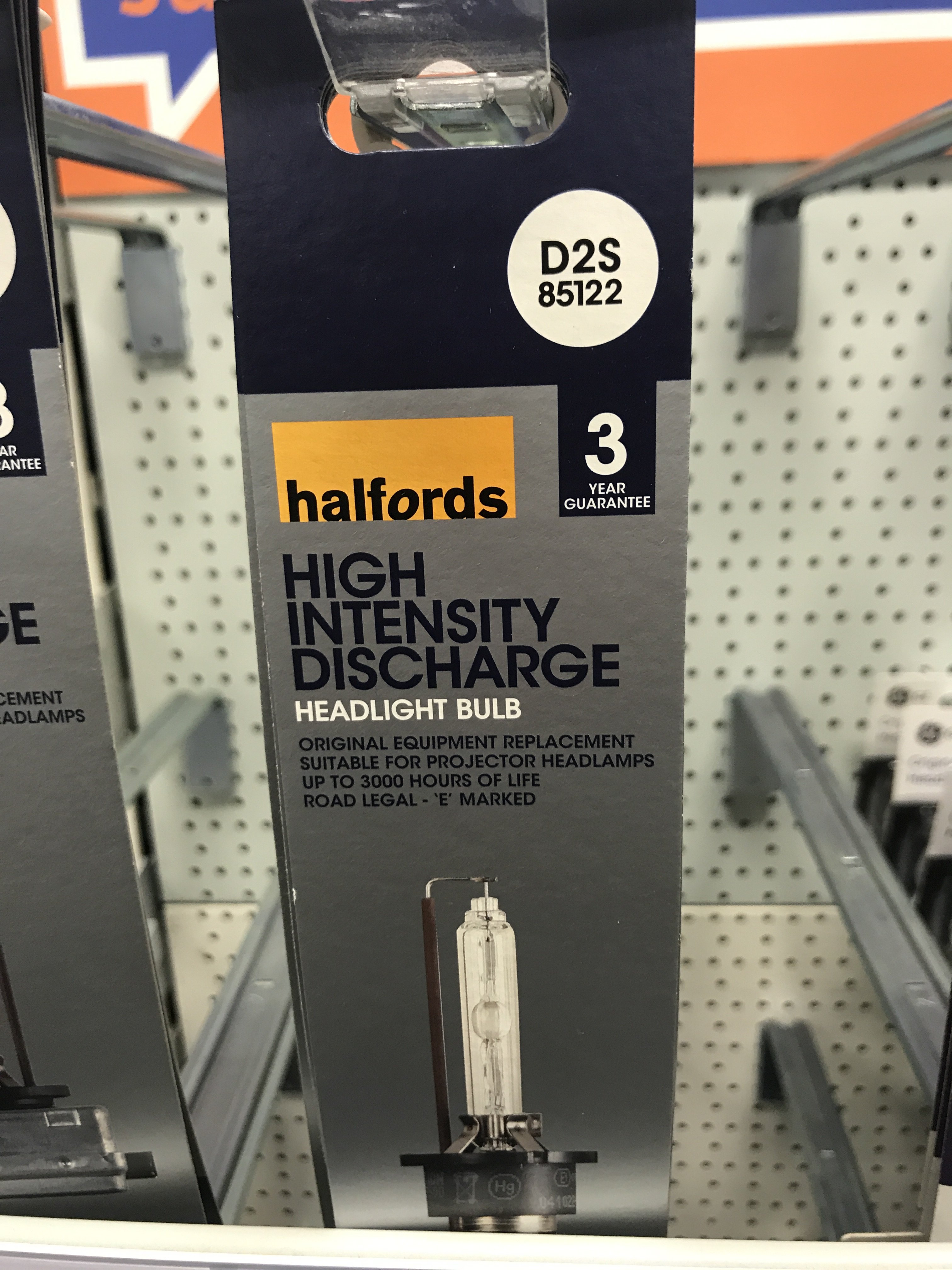

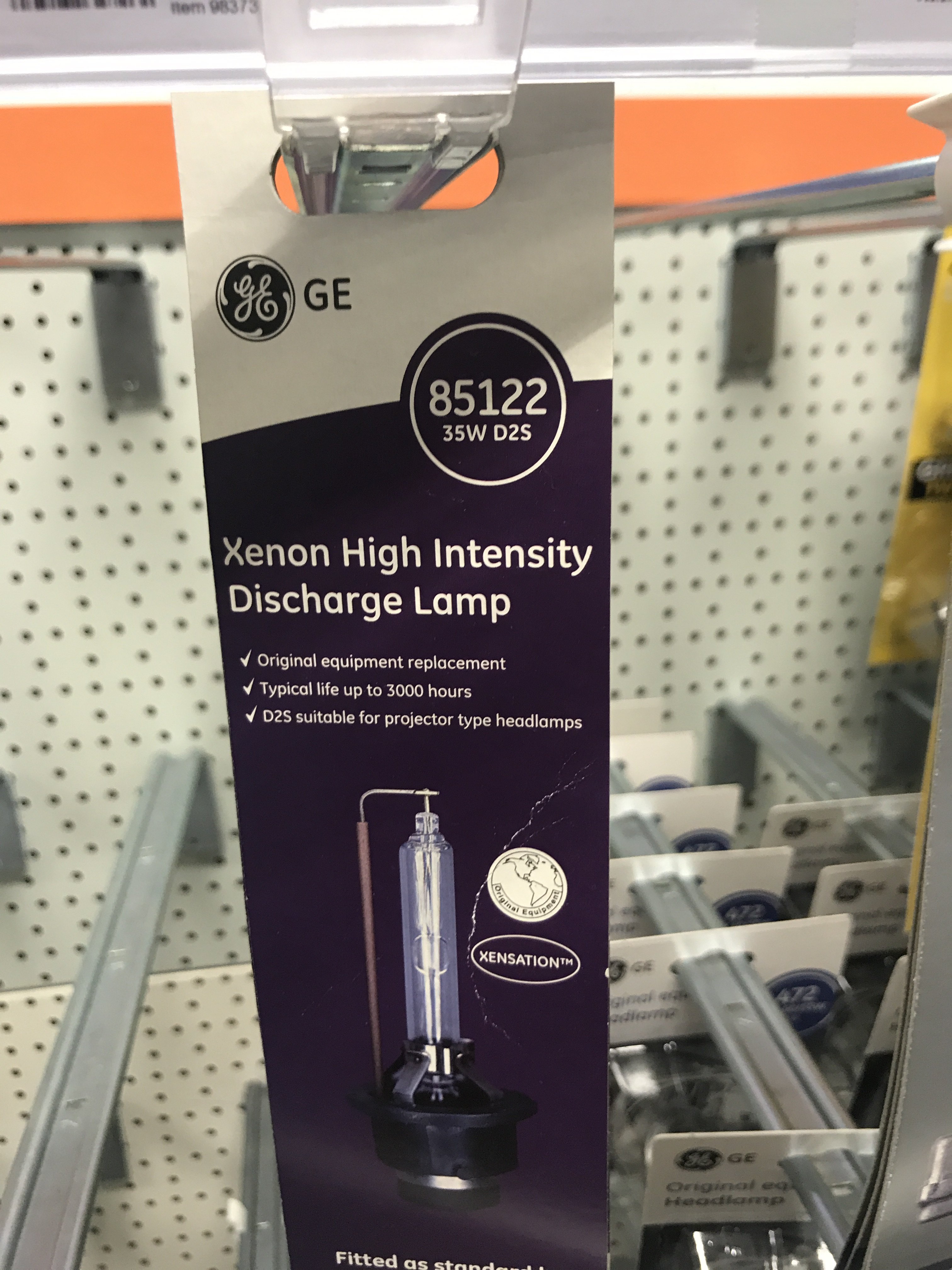

Ive seen these type of builds for sale in Halfords. If they were installed in the car would I need anything else or are they just fit and forget?
Unless you have Xenon bulbs already fitted and by the sounds of it you don't, you would need a high voltage discharge unit and new headlights as the fitting of these discharge units is totally different to standard Halogen bulbs
Thought so! Cheers Nigel :)
