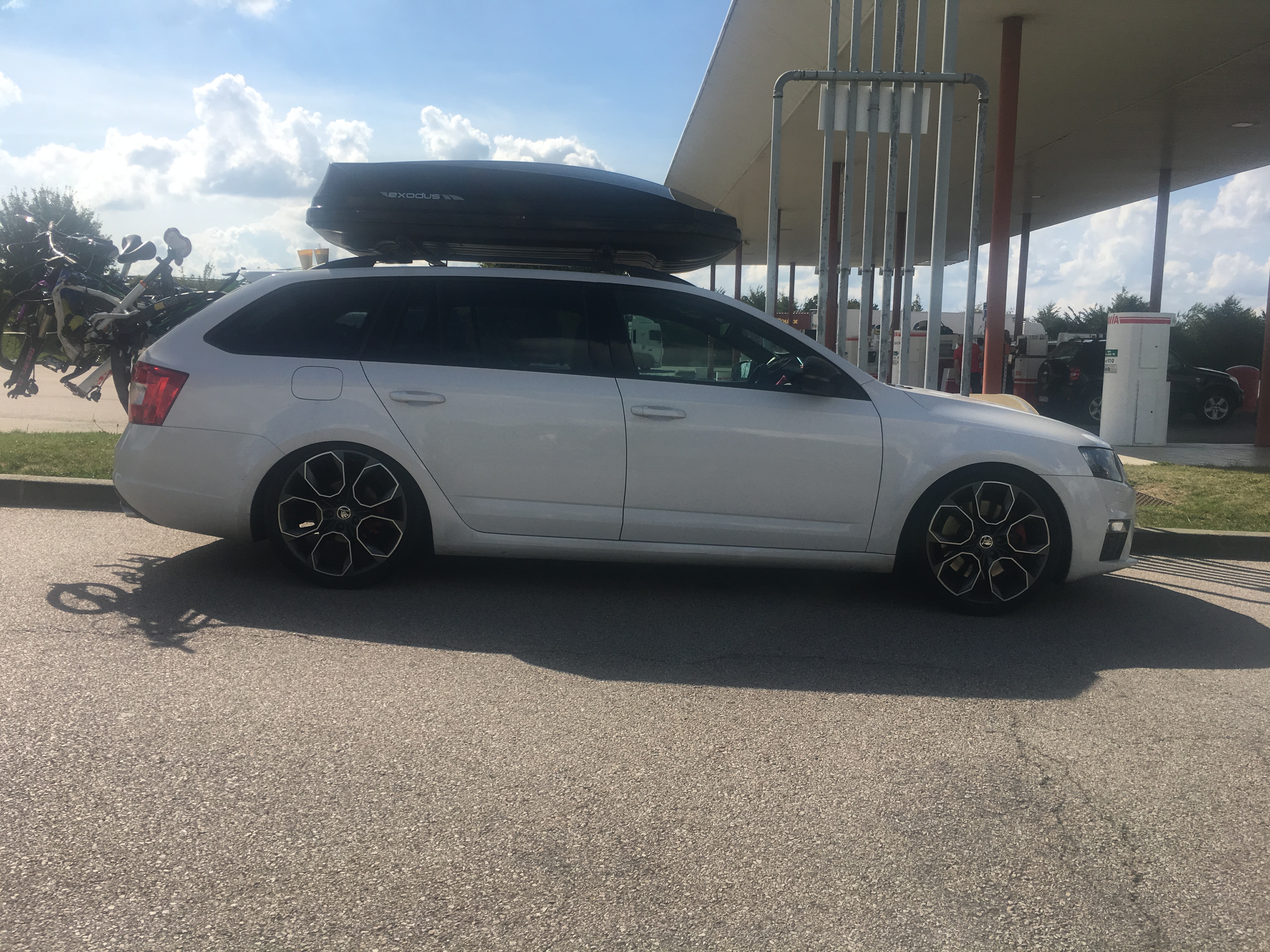

H&R purchased from eBay and 12mm spacers all round again from eBay. Spacers at H&R hubcentric and they are beautifully made. I would have gone with 15mm on the rear but I regularly fully load for holidays..

Haha 2 kids and all their paraphernalia. Family Camping in France isn’t a light trip. Snowboarding in Austria is similar but without the bikes lol.. springs had about 3 coils of play left.
anyhow all the people that worry lowering springs will shorten the life of the shocks and spacers ruining the bearings !!!! I’ve done 85k in it now with the H&R and spacers and at least 3 trips a year loaded like that. No sign of shocks being worn. Inside edge of the rear tyres however !!!
