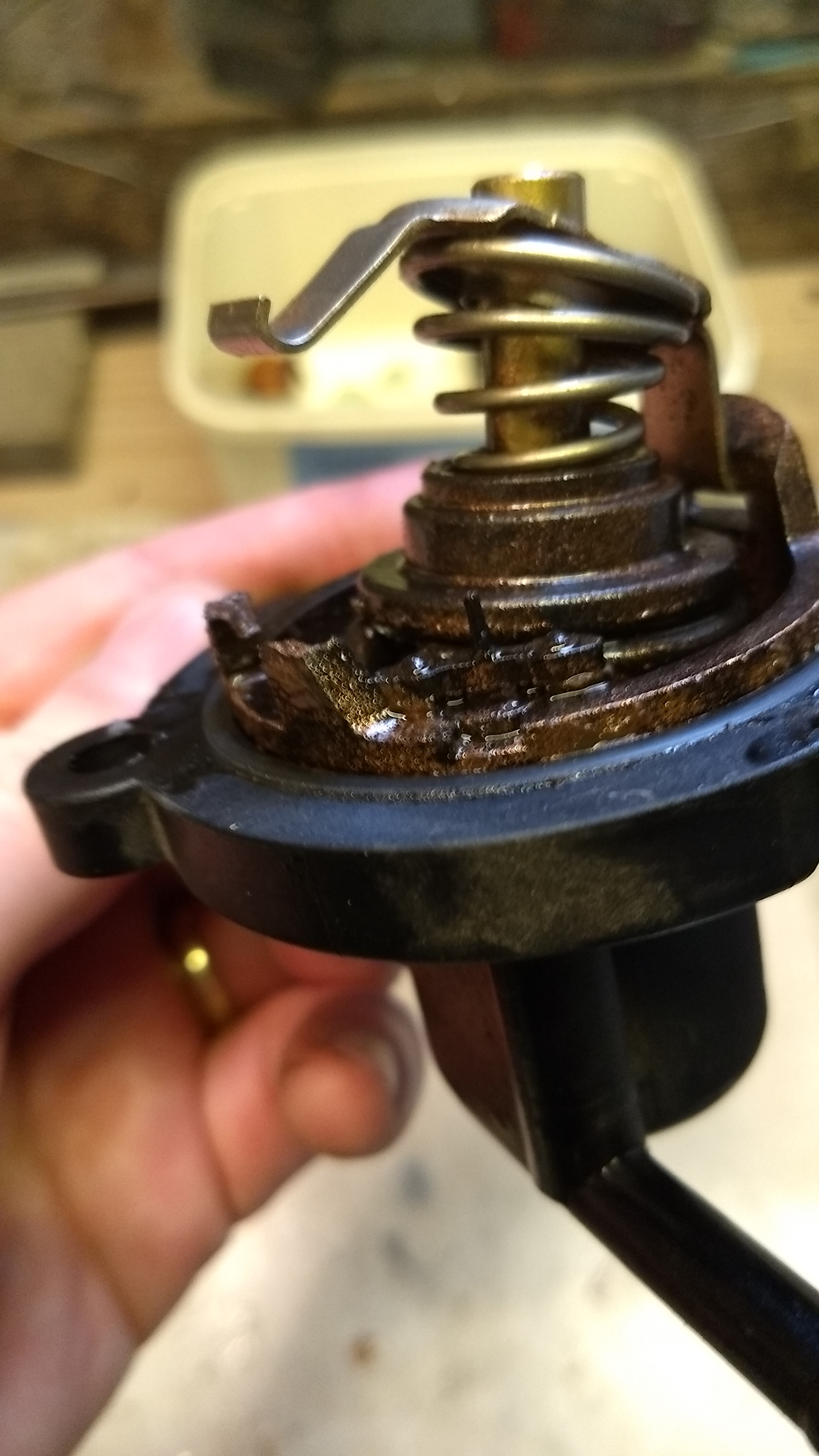

Just incase no one has seen a knackered Skoda MPI thermostat, here's one.

Not the best ever design of thermostat.
Was it overheating?
No not at all, she'd been running a little cool but the other night going home the guage only got 1/4 of the way up. I needed to change the coolant tank so thought I'd do it all in one go. Drain, flush, new coolant, new stat and new tank. Runs better now and the guage sits bang in the middle.
The same housing as my old Felicia mpi. Shame they didn't change the design/material on the Fabia. Had changed 3 housings over 5 years till a mechanic at an independent put a metallic after market and it is ok for more than 10 years.

Mine had a bill for thermostat replacement when I first got the car in 2014 so it's probably due to disintegrate any time now :D
Be sure it won't bypass you!!! It is only two plastic loops each 2-3 mm of plastic that withstand the force of the thermostat's strong spring.

Yes I think I will replace it soon. Silly design.
Have ordered a genuine thermostat housing which has the thermostat and coolant temp sensor already fitted. Hope it comes with an O-ring for where it mates to the cylinder head. Bloody should do for £50!
Anyone know if the latest thermostats are modified to do away with the daft plastic bits that snap? Although, confusingly, looking at TripleMcB's photo it looks like it's actually metal that has snapped. Maybe it's just the way it looks in the photo.
Nah! it was definitely plastic on the original and on the new one which was a genuine part it was also plastic. I got mine via my local Seat dealer her in Kidderminster. The parts guy Miles is pretty good. As long as you have apart number he can usually get it by the next day. Strangely I paid £47 for mine.
Went on with no probs at all. Came with all the bits, O rings, sender unit etc. Easy job.

So they never bothered to improve them :x A normal type thermostat would have been far better.

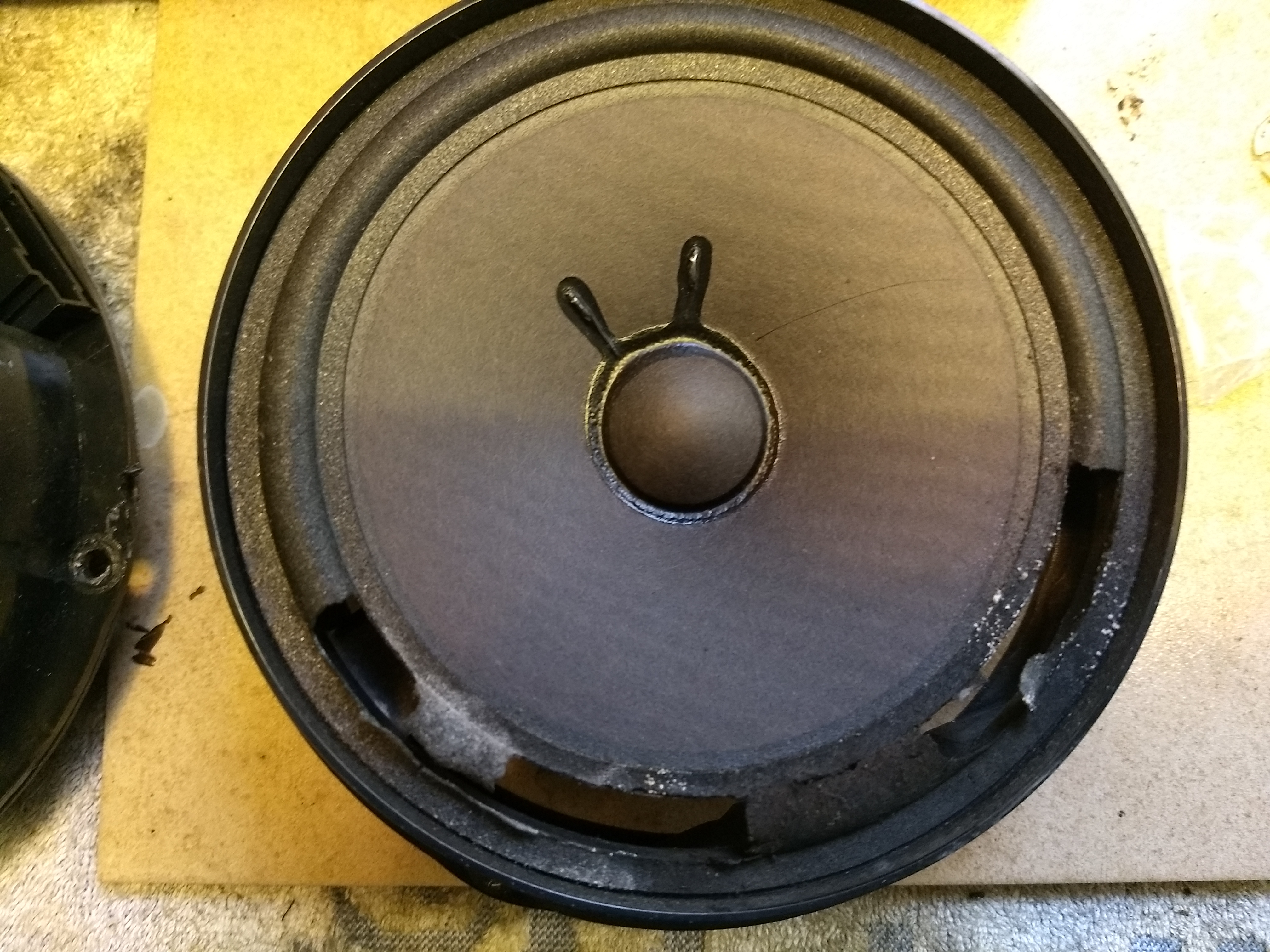

Cheers. Just picked up the bits. Spent the morning sorting the front door speakers out and the nsf latch. All done now but think I have broken the led indicator in the drivers door.  I'll have a look tomorrow.
Here's a pic of the drivers door speaker
That's a poorly speaker :D
