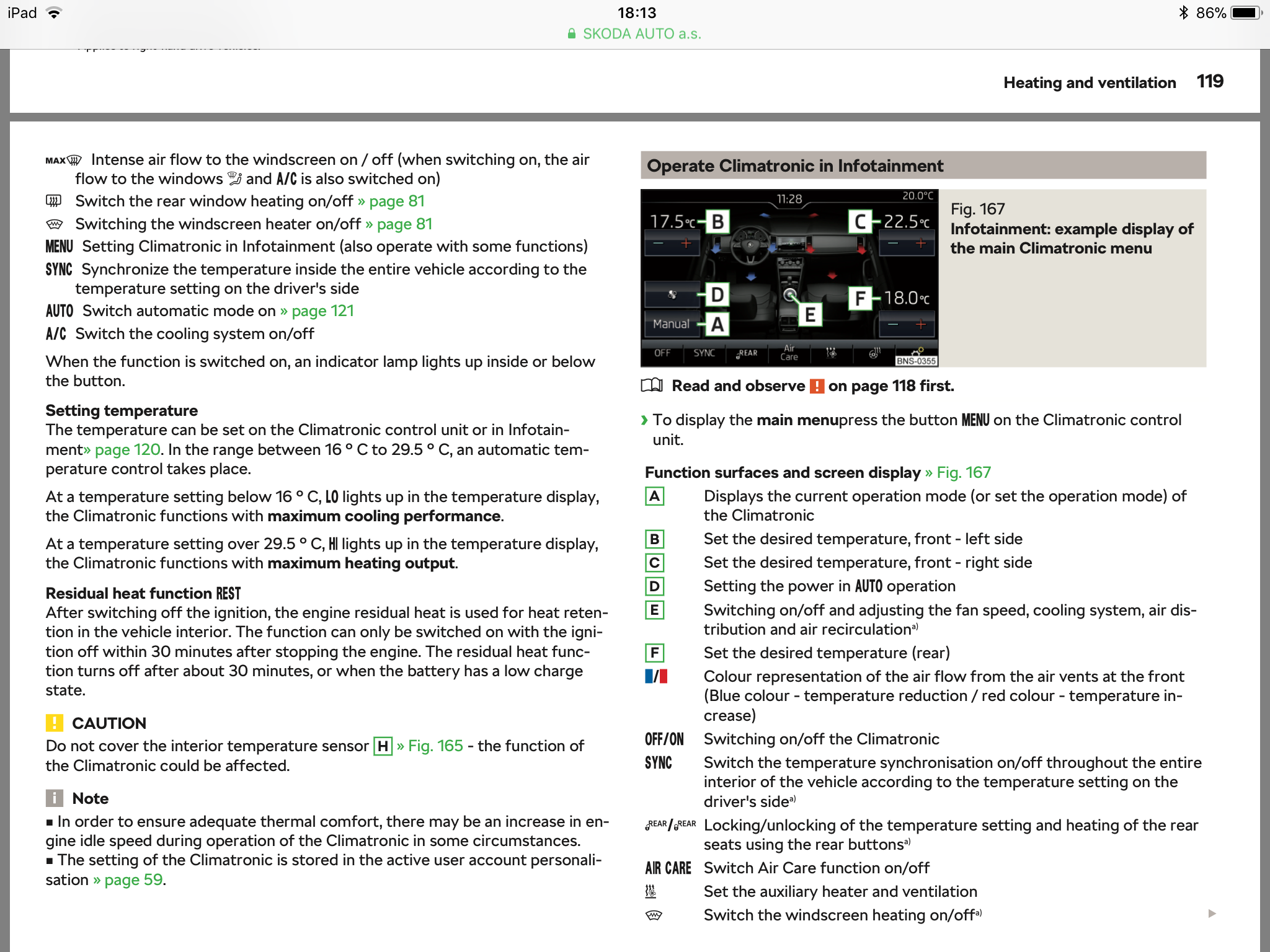

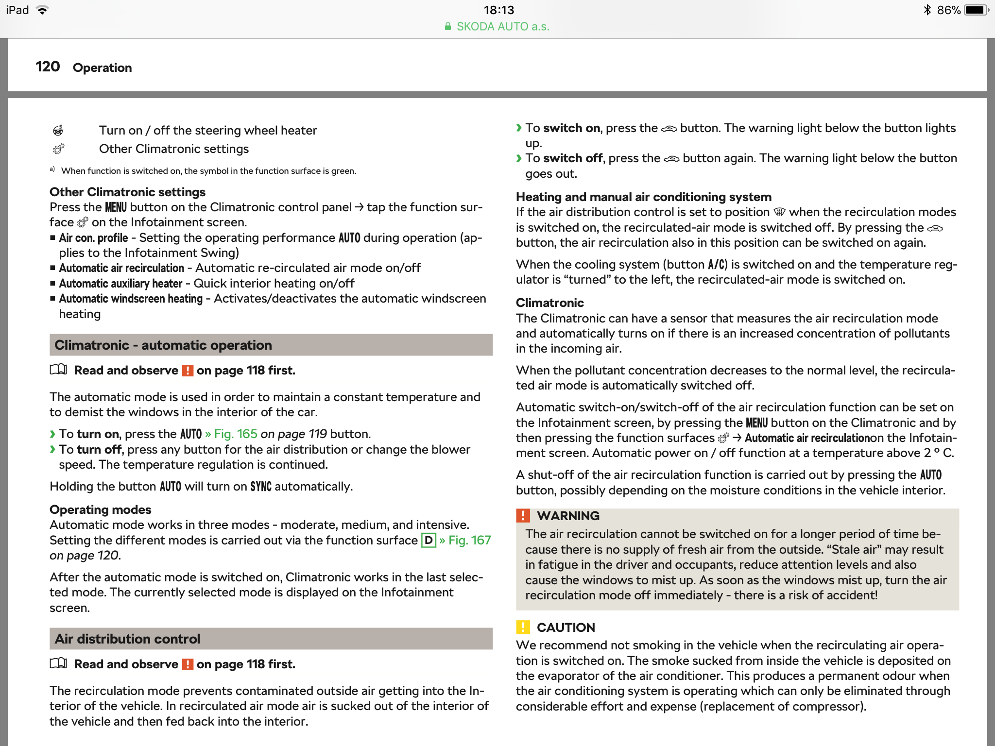

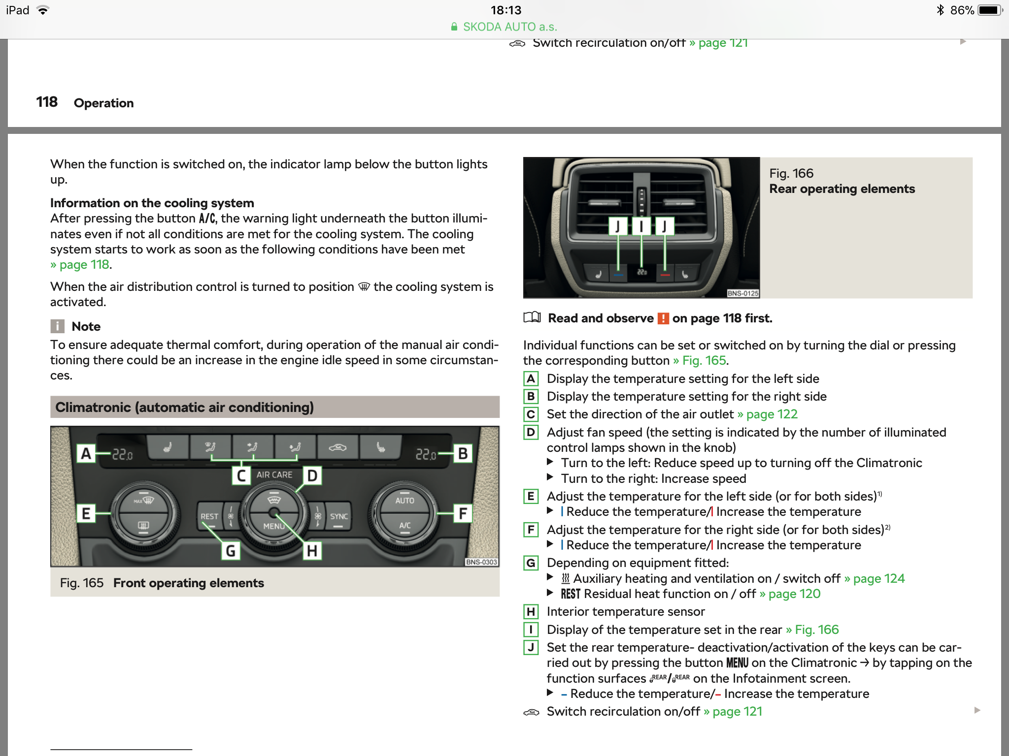

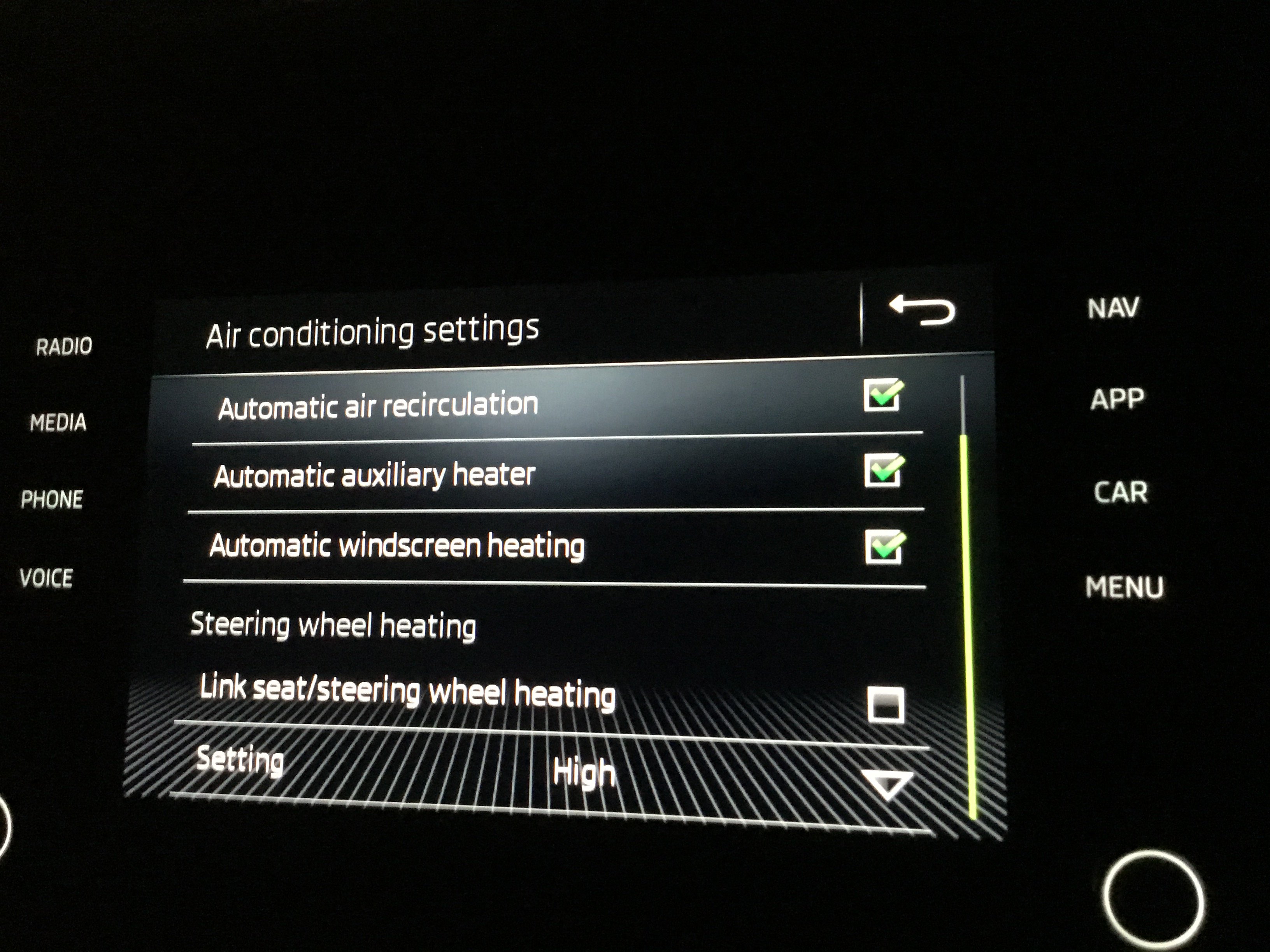

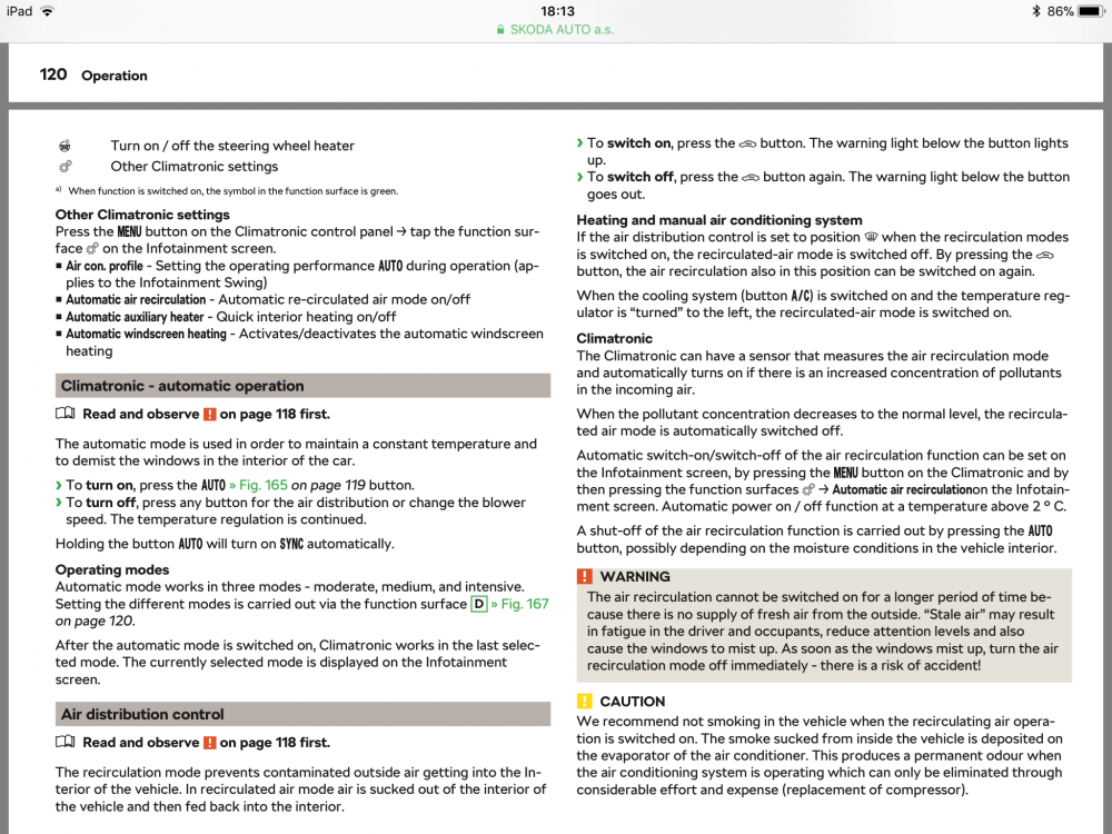

I wasn’t aware of any special heating so I perused the handbook and came up with these pictures that must be behind it all.
It’s not crystal clear.
Once you don`t have Webasto (correct?), then you must have ceramic heater. Not familiar with new Superb/Kodiaq settings, but in Superb 2 you cannot switch one on or off. And there is no sign that it is onboard except very fast passenger room warm up. And the knoledge your car must be equipped with it.
P.S. Found a code for electric heater: 7E6
Only for diesel engines with automatic operation at temperatures below zero Celsius.
Probably you can find on ODIS (?) if your car is equipped with one.
