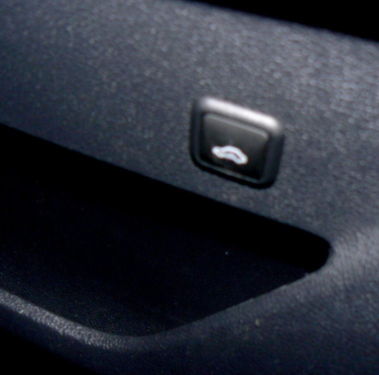

mystery switch in drivers door
it goes off as the interior lights go off...with the door closed
it goes off if you put the key in the ignition switch...with the interior lights
the push feature doesnt seem to do anything
i thought it might have put the interior lights on when driving just momentary...?
with the engine running and doors shut it wont put the interior lights on....the push button operation doesnt have a switch feel to it in any evern...almost like an over ride if you hold it..but no change in status
see the previous thread re: any connection with boot light
cheers

Afaik its sole purpose is the disable the internal alarm sensor (which I think is ultrasonic)
My button has a normal click action

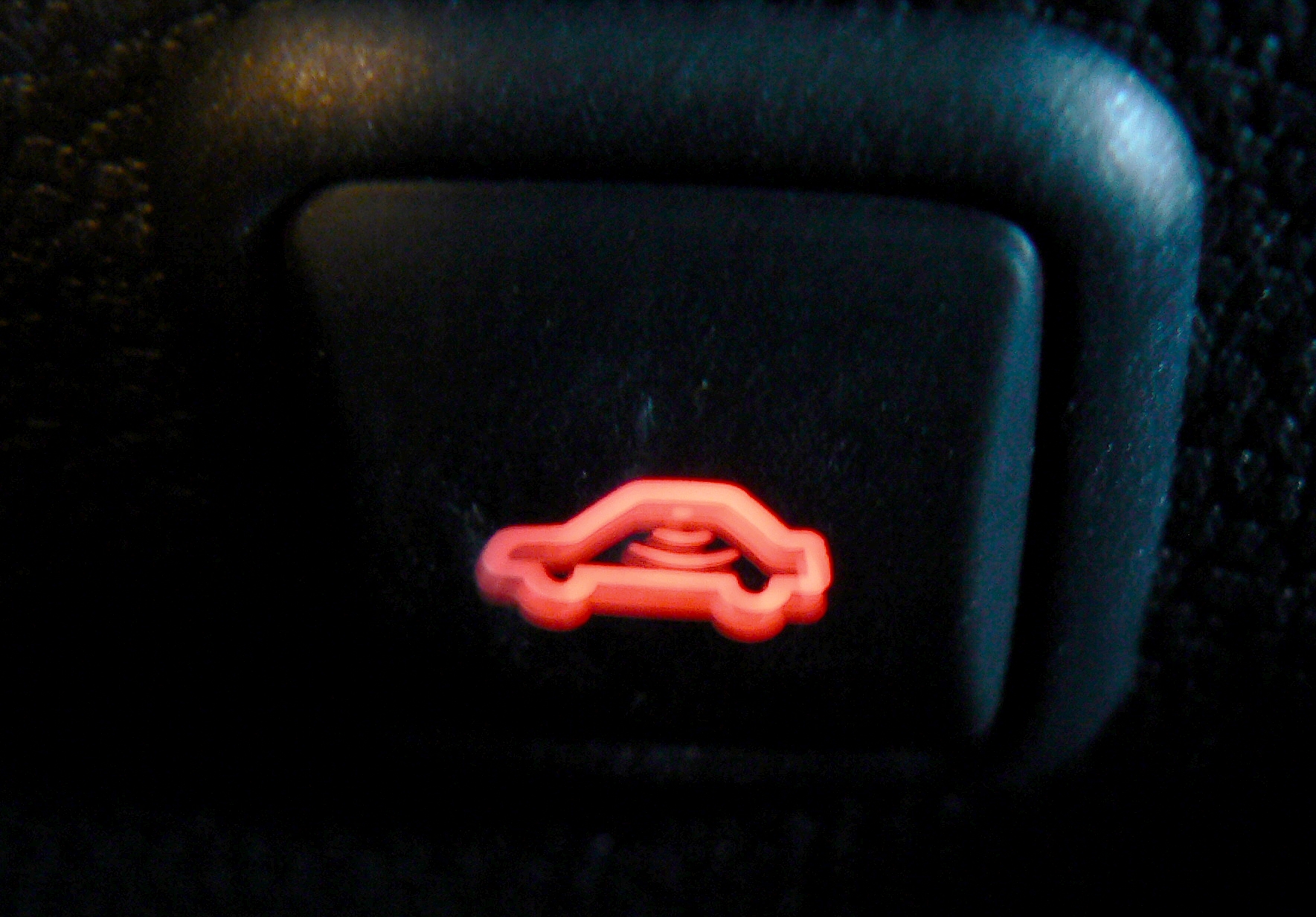

I have just checked that switch on my wife's 2015 Polo which has an alarm, first time that I've pressed it, that switch should not have a latching on/off function as you are only requesting that the interior monitoring is disabled "this time" prior to locking that car. So, yes it is red as shown above before you do anything, which means that when the car is locked up interior monitoring is active, when you press it it turns yellow which means that after you lock the car "this time only" the interior monitoring is disabled.
Edit:- you can toggle it off and on, but that switch should not be latching on or off, it is just that you are sending a pulse to the controller, first pulse ON, second pulse OFF -  etc.

thanks...i found the page with the instructions...
turn of ignition, press the button, lock the door within 30 seconds...
the suggestion is that turning this off is when towing or moving by ship etc
and if children or animals would cause movement
animals ok....but what situation would children be locked in with the childproof locks on..??
tomorrow i guess all will be solved...i am keen to see if the light does turn from red to yellow...i was pressing it several times but it stayed red

guess what...i locked myself in the car so i could observe the interior lights dimming...it was hailstones outside
and then
THE MOTION SENSOR WENT OFF...!!!!
so i have one...i will try the push button idea from the inside then lock myself in again...to test the effectiveness of the over-ride technique is working
