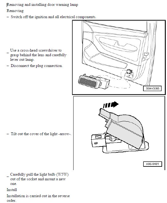

the red warning light mounted in the door has stopped working blown bulb probably but cannot see how to remove it to replace
don't want to start levering in wrong place and damage door trim

thanks urrell this is just what I needed
