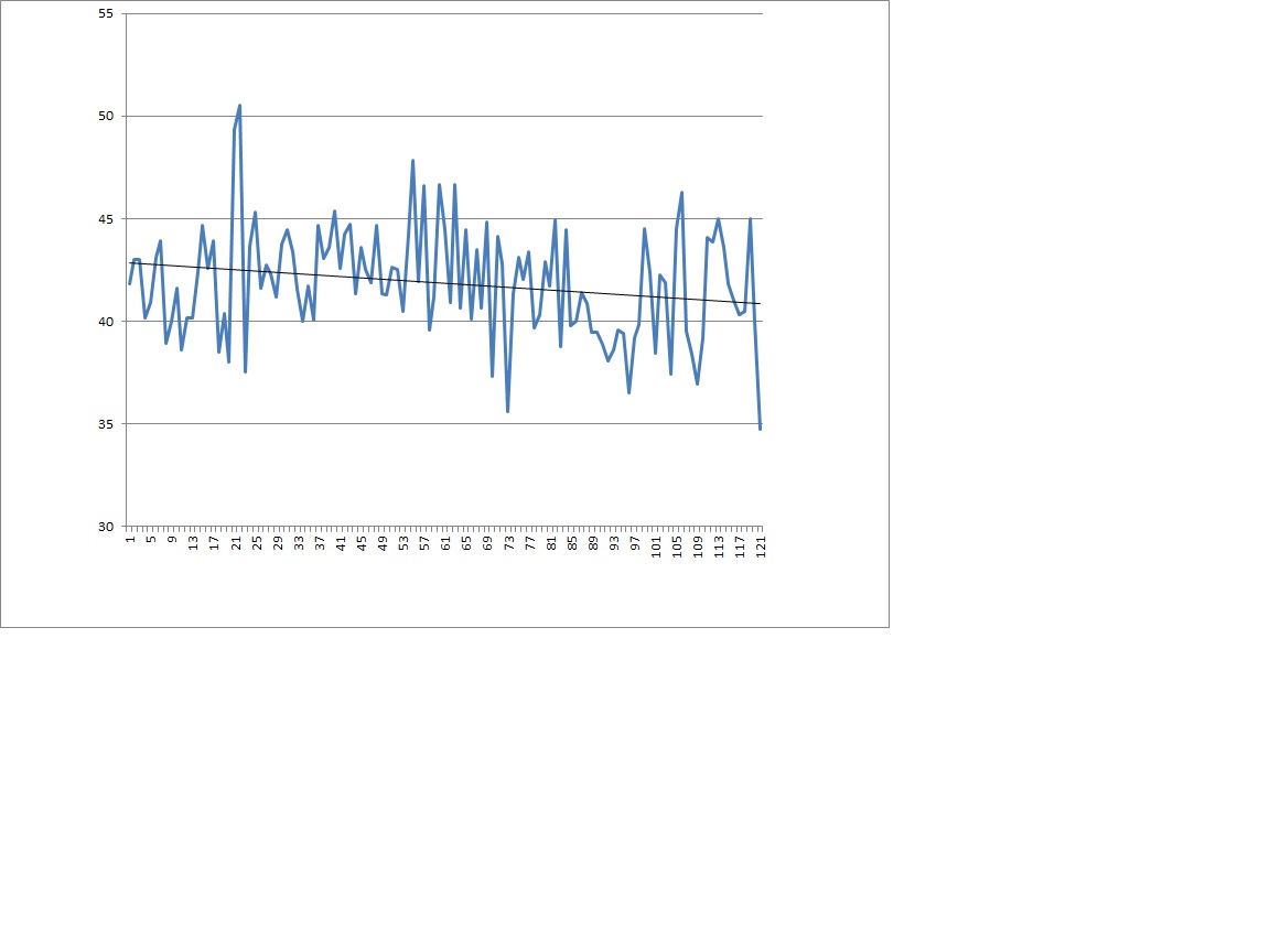

My Yeti is just over 3 years old now and has covered ~61k miles. I've tracked all my fuel use on Fuelly and noticed there is a downwards trend across all (122) fuel ups - see below:
The car had "the fix" around 10K miles ago, but was then remapped (stage 1) by Shark.
The VAG DPF app tells me my DPF is healthy and it regenerates every 180 - 300 miles, dependent upon use.
The car drives fine and according to the Torque Pro app is generating 177 BHP, which is around the expected level for a stage 1 mapped 140 BHP TDi.
I don't have VCDS, but Carista tells me there are no issues.
The car has a full service history and underwent a full service (all filters / oil / Haldex fluid) around 5k miles ago.
The car has generally averaged in the low 40's MPG,  but if the current trend continues I'll soon be into the 30's!
Should I be concerned?

The trend appears to be upwards until the 49th fill up, then slightly slightly improving followed by a slip downhill to the 87th and then it jumps about a bit.
Do those points align with the fix and remap?
Knowing you've had those things done, I'd guess...
Ran in and drove normally.
Had fix, drove slightly more conservatively to be sure the fix wasn't causing any problems
Went back to driving mnormally
Had the remap and on occasion had a bit of fun
Looking at the 87th fill up onwards it appears to be improving (though it's rather erratic) so I'd not worry for now
A bit childish, but........ good fun won't help your mpg figures :D
Could the increasing fuel consumption be the effect of the increasing amount of fun you are having with your car?
Colder weather takes longer to warm up
"The Fix" occured between fuel ups 85 and 97, which bizzarely corresponded with a period of reduced variability. I certainly didn't drive any more conservatively following the fix, or any "harder" following the stage 1 remap (excepting a few miles of fun when testing the Torque Pro app / 0-60 / BHP etc).
The car's been used for a wide variety of uses over the past 3 years (family trips / holidays / commuting etc) and there have been no major changes in this pattern over this time period.
The onset of cold weather (? winter fuel) has seen a drop off in MPG each year, but it's the overall (downward) trend over 3 years / 60k miles which is a concern, especially if it continues.

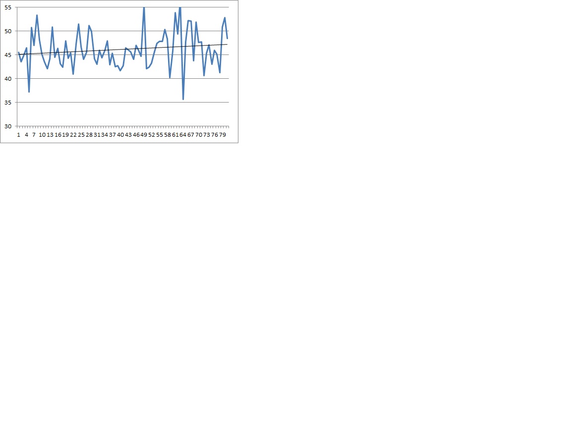

I've just been back and done a similar excercise with the last Yeti (2012 110 BHP TDi 2WD) I ran. I owned this for ~40k miles and see an overall upwards trend in fuel economy over this time - as below:
Stats and stats!
If you put your Yeti's first 10 and  last 10 mpg readings into a spreadsheet (hard to read off graph)  and work out their averages they are both very close
First 10
42
43
40
44
39
42
38
40
40
45
Average41.3
Last 10
42
36
46
36
44
44
45
41
45
35
Average41.4
Edited by bigjohn

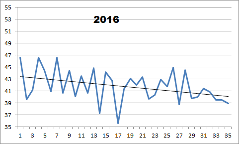

Many thanks for all the comments - I was a little bemused by the difference in trends for the 2 Yeti's.
Looking at my current car's fuel returns in a little more detail (broken down into years) I see a downward trend in 2016, but otherwise fuel economy appears fairly static (or even improving) across 2014, 2015 and 2017:
Panic over:thumbup:
