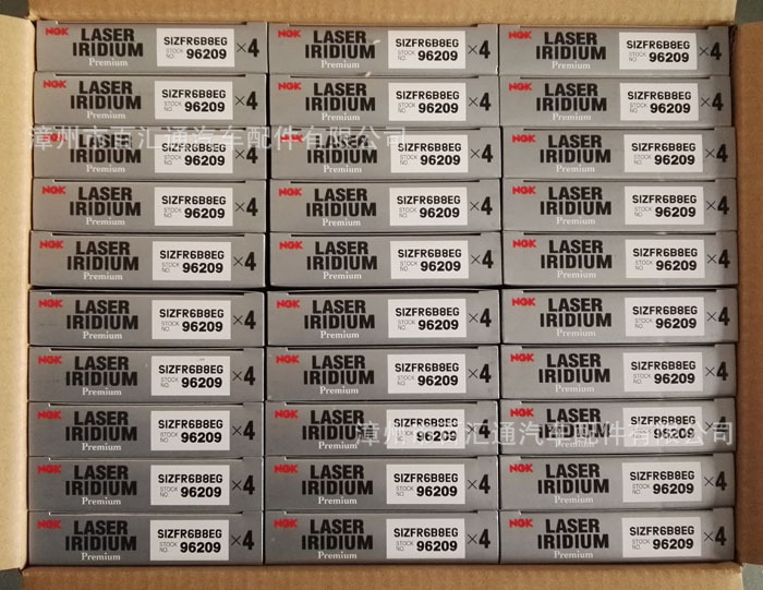

They are OK if the correct numbers,
see the posts in the Pinned thread at the top of this section. others using the NGK 'R'.
So did you check all 4 plugs gap was correct and get them in without knocking them?
Are these the ones you fitted, as were in as OME until 2012, before replaced with the later ones.

Yes, I replaced the IR ones with R ones as Euro parts had these in the section for my car. I had not measured the gap on them as I assumed they would have the correct parts for my car. I slotted the plugs in by holding the tip with some long nose pliers and placed them in the thread.
After you have checked the breather pipes, or before since you need to move them then best check those plugs gap.
Put them in on the end off a length of rubber hose is easy.
They are pre-set, but you still need to check all correct. they can be taken out a box in a store or at a counter and knocked
or just sometimes you find they are not correct across the 4 plugs.
Originally Skoda / VW had them at 0.8mm, but then changed to those in the bottom pic and 0.7 mm.
That was during the CAVE being Produced and the change over to the CTHE.
