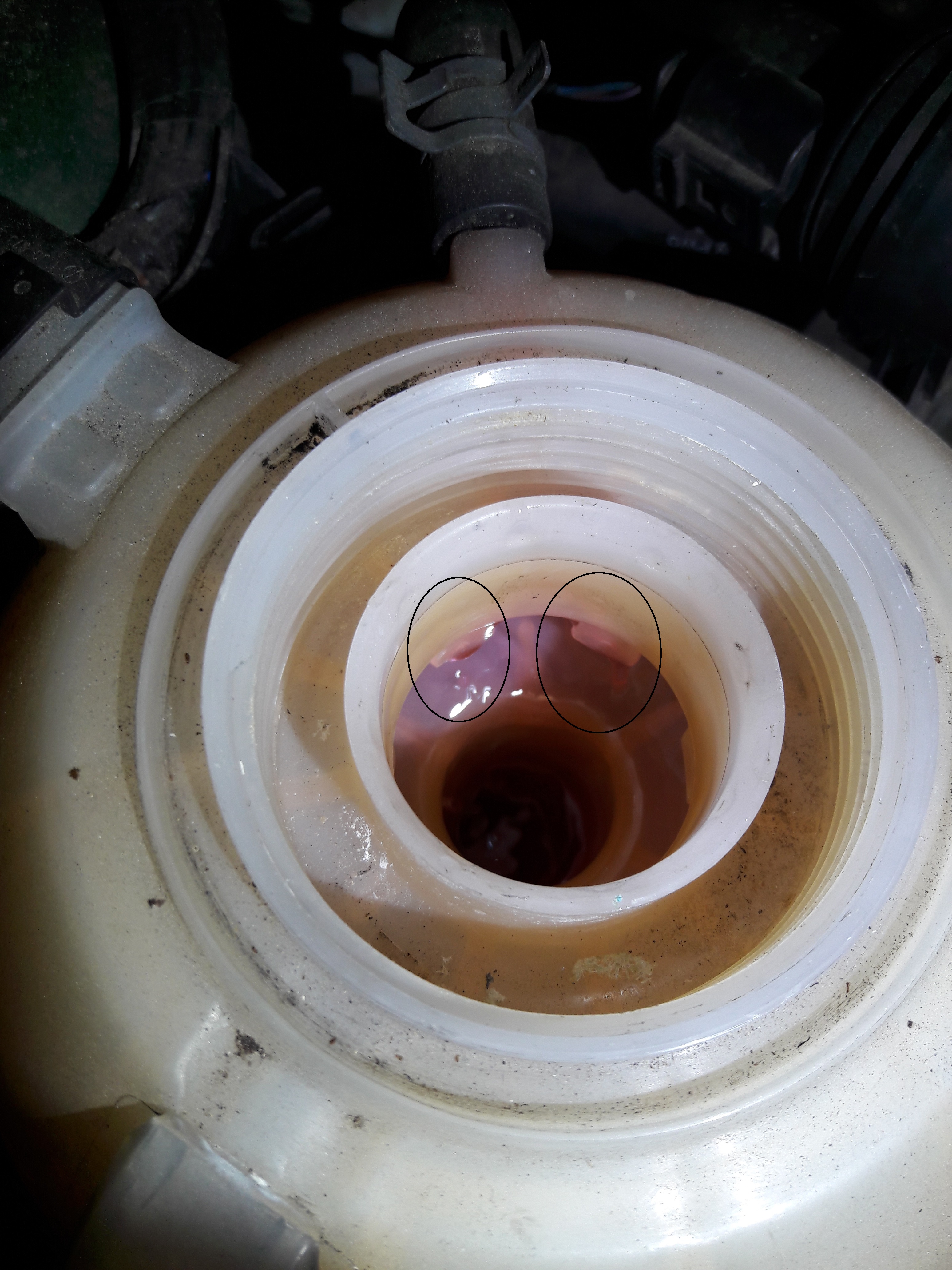

Seems far-fetched but is the new water pump actually pumping? If you rev the engine while looking into a capless expansion tank, do you see a nice squirt of coolant?

I don't see any squirts of water in the expansion tank. But didn't with the old either. I originally thought pump faulty or impeller in correctly fitted? Is there a pipe I can remove? Guessing top thin pipe? That I can remove to confirm if pumping through or not?
The pump was slightly different original plastic and not looking like a standard impeller. New one looks like an impeller but a metal base.

Yeah, I think top thin pipe should squirt when engine revved. I'll just pop out to my Polo to check.
  • Sponsor
A little tricky to test without a helper and I didn't think the missus would jump at the opportunity, but a steady stream of drips at idle and more of a stream when revved. A video with a helper would've illustrated better, but if you've got nothing going on there, I'd say you have low or no coolant circulation.
