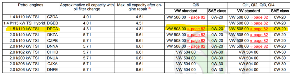

I found some Superb workshop manuals someone posted on here, and in those I've found the following:
I believe mine is a MY2021 (registered June 2021).
Scrolling down to 3.9.2 I see:
Mine is a DPCA engine I believe, as my engine number starts with "DPCAxxxxxx"
So, looks like 0W-20 is the correct oil, as per what the dealership used 12 months ago.
And the 0W-30 that RAC put in today is wrong. ☹️

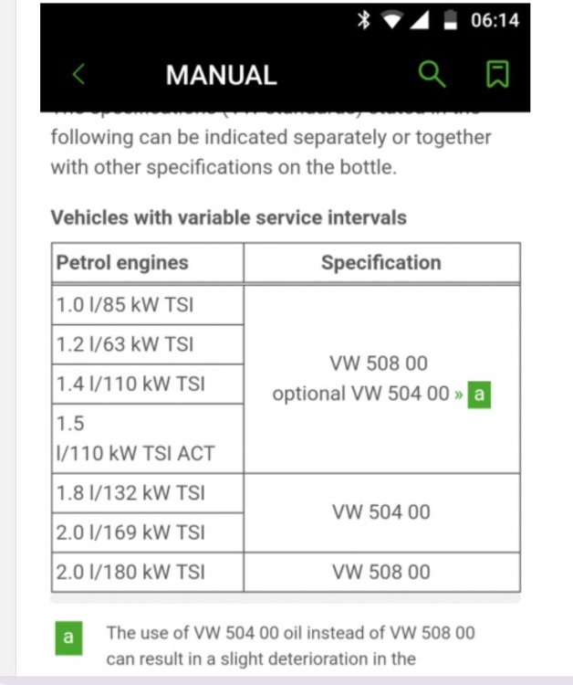

The Recommended oil by Skoda / VW Group for the 1.,5 TSI ACT has been VW 508 00 / 509 00 since 2018. 0w 20 FS IV. Simples as that.(To get the WLTP & RDE2 Results needed.) No harm done with the VW 504 00 / 507 00, 0w30 FS III or 5w 30 FS III

0w-30 is the spec for 504/507 which is in mine (the 280) but to add confusion the standard used to refer to 5w-30 and was lowered.
The oil will still lubricate and transfer heat; but I’d drain and replace with all of one type to be on the safe side.
^^^ They went 0w 30 FS III just the same for the WLTP / RDE2. Because the engine needed decent oil and not the P!ss poor 0W 20 FS IV .
Ah cool, ok, so there's benefits in them being able to sell cars with better emissions etc if they specify that oil. Makes sense. Ok, I'll stop worrying about the 0w-30 that's in there then, cheers.
