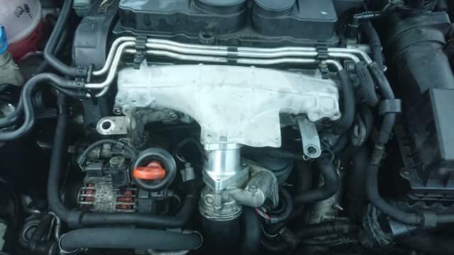

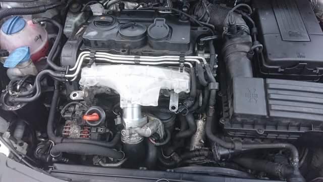

EGR and EGR cooler deleted and removed and eco map done at the same time approx 190 bhp loads of fun torques too
egr cooler was leaking

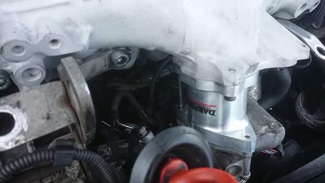

BKD dark side inlet kit fitted to replace worn runner flaps leaking oil making a right mess!
turbo oil return pipe fractured resaulting in oil going all over the back of the block replaced with genuine new item
tandom pump seal replaced leaking diesel and oil over the gear box

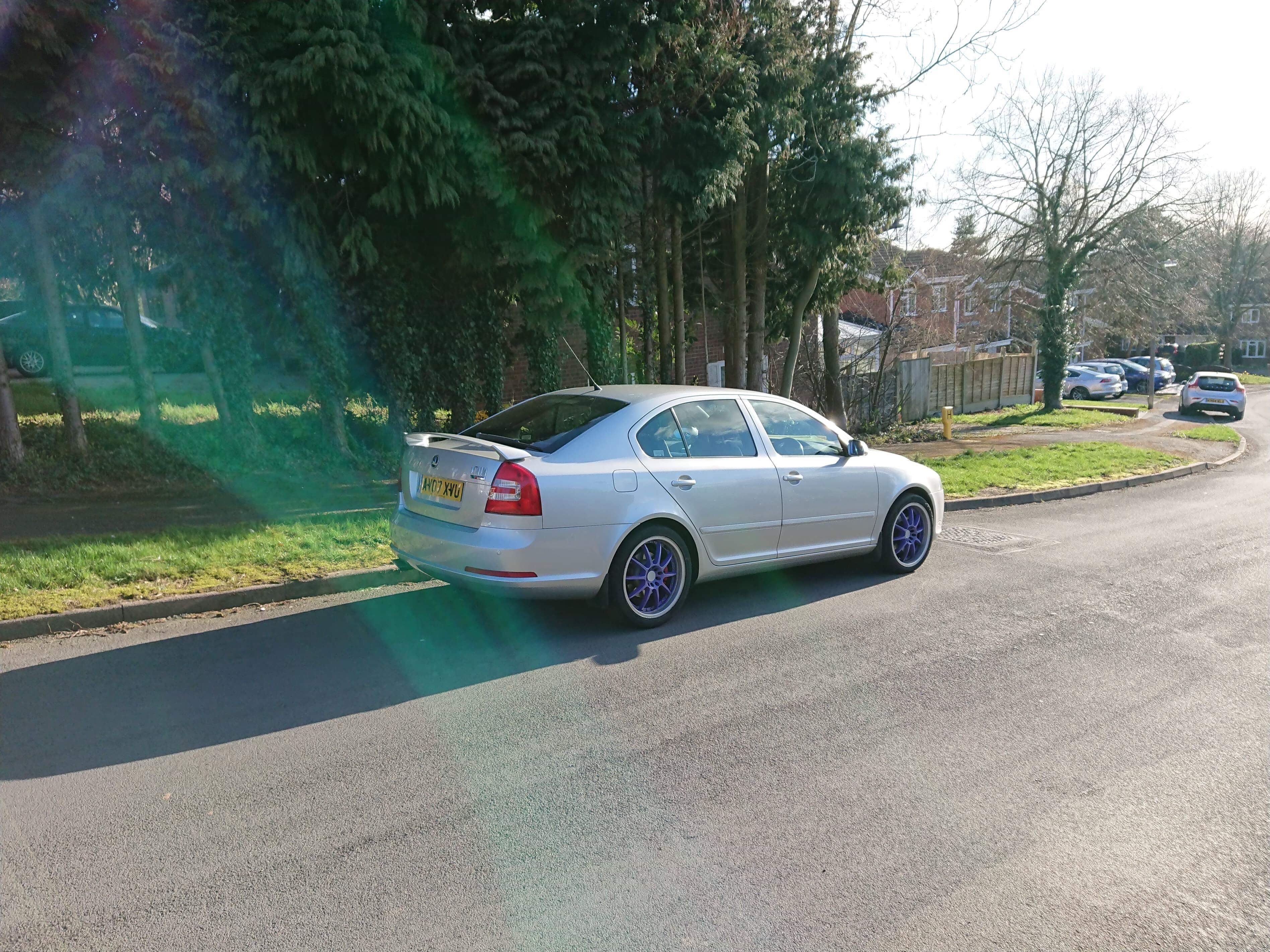

quick pic pic of the car only one iv got tbh it need some love now
planned work alloys need refurb thinking black or dark grey would like to loose the dpf but with new laws coming in might just leave it until it’s knackard wouldn’t mind a better condition driver seat bolster is worn new brakes for the rear but iv got new disk and pads from my golf that I’m sure will fit , plan on giving It a good old clean next weekend once the snow has buggered off so I’ll up date pics then  also I need another engine cover as the one that come with it just fell apart :(

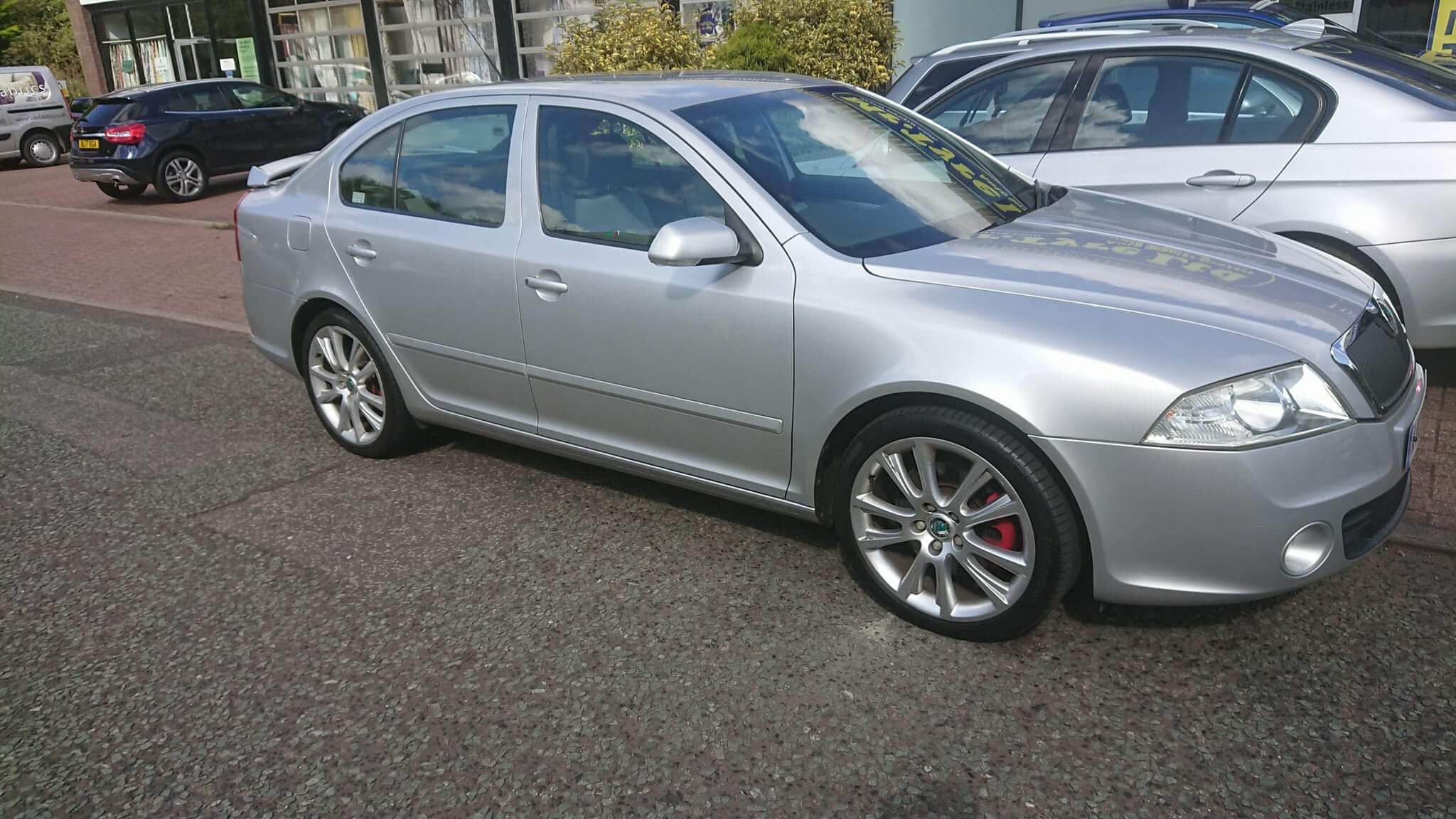

some different alloys while I have the standard ones refurbed
grill blacked out too
