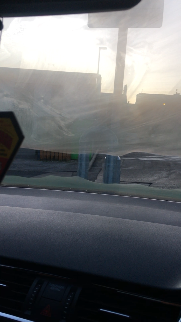

I have attached a picture of how bad it is. There’s literally a strip where it’s been demisted but won’t demist any further
