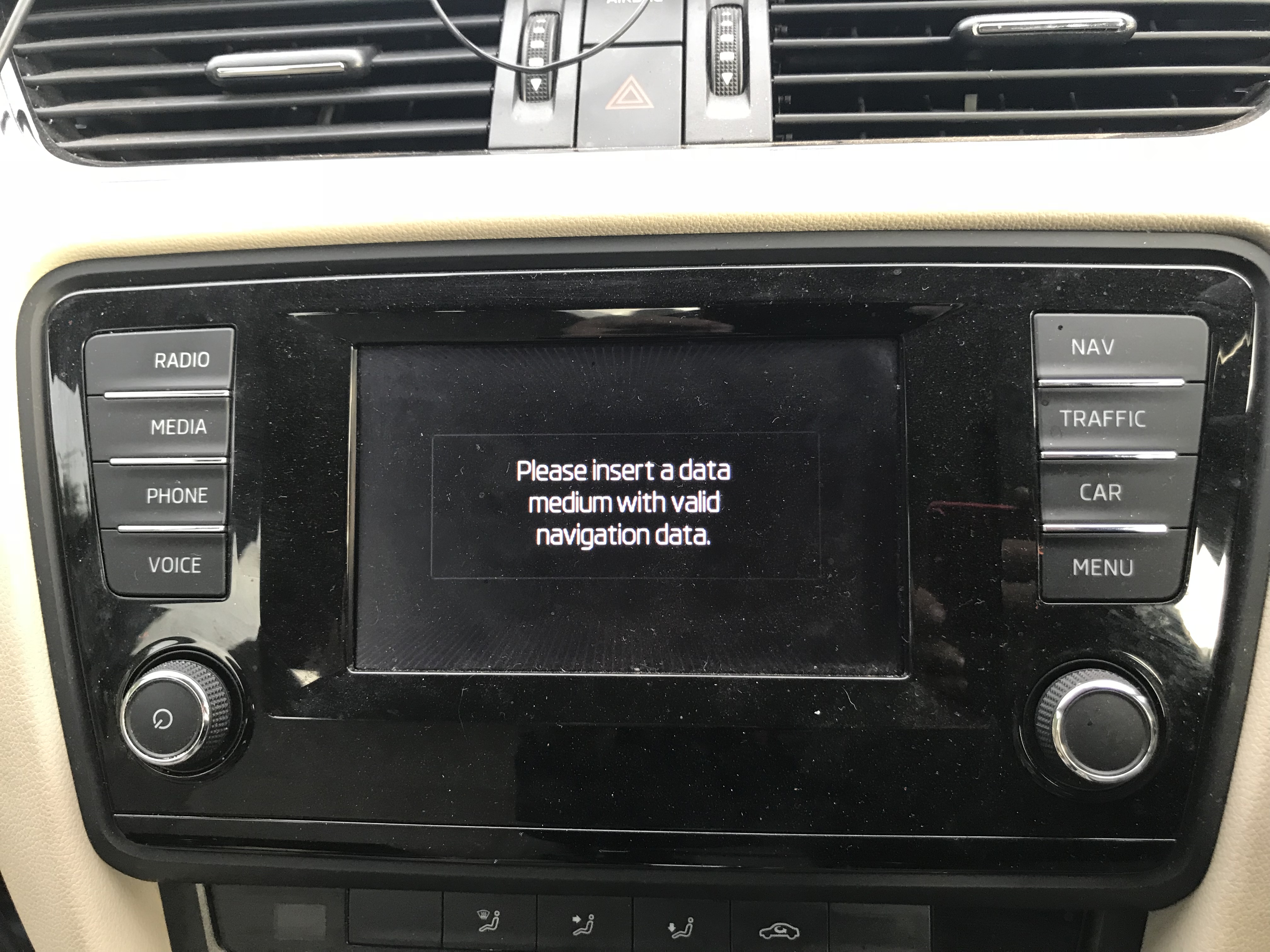

Heres 1 for you lovley lot. My car doesent have the sd card for the on board satnav. Am I correct in thinking there's a sd card and a cd, just a cd or just the sd card?

SD card is all you need, goes in glovebox slot. You MUST use a genuine Skoda one though.

Genuine Skoda SD cards from a dealer cost a fortune, get a genuine one off eBay - I got 2 (one in use with the current maps plus a backup with the previous maps) for around £40 each which is a fraction of the cost from a Skoda dealer.

With an Amundsen anything other than a Skoda SD card won't work - it has to have the buried security data to be recognised as map data.
