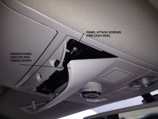

Thank you Urrell. I'll have a look at how to get entry as I do not have the reading glass hatch.
Colin
The reading glass hatch is not touched.
Fold down the flap just below the sensors and microphone for access to 2 torx screws and that drops down.
