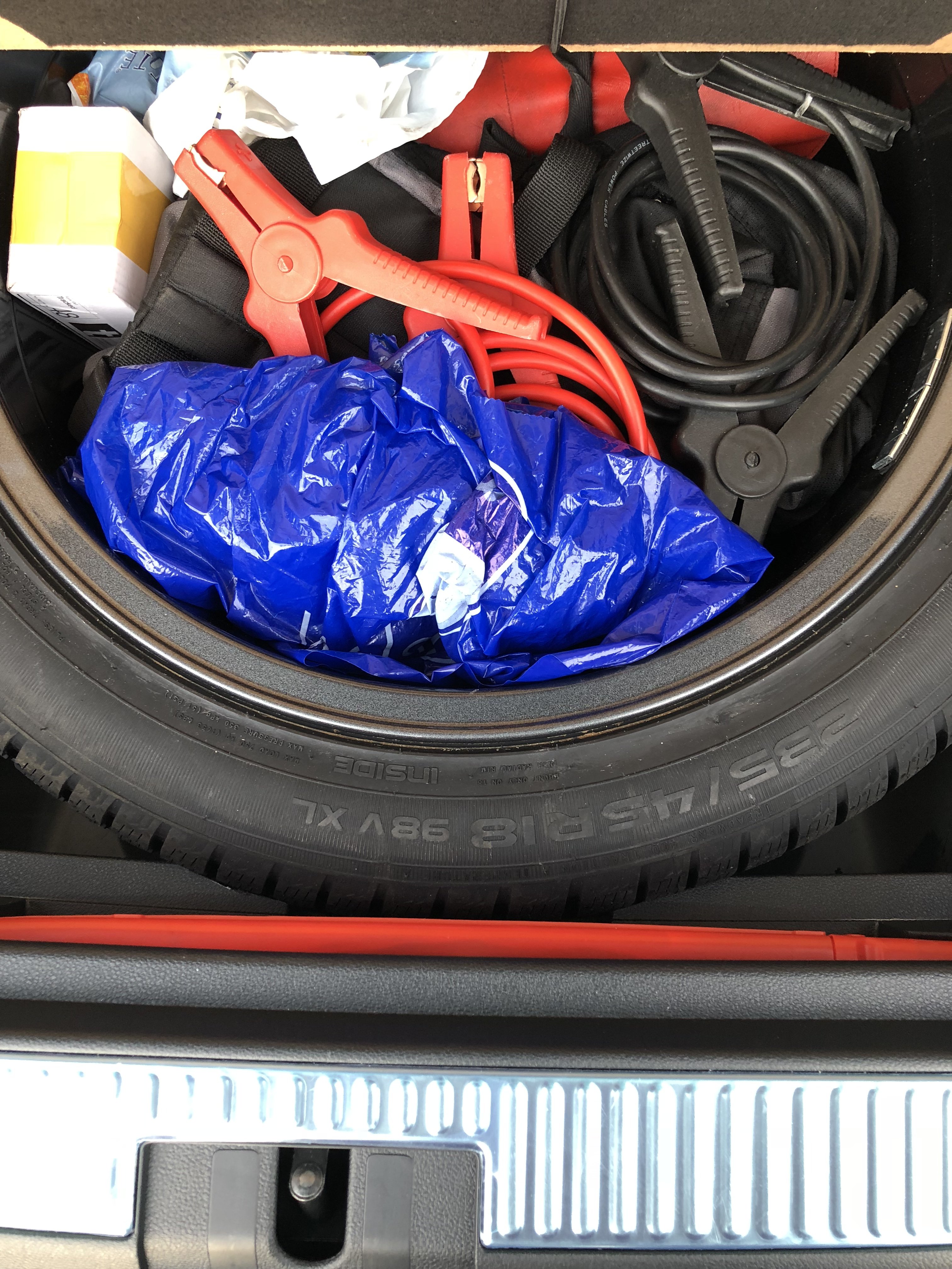

In case you’re interested in doing this, here’s a picture with an 18” Pegasus in the wheel well. I ended up using a Dremel to take about 8mm off the angled parts of the plastic trim at the rear where it meets the wheel. That made it drop into the wheel well easier.
It does sit proud of the wheel well though, probably by about 20mm. Not too much of a problem, the lower boot mat flexes over it and I’ve got the variable boot floor above it anyway.
Oh, and the dense polystyrene tool store won’t fit into the wheel so tools need to be put in a bag or something to stop them rattling (much more space for carrying more crap though :D)
