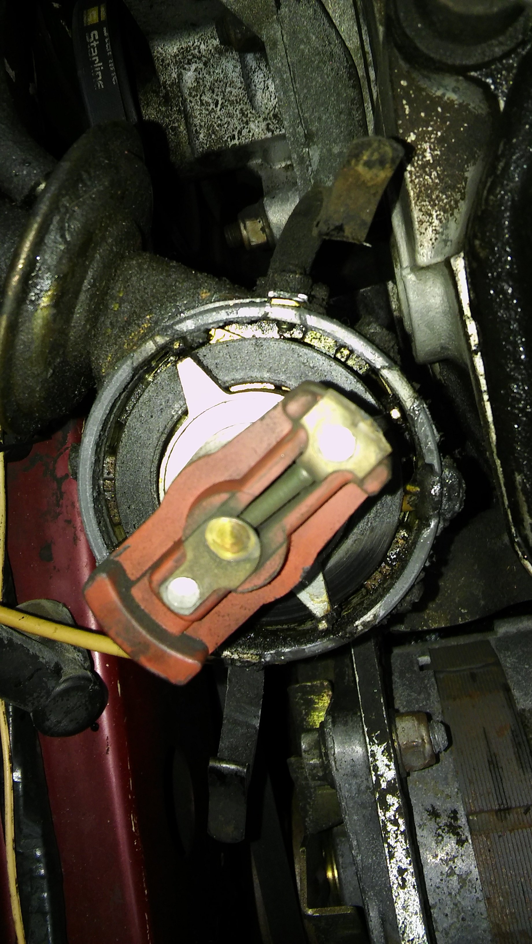

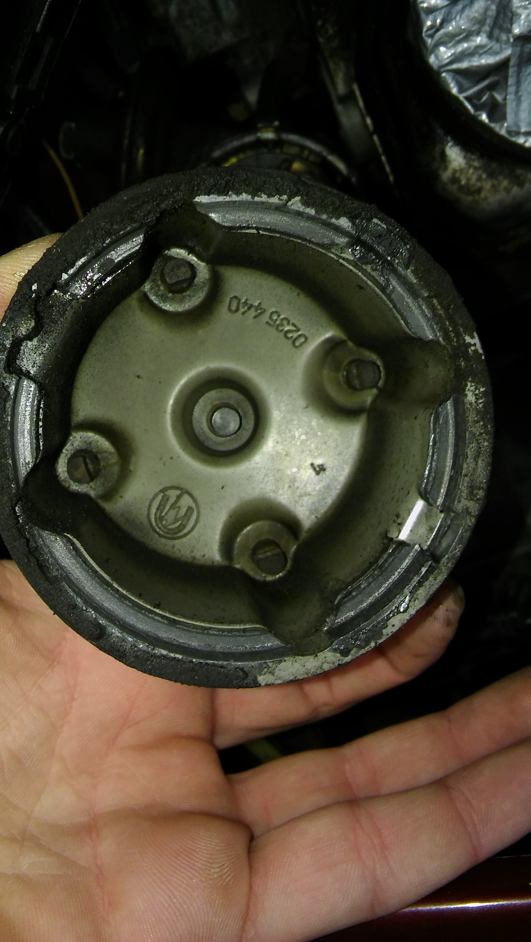

Seems like oil got inside the distributor and it made a mess in there. I didn't get any nudges while driving and imo the engine doesn't run that bad, there's just a slight rattle probably because of the chain.
may be come up the driveshaft  because of crankcase pressure  just clean up---- and check the breather system is working OK
