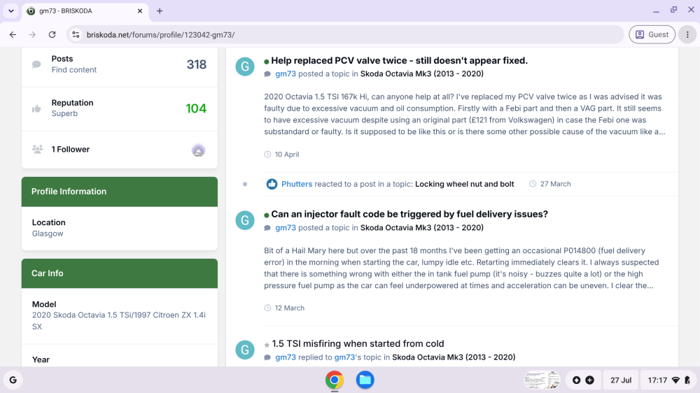

@wiilydog , sad to say that I've just seen that YouTube video about that issue, ie after roughly 80,000miles expect it - horrible!
Quite a history of issues up to this.
