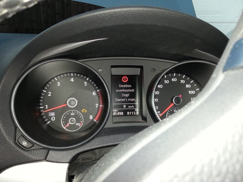

In December, I had my vRS serviced.  During the service, the garage carried out Service Campaign 34F7.
When I got the car back, I was aware that gear changes were not as they had been before the service but put it down to the ECU having been reset and its "re-learning" my driving style.
A day or two before Christmas, the car became positively dangerous. When moving off on roundabouts or at a road junction, the car would "hesitate" and then lurch forward violently - the first time it happened I thought someone had rear-ended me.  When moving, the gear changes happened normally. The Orange "engine" light came on but the car did not go into limp mode
I returned the car to the garage, they diagnosed a faulty sensor and charged me over £200 to replace it.
Personally, I believe that while servicing the car they broke the sensor or failed to reconnect it properly - I have no way of proving this.
I will not be using a "Skoda Approved Dealership" again in a hurry - I can take my own tea or coffee in a flask.
