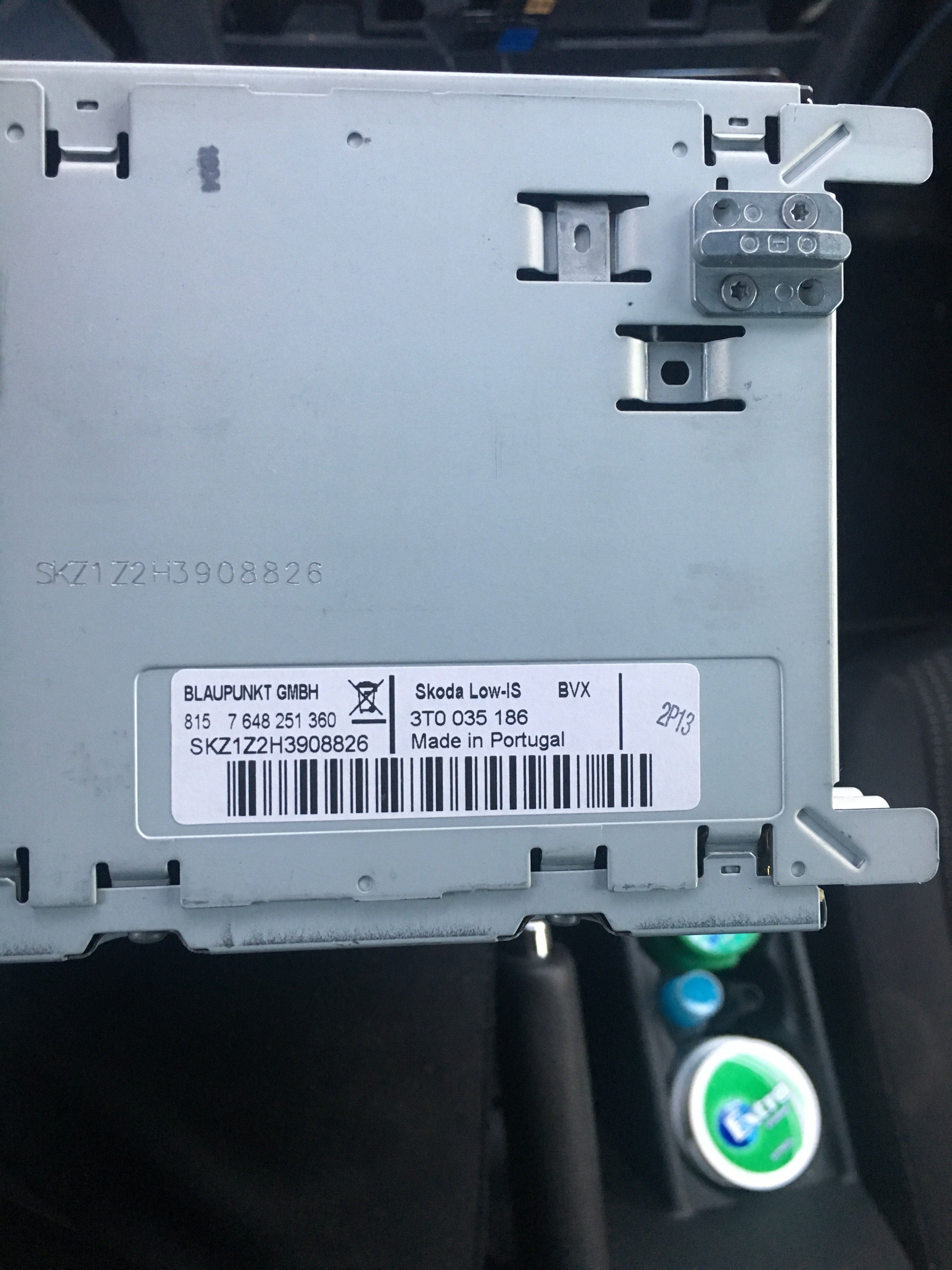

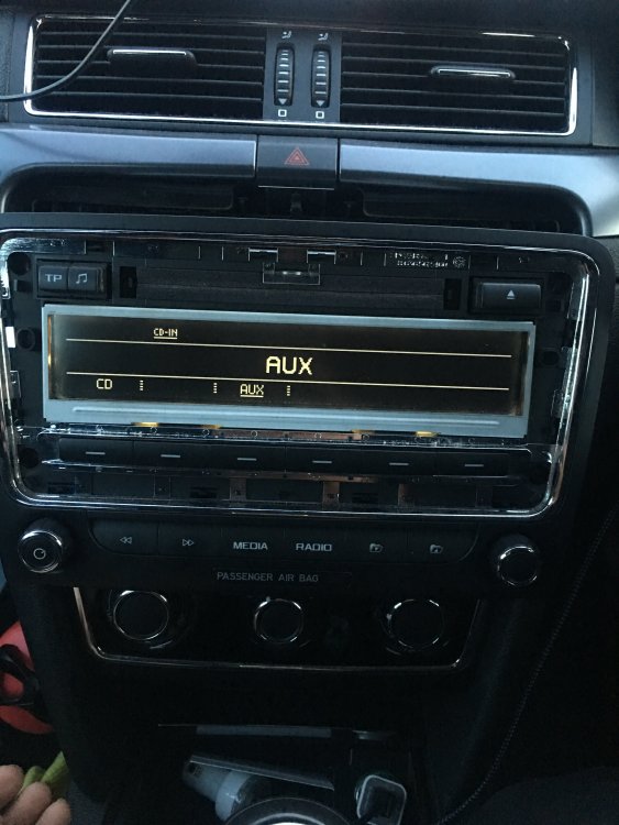

I have swing mp3 radio installed in skoda superb 2009. I am looking forward to install Bluetooth usb adapter. I have tried searching these modules can be installed by just repalcing original 12 pin adapters that comes with the module. The problem is sellers say adpaters connects in place of external cd changer socket at the back of the radio but I have no external cd changer installed. Nor there is any option to switch between aux and 'cd changer' as there are only two options cd and aux.
Is it possible to activate cd changer option by vcds?

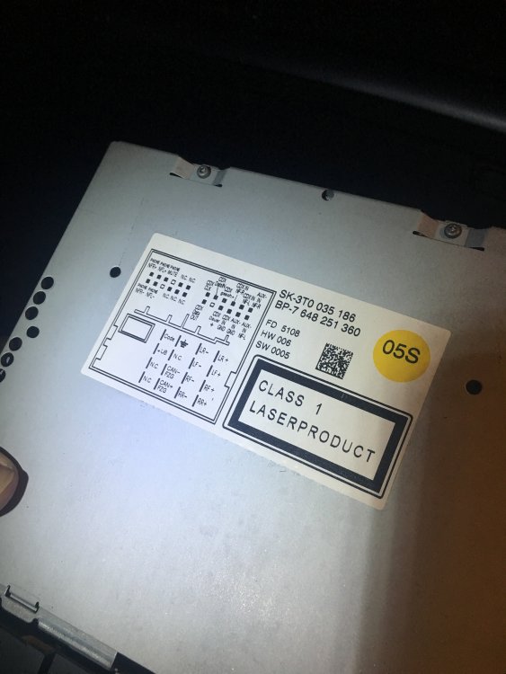

Please see photos and if someone can also throw some light on what is cdx means on the radio circuit diagram.

short answer is no this cannot be done - older radios  with external cd changers - you used to be able to use this for an external 3rd party input (aux in etc.)
Depending on what you're trying to do
you will need a bluetooth module and associated wiring
or
hard-wire in a USB  socket

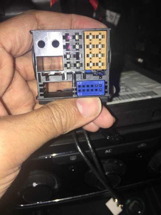

This is the module I want to install. If its possible?
http://www.ycarlink.com/pd_10513_Digital-CD-changer-USB-SD-AUX-Bluetooth-interface-for-12pin-VW-Audi-Skoda-Seat-Quadlock.htm
It always used to be the case that when you plugged either a CD changer or an adapter such as that into the CD changer interface they just worked without any coding changes.
Not sure if that's still true though may be worth trying if you're up for it?

I tried to change aux in pins (left, right, gnd), from the quadlock adapter, to cdx in (left, right, gnd) to see if any cdc option appears to switch between aux and cdc, in the radio. But nothing.
