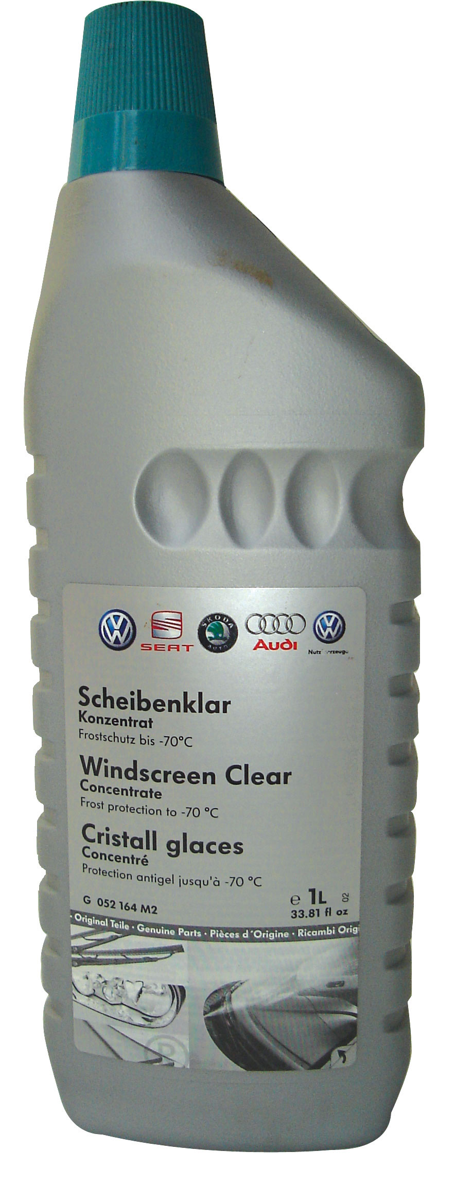

The vag screen wash I get from the dealers has on it in pictogram form 4 :1 for summer use 2:1 for -16*c 1:1 -35*c so you may want to take another look at your bottle. My washers don't freeze using the recommended mixes.

 I only use the genuine   Fabia screenwash  from the main dealerand mix it very carefully using a calibrated jug  with ratios I part  concentrate to 4parts  water. That is supposed to be good down to minus 16degrees C.
Yup, wrong mix! Pull the front label on the bottle open to see instructions
4+1 -> Summer use
2+1 -> -16 deg C
1+1 -> -15 deg C
