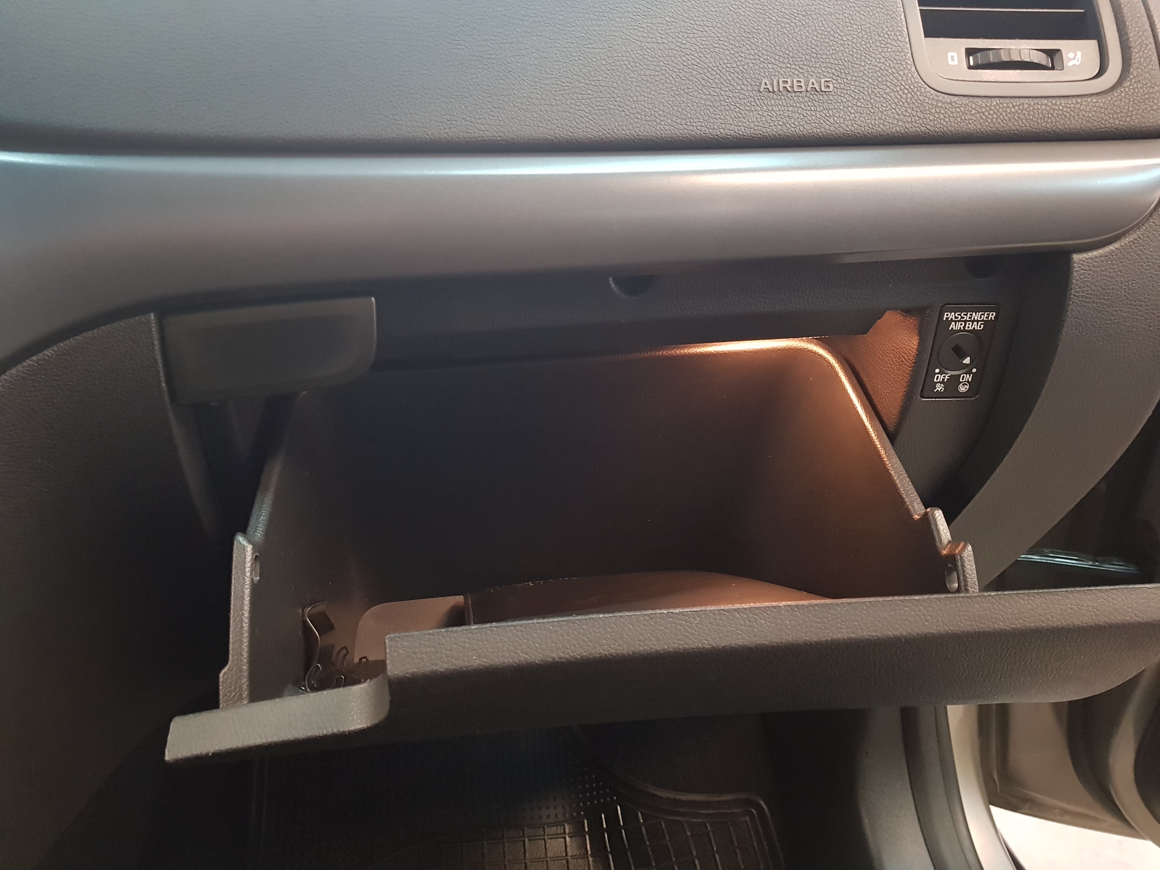

I'm a bit unsure of removing the glove box because of the passenger airbag switch.

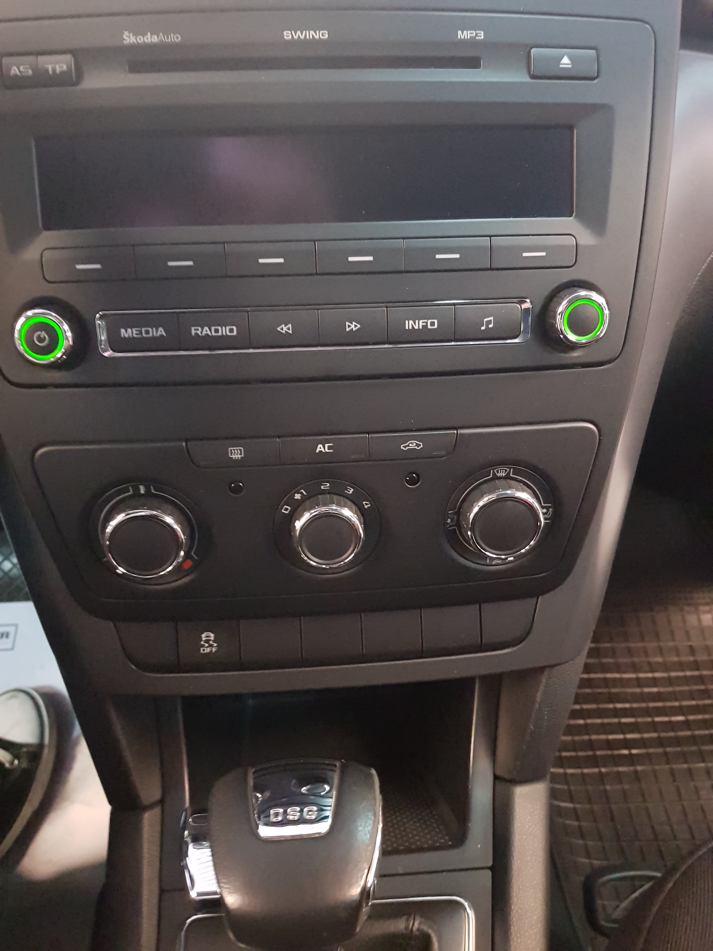

Maybe the storage space by the gear lever?

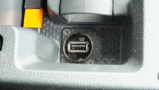

Other option (also using the Neutric through-panel connector) that I used on my Octavia is the centre console/armrest. But I'm guessing if you've not got a lidded centre box you'll not have the armrest either

Not massively; however thinking about it if you want to keep it simple, running the USB cable lose into the glovebox is probably the best bet.
Once you've got the trim off that surrounds the Swing and the heater controls and taken the Swing out, it should be fairly easy to route the USB cable into the box.
What you might struggle with is getting to the connections at the back of the radio without taking the glove box out. It's been a while since I did it
Can't you install it on the bank of switches below the radio - where the tyre pressure measurement switch  and parking "beeper" switch are sited? Should be easy to get to and that is where Skoda put the USB socket on models equipped with it. You might even be able to get the OEM fitting from Skoda to make a really neat job of it.

On my car the USB and 3.5 sockets are on an additional module in the top of the small cubby hole below the switch panel.
You are probably right - I will check tomorrow morning.
