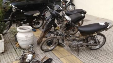

One of the scourges of Greek roads are abandoned motorcycles. Some they have suffered major damage and are not being repaired, some because owners have abandoned them because they no longer want them, other they are stolen, etc.
The process to be removed from the from the State takes from 3 months to 3 years. All of that time this motorcycle it pollutes the environment and also takes up parking space. You can't park your car because such an abandoned bicycle is standing there often rotting and some of them are on the sidewalk !
Some sneaky locals use them to reserve space for themselves, some with shops put them in front so that no cars are parked and the storefront is not visible, some Cafe owners put them in front of the sidewalk to make it appear that they have other motorcyclists as their customers. If you try to remove it by yourself sometimes they shout ''leave it as is, it's mine" and other lies so you have to wait for the Municipality to take it or you have to act by yourself with other ways.

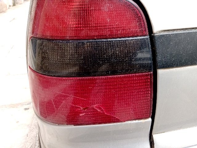

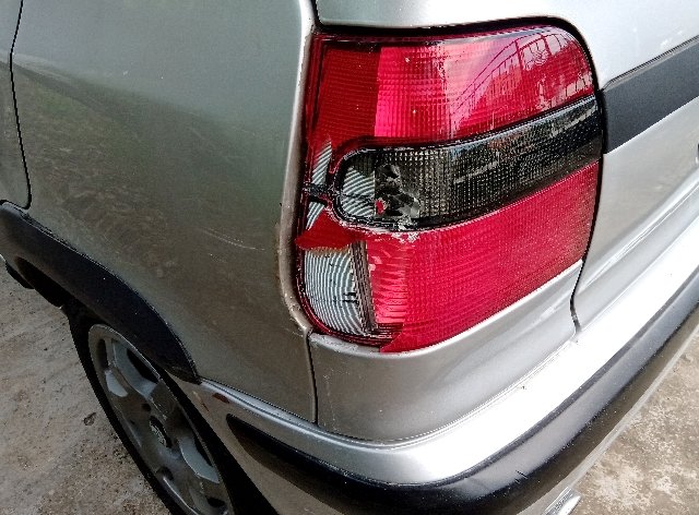

Few nights ago we had mud-rain here, i was returning from work it was late, i was tired and i wanted to find a place to park my car to go home. I found one but there was a huge scooter which didn't allow me to park properly, was sone of the ones that i have described you above. Came out of the car, tried to move it a bit but was heavy, i was sin a hurry the ground and my hand were slippery so the disaster came. That damned scooter rolled back, i didn't manage to catch it at once so it hit my rear left rear light (or tail light), a ''craaack'' was heard and immediately i knew that i was in trouble. Chane my day schedule, search to find another, pay money which i had for other purposes, install by myself etc.

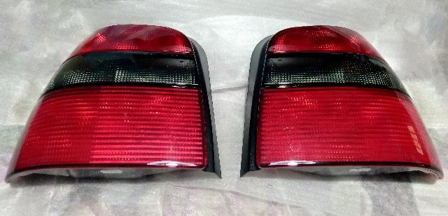

I have changed them both in the past with original Hella and i knew how to do it but in the procedure i notice 2 weird things that's why i opened this topic.
I didn't want to install an aftermarket one because:
there would be difference in colour with the original on right side plus they have told me that due to cheap ABS plastic and not proper molding may not fir proper and water could come inside the trunk so i start searching for original in good condition.
3 shops and nothing happened, i was disappointed because the cost for 2 new original fro UK would be around 120 euro with the shipping-Customs fee (not in EU any more) and i didn't want to order a used one from local market without see it first because in the photo of the e-shop looks good but in real may differs.
In the 4th shop (VW group parts) told me that they have new aftermarket for 30 euro and new original Hella for 40 euro, i was surprised and i asked: How come? They answered that have them in shelf for years and offered them in a good price to get rid of them.
What's the reason to pay to have one new and one used? So i bought two of them (left-right side), in front of me brought the box cut the seal-tape and show them to me.
I paid and went home very happy.

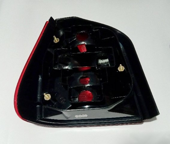

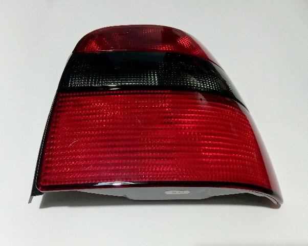

Here are in factory wrapping

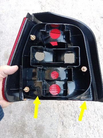

but when i went to the car to installed them i noticed some things.

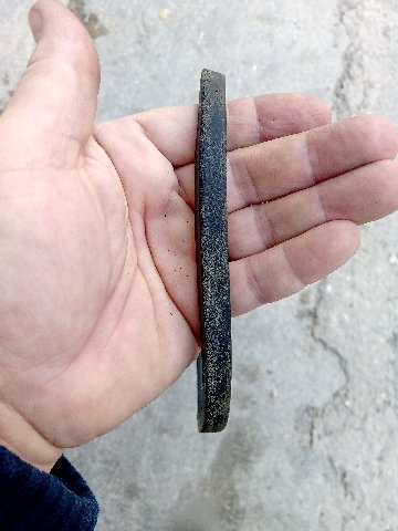

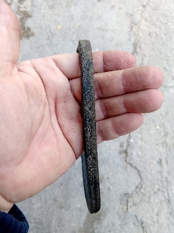

As you can see the original had no gasket so i had to use the one from the existing.
The left side was good but the right side had some marks of deteriorating.
which means if there is another accident and try to remove it it maybe cut in pieces of became as ''toast'' as we say here (many pieces like detritus).

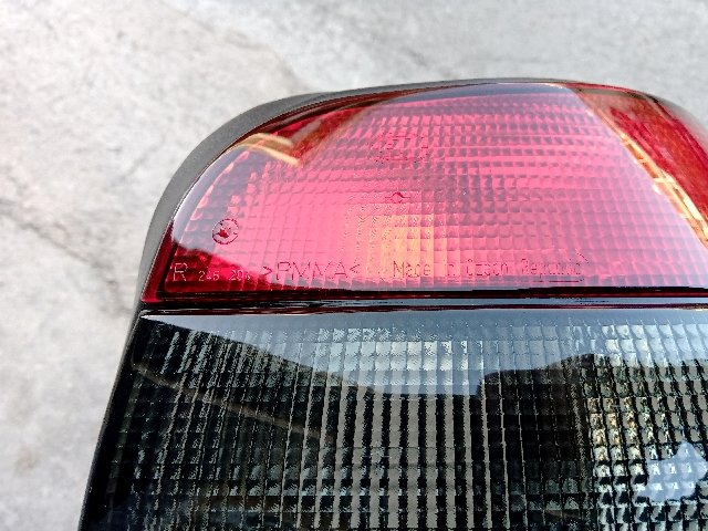

As you can see from the factory they have used hot iron to ''erase'' the Skoda Logo and the part number, the question is why?
They have the stamp Hella made in Czech Republic other letters as PMMA, marks etc as the previous but why they ''blurred'' those two things?

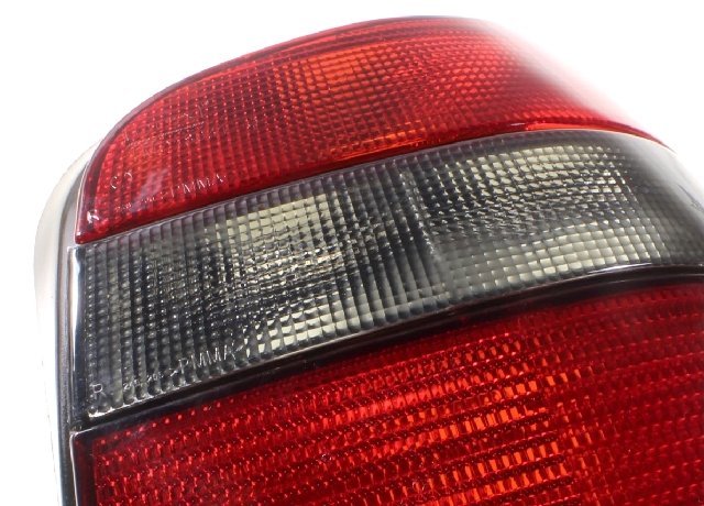

Take a look a Chinese from Skoda-parts.com half the price of here in GR (in UK shops the original has 51 euro).
https://www.skoda-parts.com/data/items/352/5fa278cc01ba2_xl.jpg
Has a gasket on
https://www.skoda-parts.com/data/items/352/5fa2808f140ab_xl.jpg
plus the PMMA letter, the mark from the molding like the original etc.
https://www.skoda-parts.com/data/items/322/5e2eb66ae69a9_xl.jpg
isn't this strange?

Perhaps the contract for Hella to supply VW expired so marking not allowed and need to remove(?), Hella is big enough not to want to upset the likes of VW. China can make enormous profit and still sell items at very extremely low prices whether it upsets any company or not and VW were desperate to be in China, who will soon own VW no doubt.
You can make up your own seals, it's not like you remove the light cluster very often either.
I've seen this before on INA tensioner for my Cordoba. They grinded away all VW markings, because it was not sold as a genuine VW part, but INA-branded part.
I have seen this in the past with Maserati parts,exactly the same as in a Ferrari but more expensive, the same with Bentley parts which are exactly the same with a VW model (since VW owns the Bentley) but also more expensive !
Almost identical.

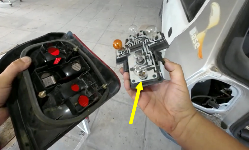

As for the record: There is a weird thing that happens every (i mean it every single time) had been a modification to my car's electrical system.
After this the bulb of the rear brake light (right or left) does not work,looks like it' burned.

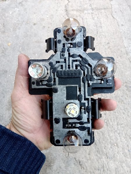

It's position is where the arrow points (photo from internet).
The first 2 times i thought that some sort of short circuit happened but the 3rd time i discover that the solution is this:
Take off the bulb,turn it 180° degrees and put it back,it works fine as it should be !
Why this happens? I don't know but after every major electrical repair or installation i look the mirror while parking and i see only one bulb lighting from the reflection to the wall, then i know the drill.
It's a dual filament bulb. If you rotate it by 180°, you just swap broken brake and tail light filaments. The problem is,that brake is 21W and light is 5W. It shouldn't be possible to swap it like that without significant effort.
^^^ because the locating pins on the side of the lamp base are offset - it should not be possible to fit in incorrect orientation without forcing (and damaging) the lampholder.
Correction: 360° degrees, in 180° degrees does not fit (i learn this many years ago).
The first years i didn't had this issue, after messing with console modifications-extra lights etc this phenomenon came-up so every time i finish a modification i know that one of these bulbs needs to be removed-make a full twist and installed back.
Why this happens? I don't know...

I scratched the rear bumper, the rear left wing and I also broke the brand new taillight. Today I went and got a new one HELLA and took the car to the body shop for painting.
