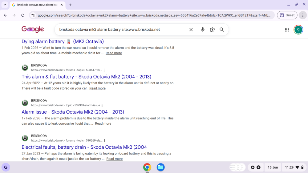

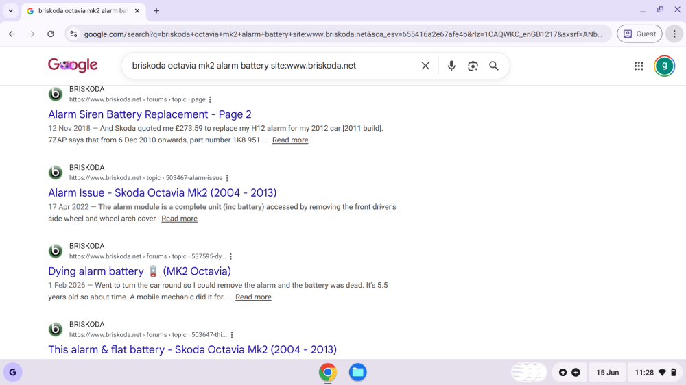

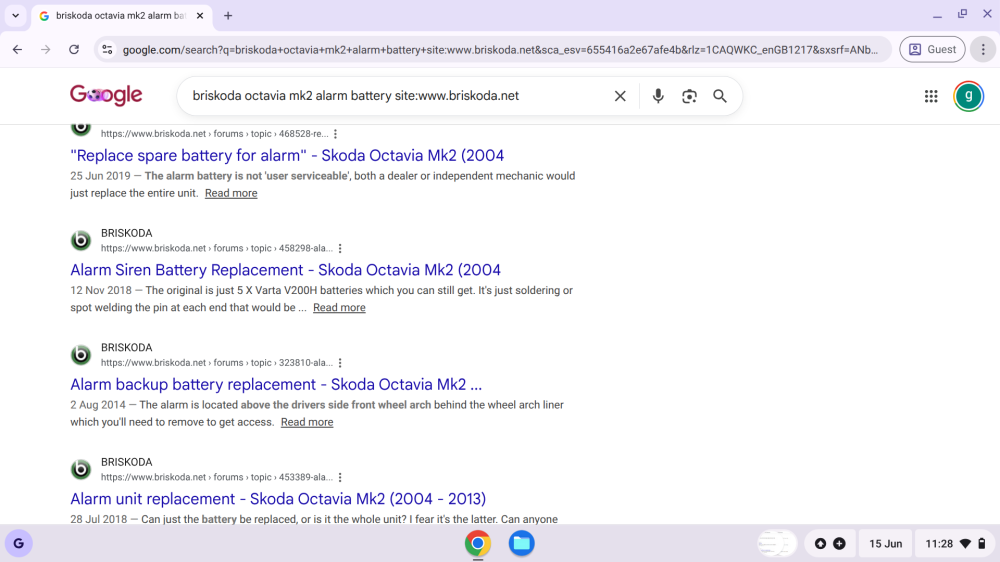

Edited by Evolution13
So it's time for a competition "who's alarm battery lasts longer from which brand-model and which location-enviroment temperature".
This will take some years to complete...
@D.FYLAKTOS Just relevant if the Mk2 Octavia Siren Battery might be more like a Mk2 Fabia's which might be as low as 8 years & needing replaced or 16 years old and still not as issue. The Alarm Siren showed in the Service Book as a replacement item at 5 years. Skoda / VW Group were the ones publishing the @ 5 year crap. & replacing whole units. You would have thought that they would know that they had fitted ones to cars already that were going to be good for 25 years.,,,,,,,,,,,,

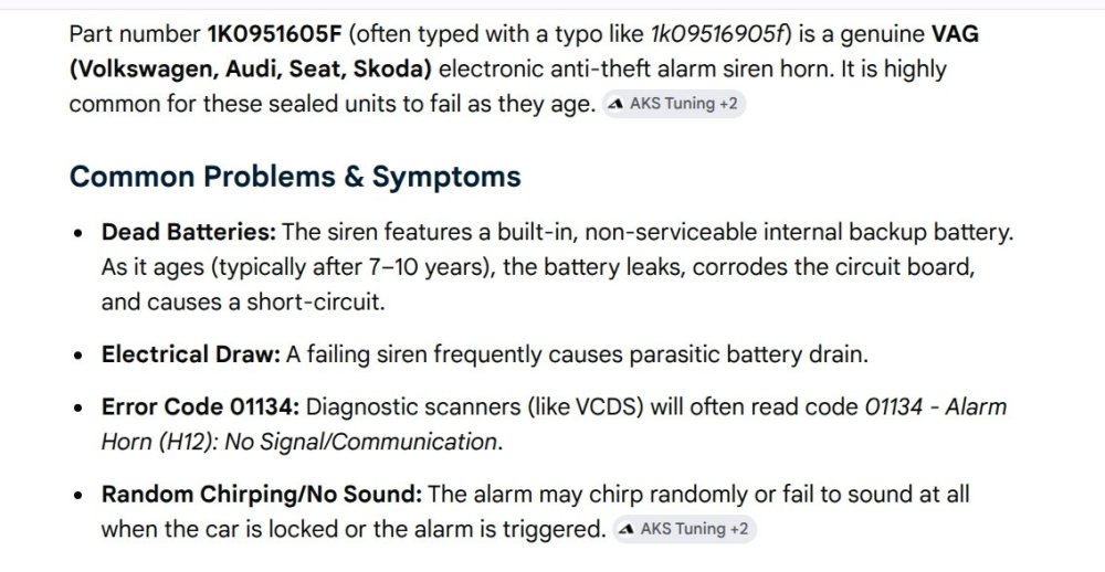

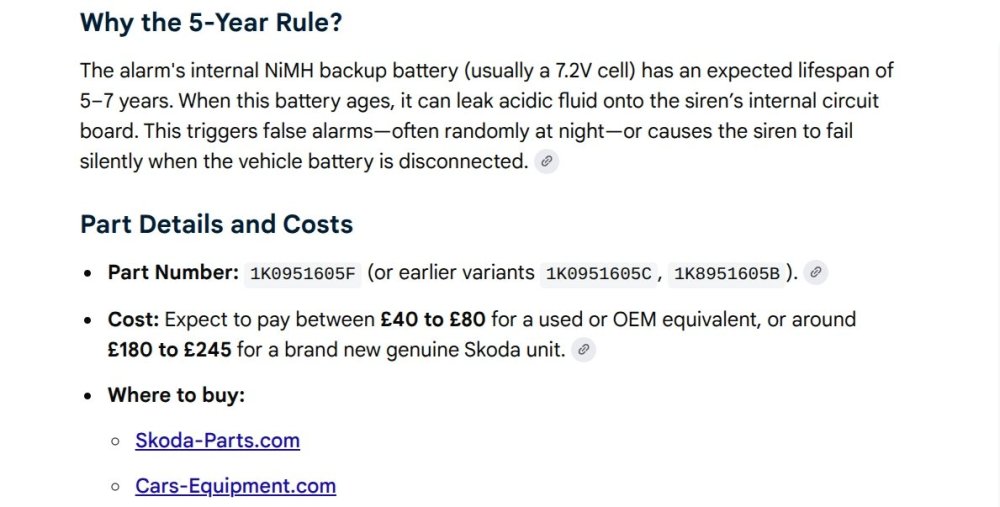

OK, "case closed" otherwise the @somean49 thread will ruined.
I would recommend buying a new alarm unit as others have found that the secondhand units have come from old crushed cars sources or other sources and only last a short time.
Once you start to have alarms at random, you will not be popular with your neighbours. The internal battery is NiMH and cannot be replaced by a LiPo or Li-ion battery.
