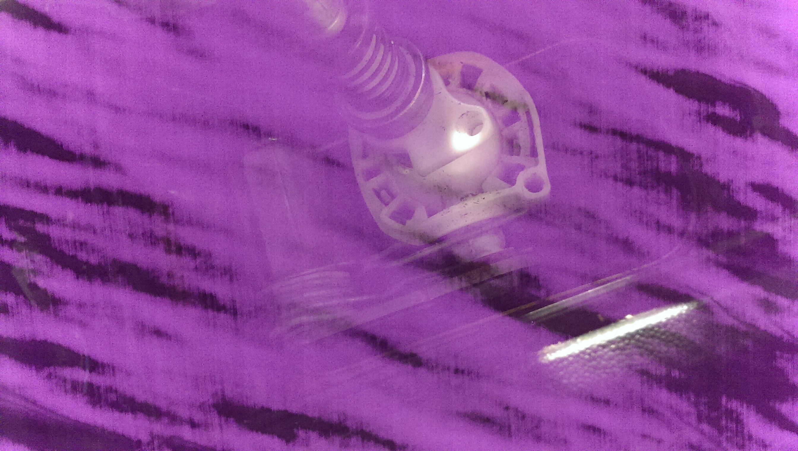

Sorry about this useless picture but my camera is old. Im in the process of replacing my gear shift with a b&m one, but i am unsure about how to  disassembly this unit. How do i disconnect the shift arm pivot (retaining clip?)? Iam also unsure about the plastic pivot bushing, normally i have seen a top plate with torx screws but this one looks different.
Grateful for any help :)
The ball pivot is too large,, instead i need the older design shift mechanism, as you can see here they changed from this:

 too this (as in picture above):
http://workshop-manuals.com/skoda/fabia-mk1/power_transmission/gearbox_0a8/gearbox_mechanicsoperation_constructiondiff./repairing_gearshift_lever_and_shift_housing/repairing_gearshift_lever_and_shift_housing_as_of_06.06/
My 2007 vrs has the newer design. Thanks to Dark_hero Charlie i know that the old design is a straight fit, as a friend to him had done the same to a SE- version.
I have found this 2006, 6 speed POLO gear selector https://www.bildelsbasen.se/?link=item&searchmode=3&query=6Q0711061&post_id=19088047 (its in swedish) but all information they write is: 6Q0711061. However am i right in saying this is the old design shift mechanism iam looking for, shared between VAG cars and also the VRS, or am i missing something?
