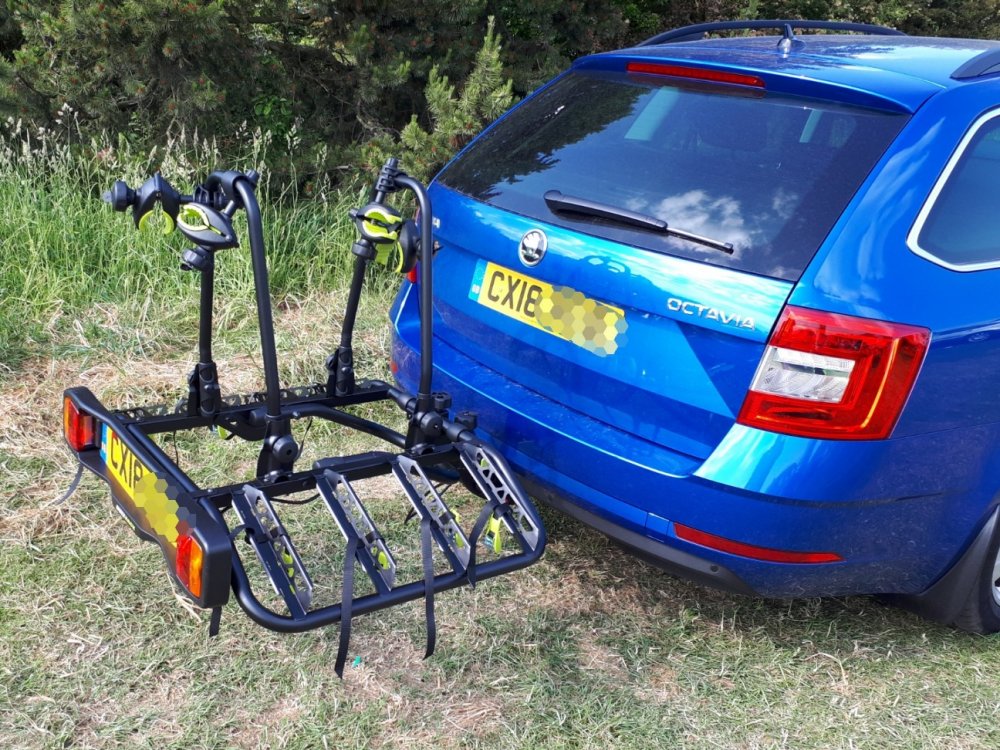

I've got the BuzzRack Quattro now - I've fitted and tested but not used it yet. Fingers crossed for this weekend.
I did try the BuzzRack Buffalo first as I like the idea of it folding out of the way whilst parked; but I couldn't work out the jigsaw of getting our 4 bikes on, and two of them needed false crossbars which I didn't facncy.

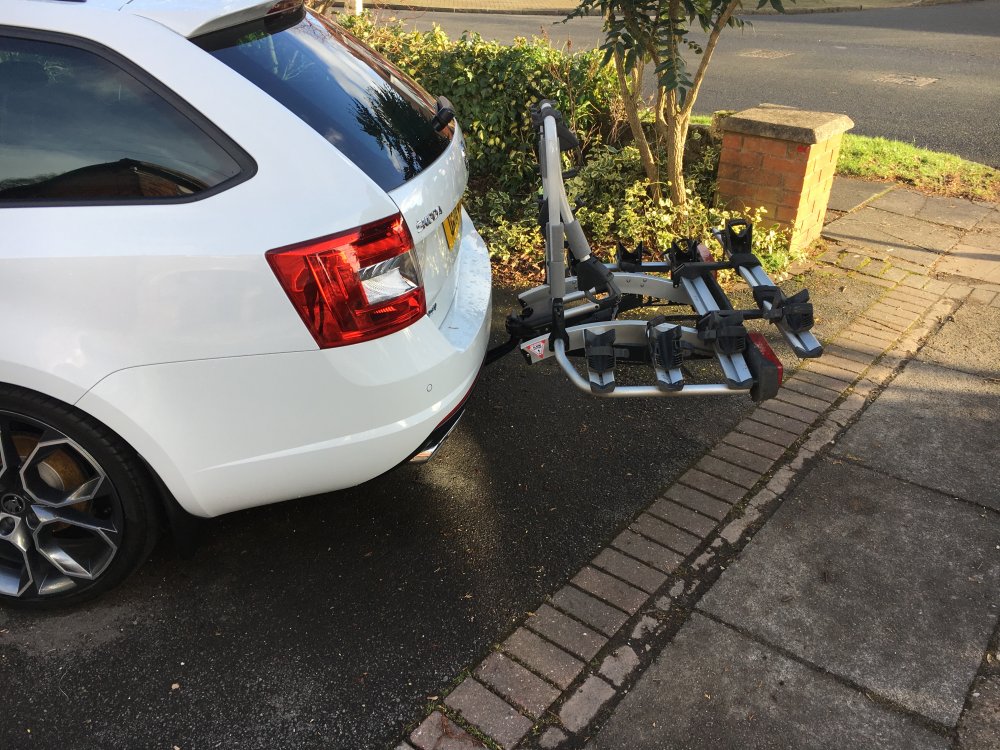

I also have an Atera Strada with 4th position (like white car above) fitted on my current Astra (waiting for my new Octy with factory towball). It actally came with a couple of extra straps to clip over the top of the boot and tie to the frame of the carrier - this would be good for helping to move the CoG closer to the car, and helping stability. The instructions stated that they had to provide them but their testing proved they weren't strictly necessary, so I've never used them.
I'd recommend it as a good carrier, straightforward to get the bikes on and off, and easy to get on and off the towball. More pricey than alternatives, but if it's too much hassle to use it might not get used as much.

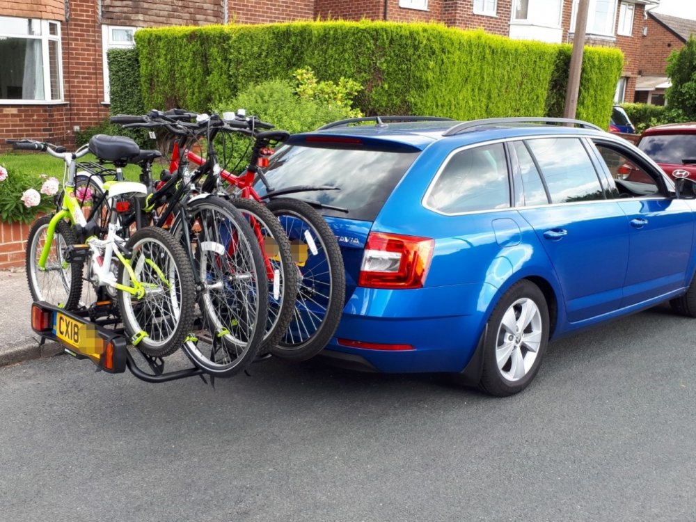

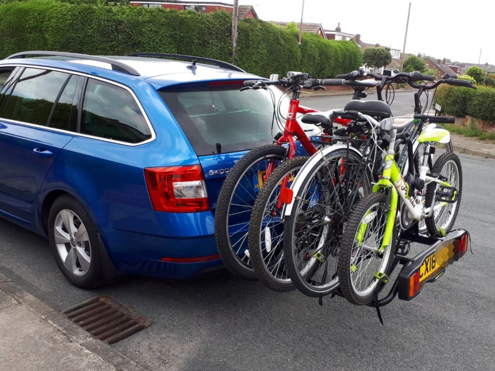

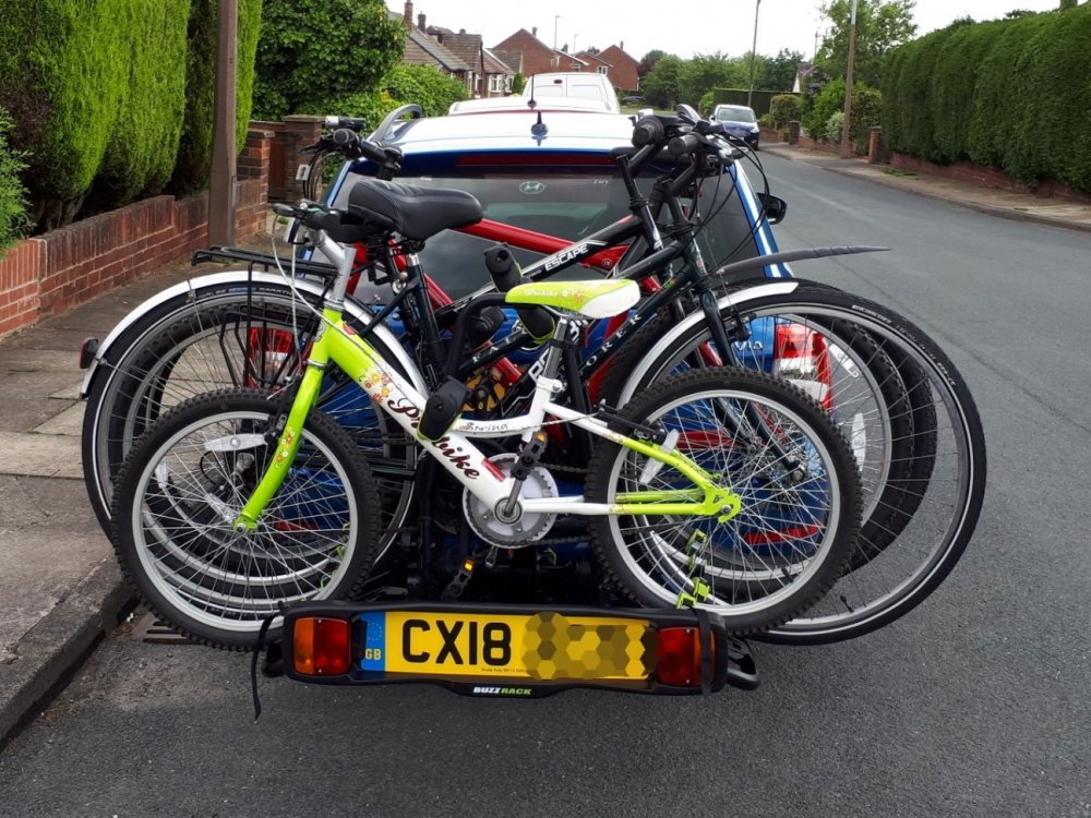

Used it for the first time yesterday, all seems fine. Took a while to get the bikes on the first time, but already quicker on the return. Impressed by the sturdiness of it - good value for money.
