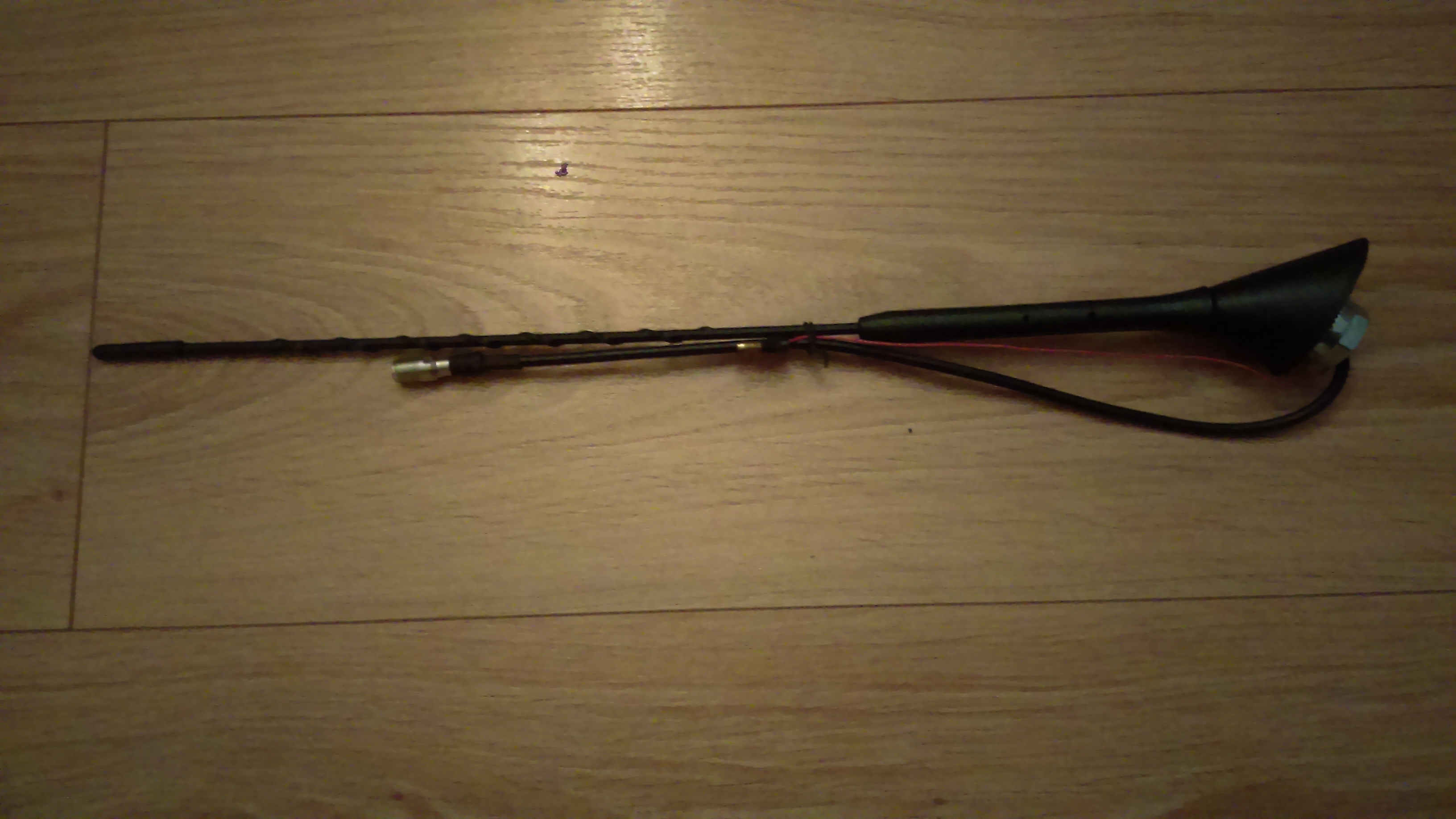

Gonna stick it up on the free stuff classifieds, but not sure if it will go on any mk1 Octavia, or is it, as i suspect... For a mk2?IMAG1189.thumb.jpg.a90096f5380251ab526d79b44e03e1cc.jpg

it does look like a Mk1 aerial from the ribbing (oo-er missus). What was the difference in the connector?

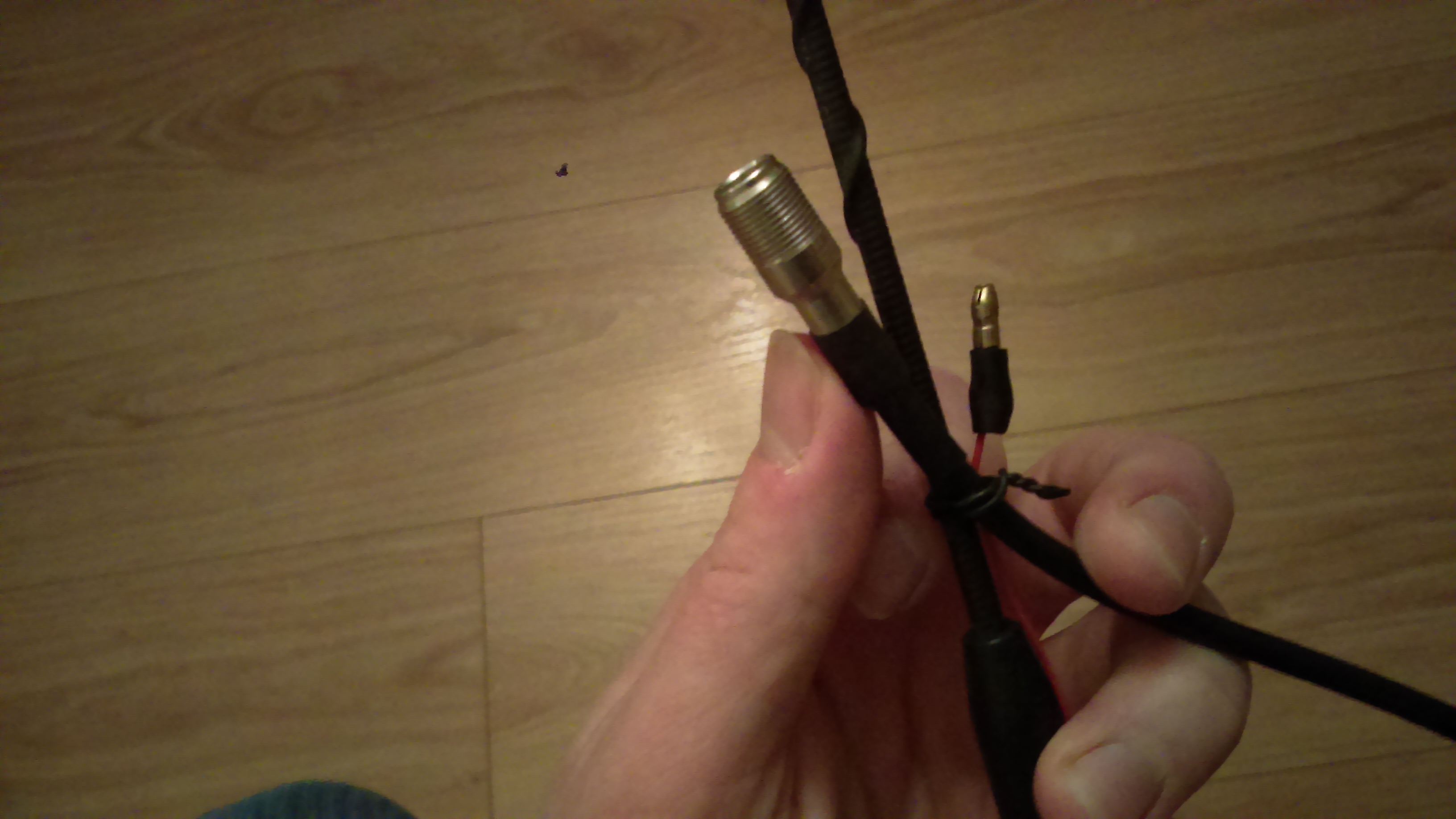

Mk1 aerial on my bus had no second connection, the little red one - im guessing its an amplifier feed, which is built into the h/u on standard mk1 radio, which was why anyone with an aftermarket h/u had to 1)repin he fixed vs switch live and 2) live with possibly crap reception due to the lack of a booster if add your own one.
Also the connection is a screw in jobby, where mine seemed to be just a push plug (im thinking back 15months.. might be a bit hazy :D )
With that external power? lead its not a genuine VAG aerial the second screw connection will be for a mobile phone connection

The small plug doesnt heavy enough to be the radio antenna?
The screw connection making more sense ? Neither lead would go into my cars connector.

My 2003 estate had the wiring provision for the armrest mobile phone along with the dual aerial the normal radio connection was a standard plug and the mobile phone was the small TNC connector but the power for the inbuilt amplifier was via the normal radio connection no external connection
