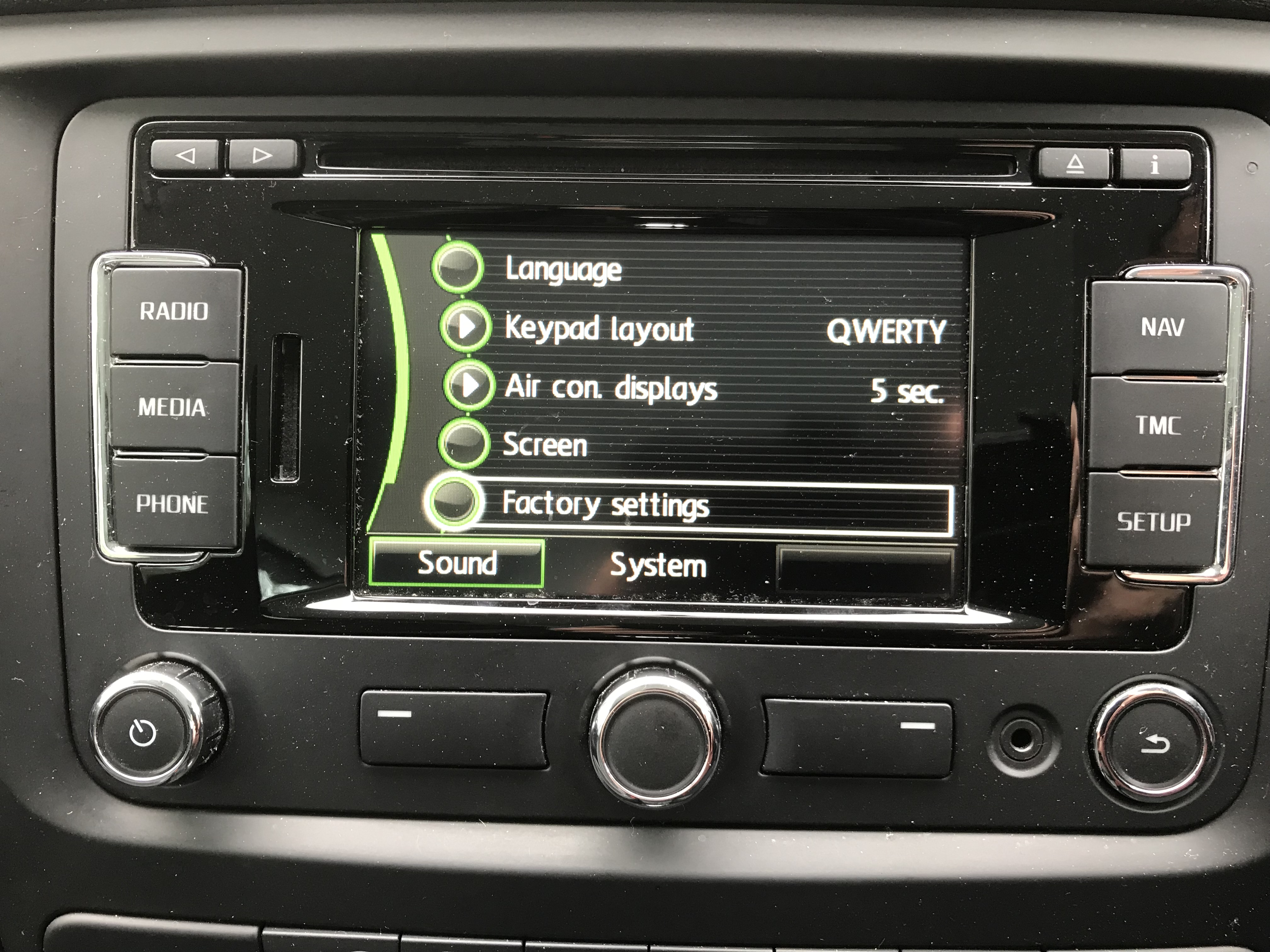

I may have a solution to the v10 reboot issue, but more data is required to be sure.
I did a factory reset on the unit and it's hasn't rebooted once in over an hour of use.
I'll keep testing, but can those of you with the reboot problem perform factory reset on you RNS 315 and report the result ?

Hi, I tried this, with no luck I'm afraid.

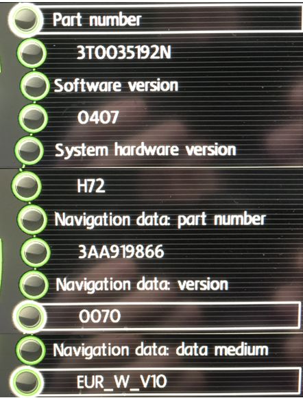

Could you share your RNS software and hardware versions, we may see why resetting has appeared to help me and not you:
From my RNS 315:
PART NUMBER 3T00335192N
SOFTWARE VERSION 0407
SYSTEM HARDWARE VERSION H72

Can everyone who has upgraded to V10 share their hardware and software versions, and state if they have a reboot problem or not. It may show why some have issues and others don't.
Additionally do traffic reports work after the V10 upgrade?
My systems was rebooting but after a factory reset on the unit I haven't seen another reboot. Still testing.
Edited by gjscott
Software 0324
Hardware H59

I had a three hour drive to a holiday destination and the reboot occurred only once.  On the return journey, five reboots of the satnav, sometimes with the destination address lost, other times the route would continue where
To continue : it had been interrupted by the reboot.  I tried the "factory reset" without success as it rebooted within a few minutes of doing so.  I have yet to contact satnav_ukdirect , ebay, or paypal to see what they say and am just tolerating the infrequent but annoying reboots.
My versions are   Part number                           3T0035197A
                               Software version                    0500
                               System hardware version     H80
the rest is identical to gjscott illustration

Looks like my factory reset didn't fix it.
