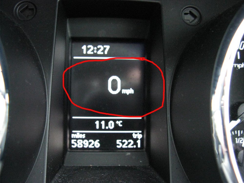

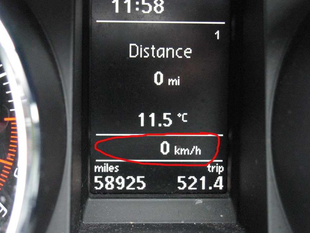

Thanks to gizmo MY12 Yeti now thinks it's in Australia! For those interested in the legals, the Yeti analogue speedo doesn't have the markings you usually find around the dial. Therefore they have to provide it in the MFD if the requirement is to have both displayed? However, if you recode the instrument display with vcds to Australia the default MFD still shows km/h as before. The key is the last step: After coding, a new option appears in the MFD settings under ALT(ernate) speed and distance checked by default. After re-coding you remove the tick and get the huge digital speed display in mph.  Should you wish to drive in a km/h area you just go to MFD /settings/ALT speed & distance and tick the box. Whatever the arguments are for and against and acceptance of car speedo errors, I think this is a big improvement.

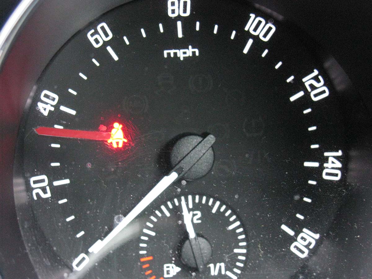

I attached a photo of the analogue speedo with 30mph marked by my red tape line. The photo is taken with the camera lens square to the mfd and the marker looks in the wrong position. But when sat in the higher seat position it looks correct. This is the parallax error I was talking about which you don't get with a digital speed display.
Where’s the 30 numerals,how can anybody drive without seeing them ,more red tape I guess
