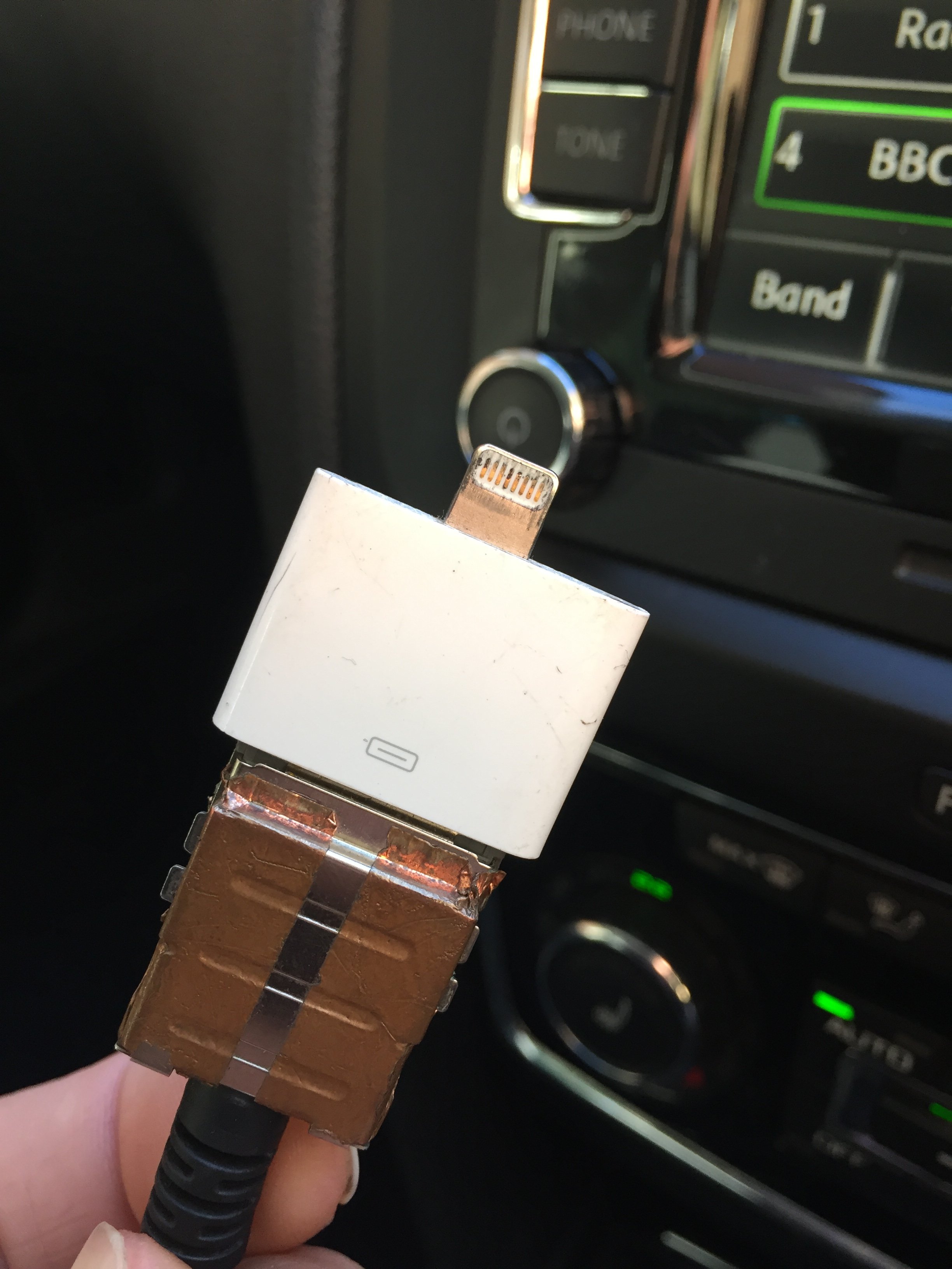

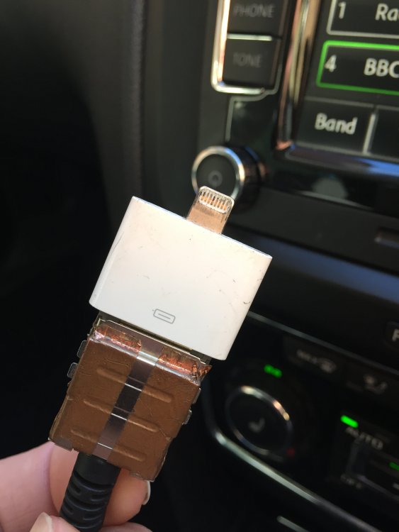

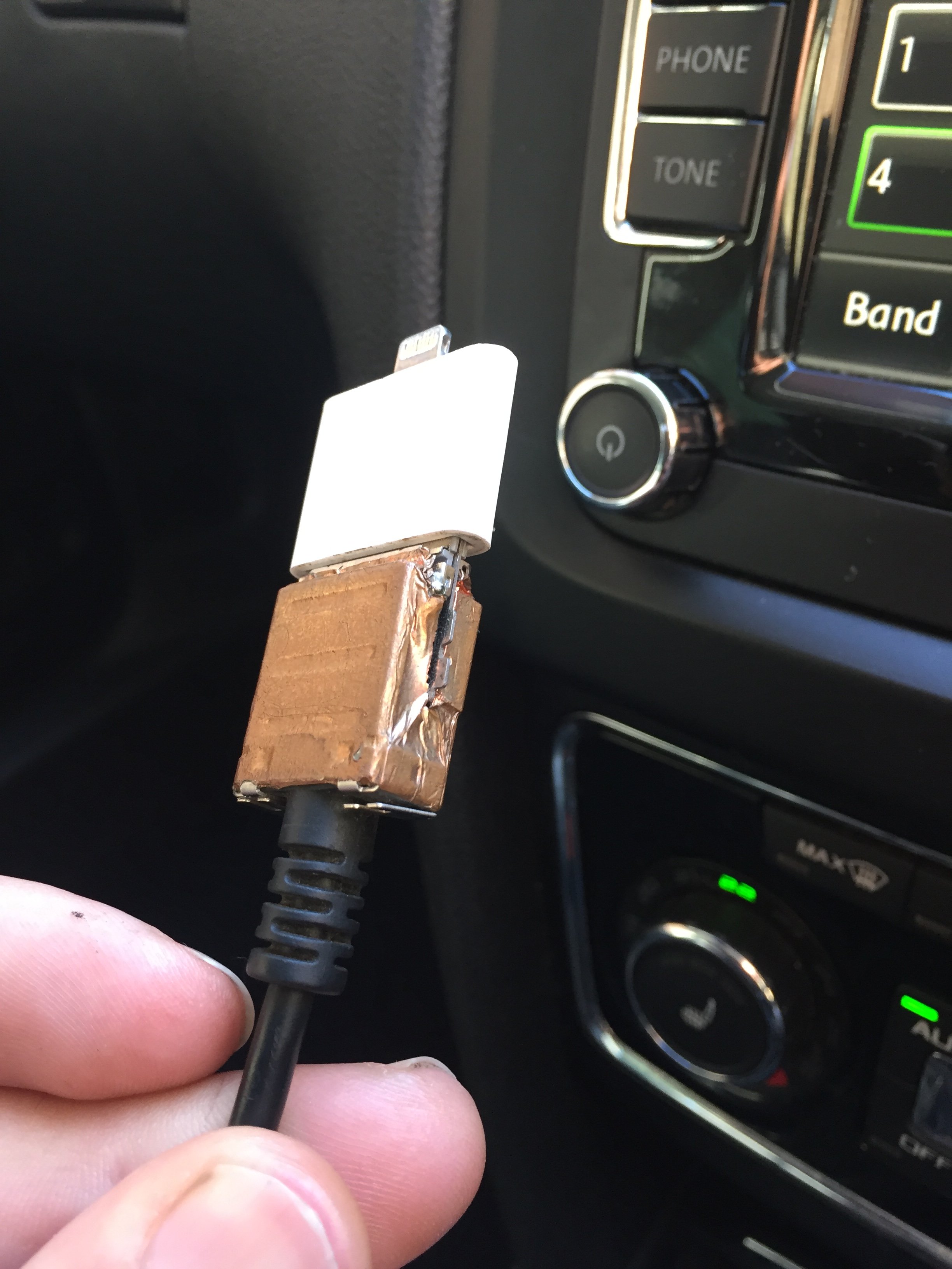

My owners manual says I should have a “dvi” plug in the glove box. All I have is a bodged cable that comes out the side with an iPhone lightning connector stuck on the end.

Are you sure the manual says DVI and not MDI? The plug in the glove box is what's known as an MDI (Multi Device Interface), and is factory fit. The short Lightning cable is one type of connection, and you can also buy a USB connector or an ipod connector cable. These plug into the MDI port in the glove box usually, and you currently have a Lightning cable plugged in. Press "Media" on the Columbus and you should have a little greyed out box on the top of the screen (next to cd, sd, hdd etc.) saying MDI. This will be active when something is connected onto the end of that cable.

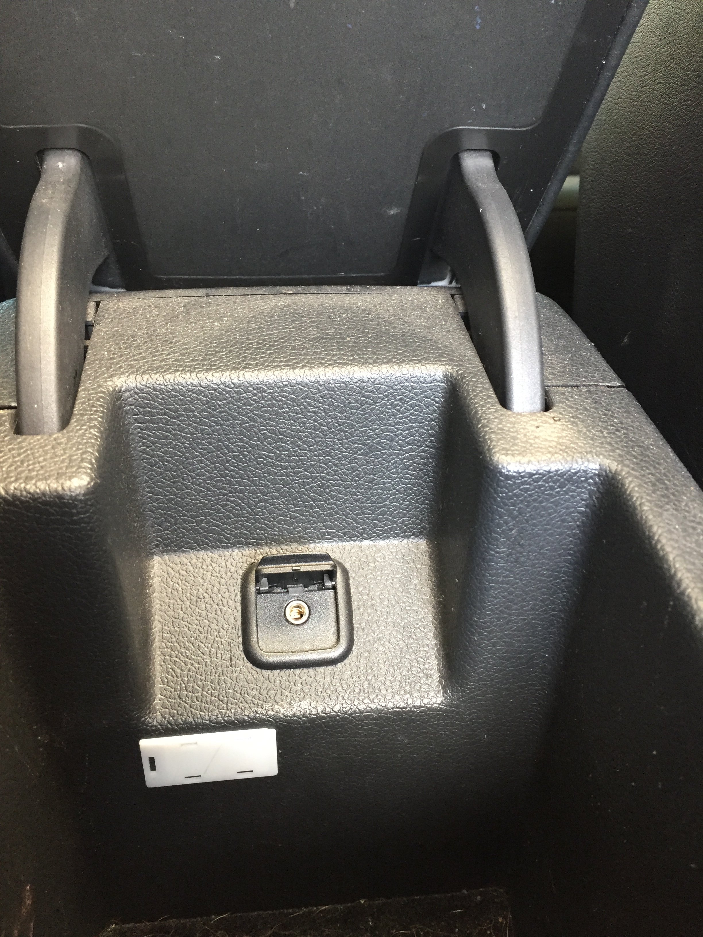

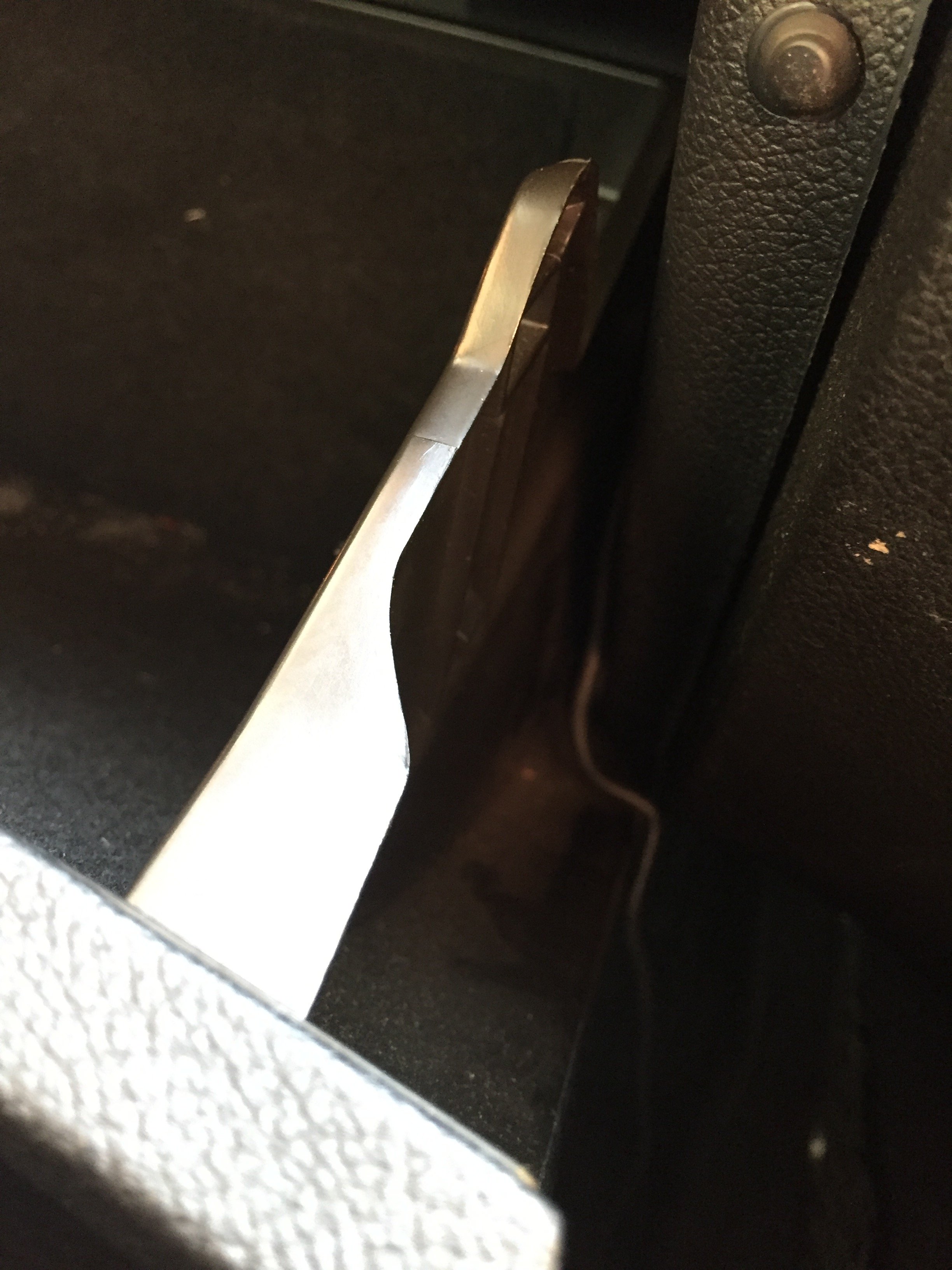

I can’t find a plug though, just this dodgy cable that comes out from behind the glove box. Picture attached. I’m assuming the mdi input would be in the armrest near the aux input?

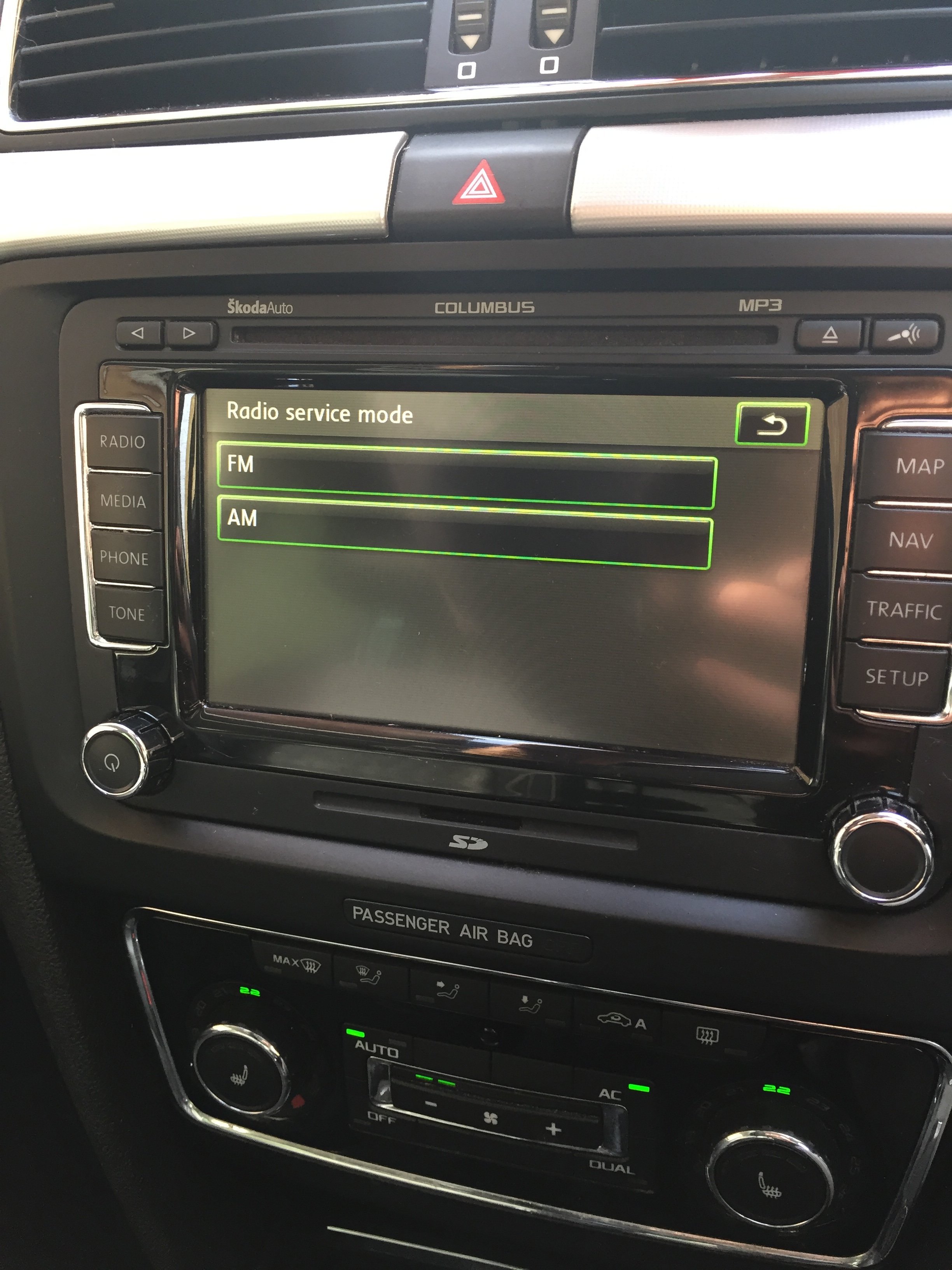

Also I have pictured where it should say my versions but there is no button for it :(

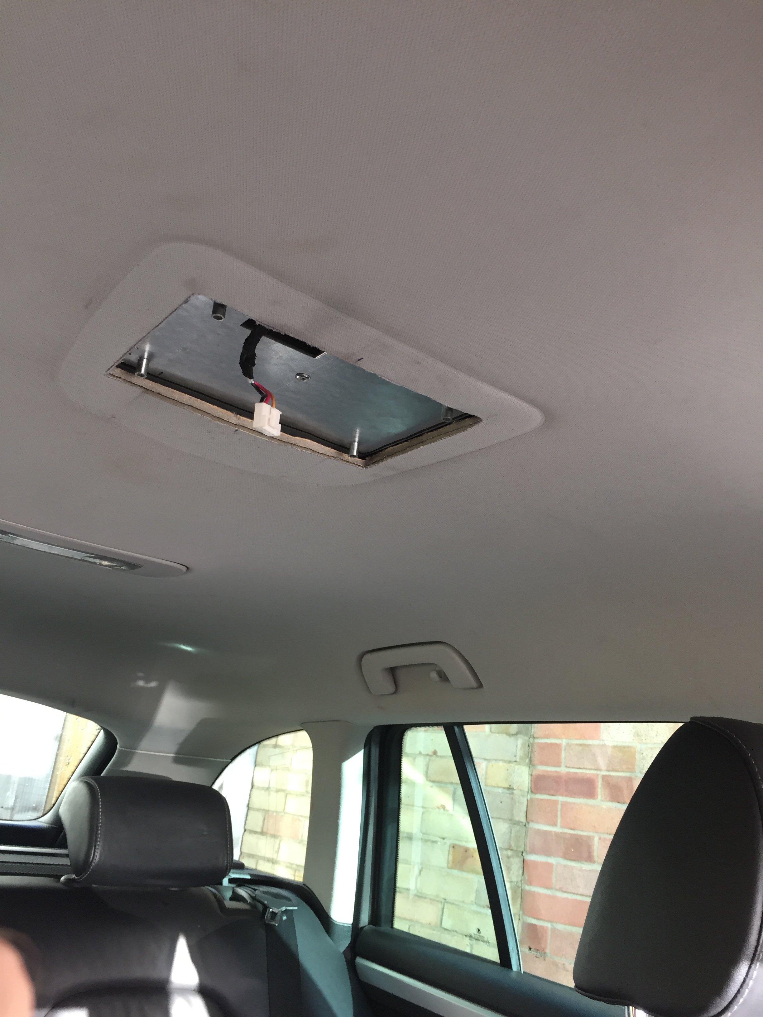

the other picture is where a factory fitted Rosen z8 was. The dvd drive is broken.
Looking for a replacement with a usb input I think!
What's on the other end of this cable though?
The MDI unit can be either behind the glove box or in the am rest.
It connects to a dension gateway 100
Then you don't have an MDI unit fitted. It's listed in the manual, but it would've been an option which wasn't ticked on your particular car, hence someone fitted what you have there.
