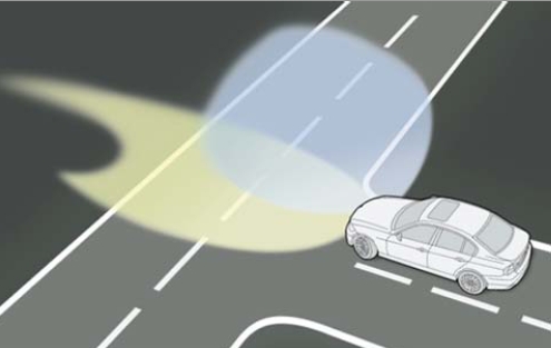

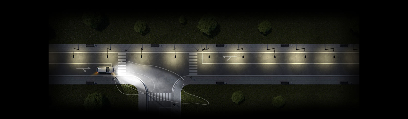

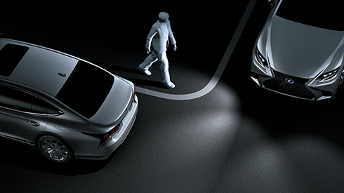

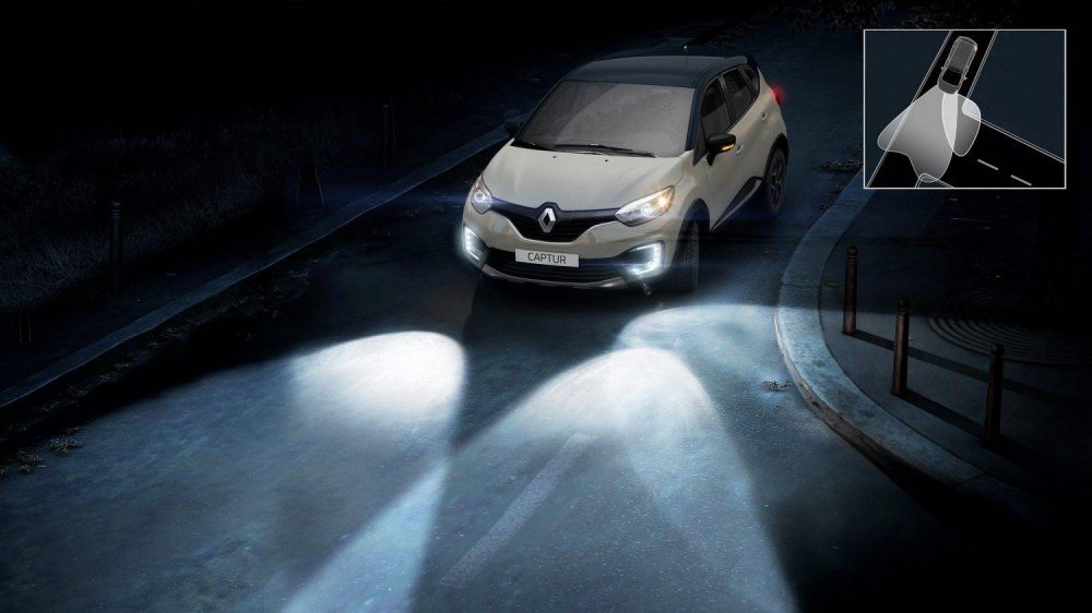

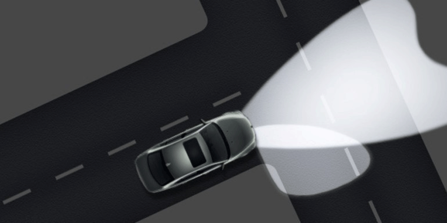

Both cornering lights coming on in reverse is to maximise visibility when at your most vulnerable to parking scrapes, i.e when reversing at night in unfamiliar surroundings. The cornering lights are good at illuminating low kerbs and bollards. Down narrow alleys they also reflect off the walls either side of the car making life a little easier.
You tend to either love 'em or hate 'em.
5a778c384d6c1_LEDcorneringlampsmultiweatherlights.jpg.a328fdd92def57dbf0eadf603abba5fb.jpg
Edited by silver1011
It'd be good if they worked like those pictures but they don't. I just can't see what they illuminate that the LED's don't already illuminate.
