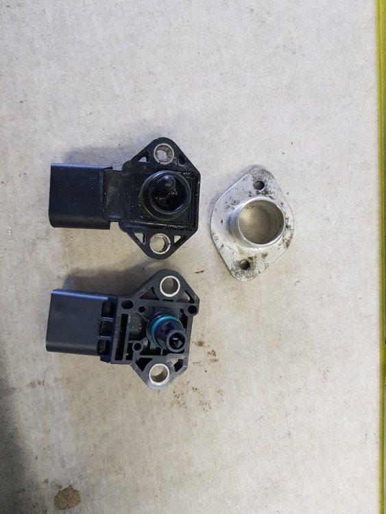

Ok, so my new map sensor arrived today, the supplier i bought from said Bosch had superceeded the part number and it would be the new one i would be sent out.
the middle part is a lot smaller and doesn't fit snugly into the adaptor plate, its from a Forge FMIC so i was a bit worried about that as it surely wont be sealed correctly.
i've had a quick look bit cant seem to find anything that would fit into this to allow for a smaller sensor.
regardless, i fitted it, cleared the fault codes from the car and ran it, now no codes showing and seems to be driving as it should again so i'm pretty happy with the end result.
