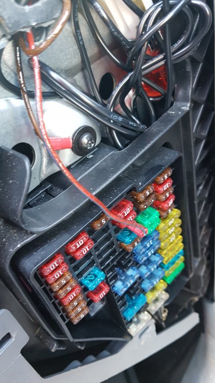

Anyone know where the grounding point is in the fuse box of a mk1 1.4 mpi. Trying to hard wire my dash cam. I found one screw but not sure if it's the one.

theres a black torx screw which mounts the fuse panel which you can use. just above main fuse board

Cheers, I wasn't sure that that wasn't aluminium it was screwed into. Is it the one in the pic?
Wouldn't matter if it was aluminium as it conducts electricity.
