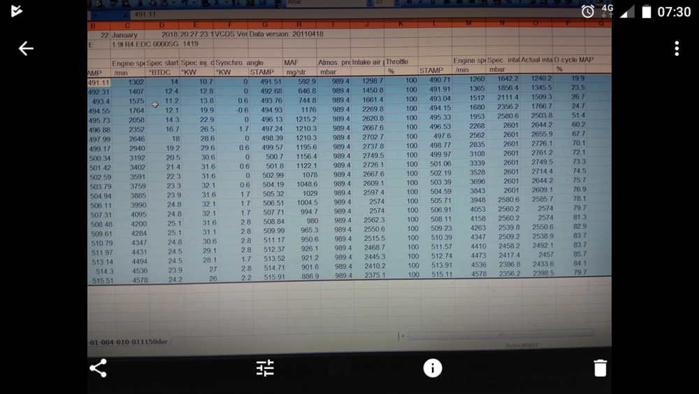

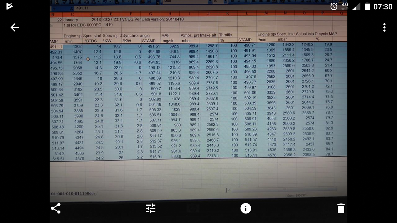

So could some of you help a man out and post up some logs of your maf and boost logs of your cars so I can get some ideas on how much air these things Chuck out so I can wright a base files to put on when I fit the turbo

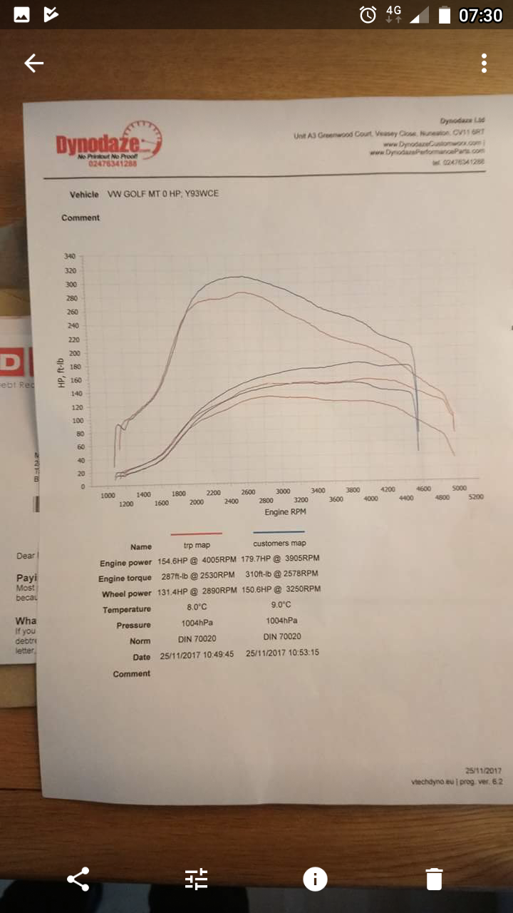

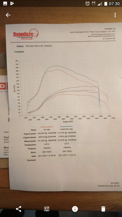

That's a Dyno off my old file Vs what I paid 250 for that did make 175bhp or not should I say
And a log of my new tune  for a VB turbo

Only thing is going in blind, I need a rough idear of maf readings so I can get a head start to what target boost to start with and fuel
