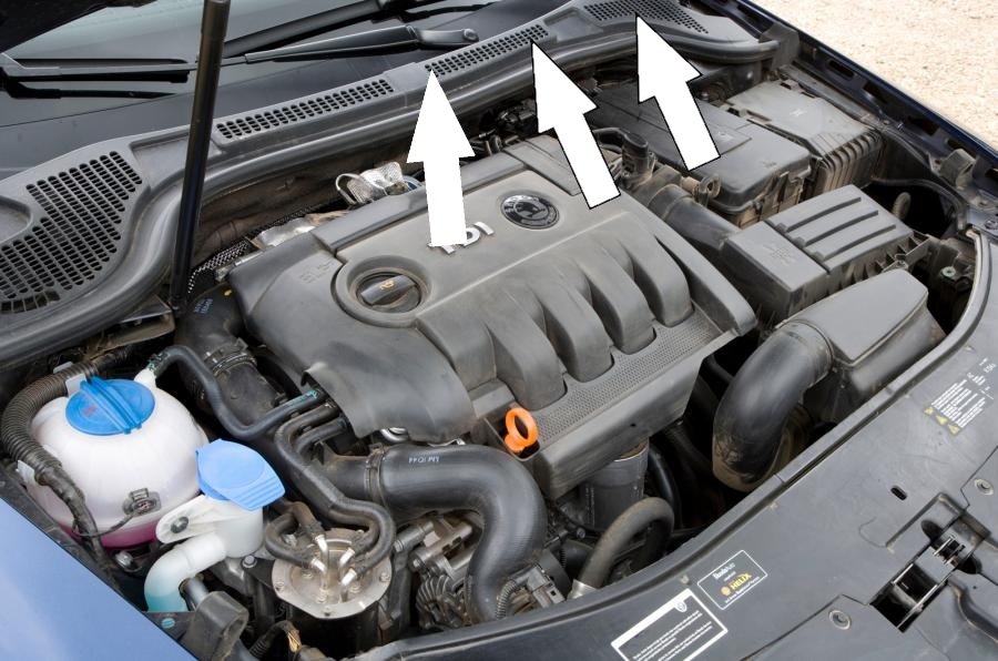

To remove the siren remove the cover the white arrows are pointing to.
Pull of the rubber seal at the front.
The panel is just pressed in at the window and has no screws. (note - mine had the wipers on the other half of the panel, yours may be different)
Once removed there will be another black cover for the siren. This is removed with 2 torx screws.
Then you see a bracket where the siren is mounted underneath.
Insert a 13mm spanner to the top of the siren and loosen and remove the nut.
Unplug the siren and plug in new one and refit everything in reverse of above.
