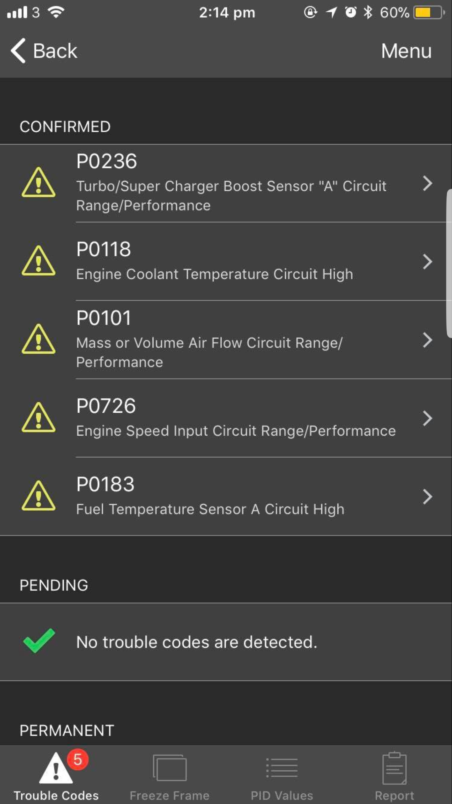

1.9 vrs whats the promblem?
I showed these codes to the garage and he said its because of the injectors
my car doesnt start it tries to and it used to start but used to have a rough start and rough idle then die after a few minutes and also if driven it would die and cut off
any one know if its just the sensors? connectors? wiring? or is it the injectors?
OK, so this looks like a problem with a ground or the wiring loom, it's definitely electrical and nothing to do with the injectors. You need an auto-electrician, a decent one.
could i just go to an skoda specialist ?
Yes, any VAG specialist should be able to fix it, just get it away from the idiot who thinks it's the injectors.
