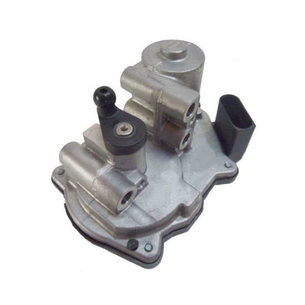

Swirl flap actuator has probably died. I’ve had to replace one on a mk2 Octavia in the past. Exactly same fault code.
Edited by Phillips
Is that separate from the intake manifold?
Yeah and no you can buy the manifold with the actuator or without, what engine is it just to confirm I’m not feeding you nonsense ha
CR170 is what I replaced it on.
Looks like this
id run the flap adaptation again and see if it actually moves during the process
Mines a 2.0 TSI.
They’ll still be an actuator that controls the flaps.

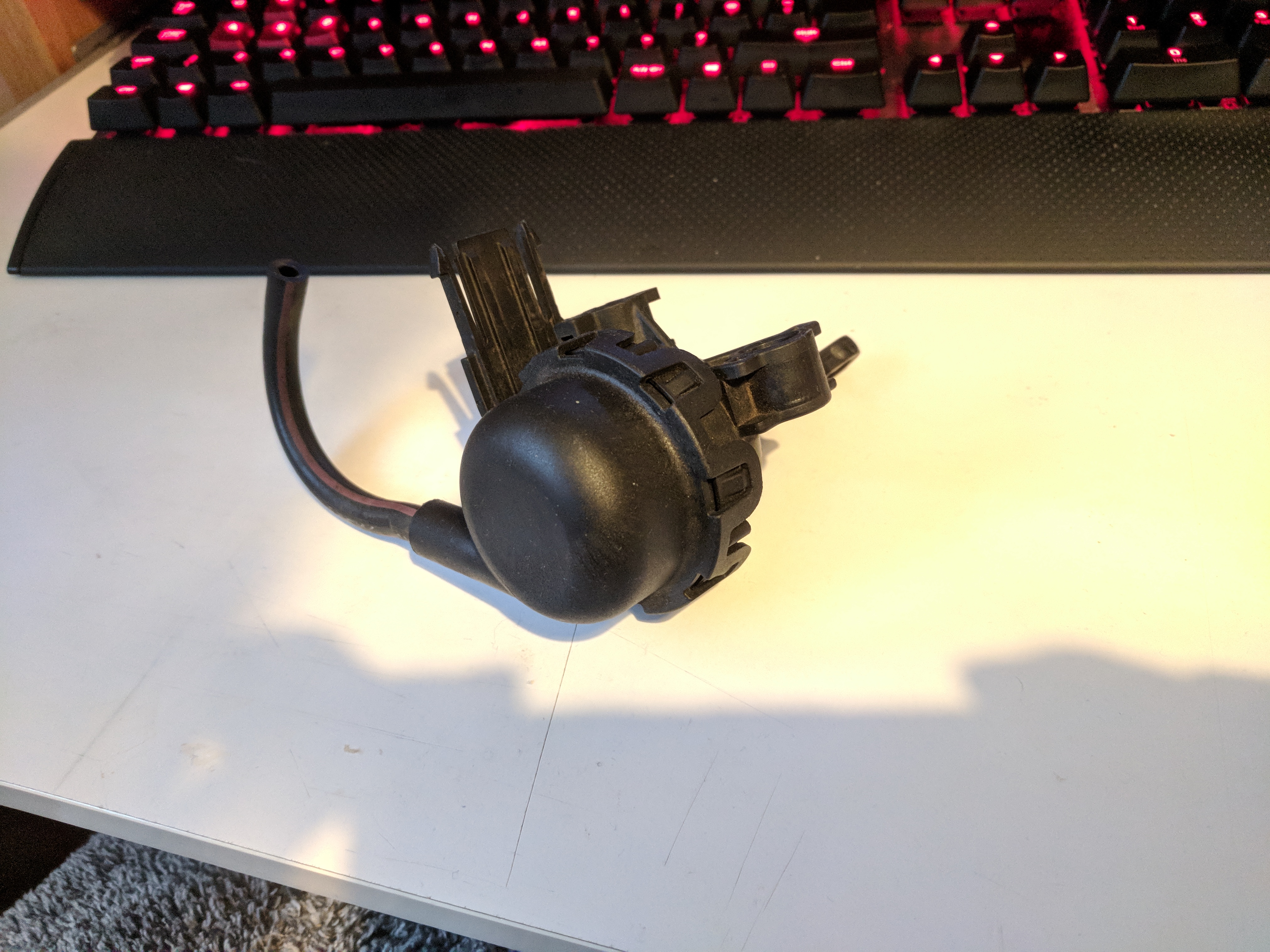

The swirl flap is vacuum driven on the TSI. I have one RJG.
I can send it your way if you like? Mine's used, about 60k old, and came off the car before I did the IM job so I cannot be sure that it's 100% working.  But better than buying a new one?
I may take you up on that mate.
